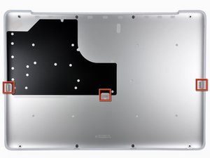

Remove the eight 4 mm Phillips screws securing the lower case to the MacBook.
Slightly lift the lower case near the vent opening.
Continue running your fingers between the lower and upper cases until the upper case pops off its retaining clips.

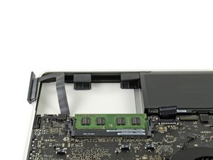

Use the flat end of a spudger to lift the battery connector up out of its socket on the logic board.
you do not need to remove the battery when replacing the hard drive or ram
Be careful of the corner of the battery cable connector when trying to pry it off with the spudge. I knocked the corner of mine. No operational impact but was not very pleasing!
Not necessary, but a good idea, so as to avoid any spurious charges going through the boards...
@Svenaustx - What could happen if not removing this battery? Worst case? Not a geek on this but did change RAM on my Macbook Pro "15. Can't remember disconneting the battery back then. Shouldn't it be sufficient shutting the Mac off and ensure it has been used for an hour or so before replacing RAM?

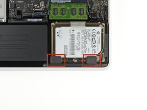

Remove two 11 mm Phillips screws securing the hard drive bracket to the upper case.
Lift the retaining bracket out of the upper case.
When putting the bracket back after replacing the drive, it is easy to put in backwards. If it doesn't seat smoothly, then reverse it and try again.

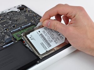

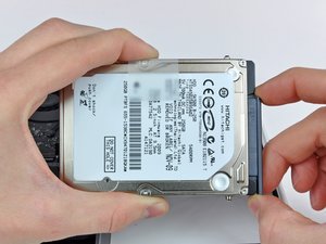

Lift the hard drive by its pull tab and pull it away from the upper case, minding the cable still attaching it to the logic board.

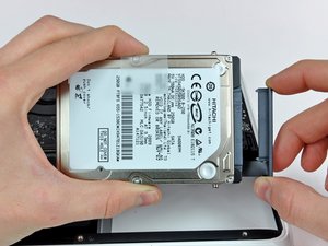

Remove the hard drive cable by pulling its connector straight away from the hard drive.
Remove the two T6 Torx screws from each side of the hard drive (four screws total).
