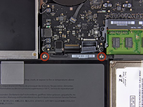

  4. MacBook Unibody Model A1342 Battery Replacement: step 4, image 1 of 1
    • Remove two 5 mm Tri-point screws securing the battery to the upper case.
