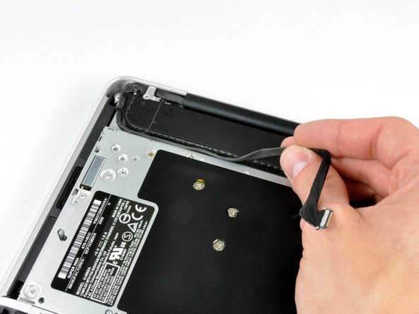

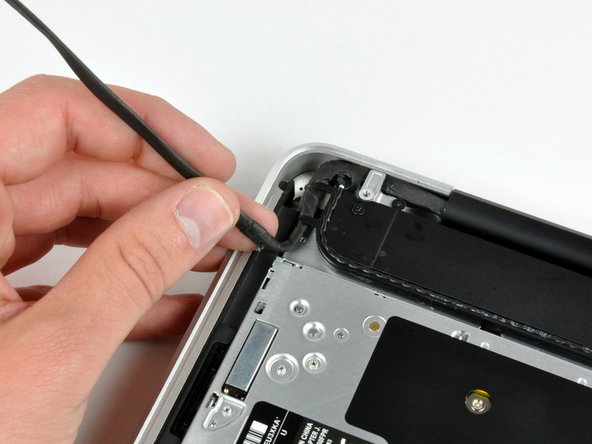

Image 1/2:
  • De-route the camera data cable from the channel in the optical drive.
Although I ordered the screen for an A1278 MacBook Unibody Aluminum, the screen glass was marked as a MacBook Pro. The iSight/WiFi /BT cable was about an inch longer than the Macbook one and took a bit of creative re-routing, but everything works fine.
tjod - Reply

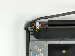

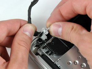

Image 1/2: One 9.9 mm partially threaded Phillips screw
  • Remove the following screws securing the camera data cable and right speaker to the upper case:
    • One 9.9 mm partially threaded Phillips screw
    • One 9.6 mm threaded Phillips screw
    • One 4 mm Phillips screw
  • Slide the camera cable bracket out from under the subwoofer and remove it from the computer.
  • The iSight cable has an eyelet through which passes the left-most screw in these pictures.
"orange" is the short one, that goes in the middle ;)
MrGreen - Reply
My model has different bracket, you need to remove the subwoofer first
Andrea Ghensi - Reply

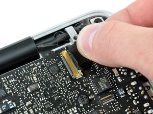

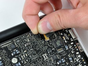

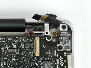

Image 1/2: Pull the display data cable connector straight away from its socket.
  • Grab the plastic pull tab secured to the display data cable lock and rotate it toward the DC-in side of the computer.
  • Pull the display data cable connector straight away from its socket.
  • Make sure to pull the connector straight away and not straight up from its socket.
i can't understand what I need to do in this step, I'm afraid with this step, i think i can "hurt" my mac and i don't want to do that, anyone knows what i need to do?
Thanks
Lucas Borges - Reply
There is a steel 'latch' that flips over from the left side of the connector, to the right side. After you flip this latch over, the cable will easily slide out.
madmaxmedia - Reply
as I pulled the monitor cable out of the bracket after flipping the lock over one side of the bracket broke loose. Now the monitor will not turn on. Can anyone help?
boldtu - Reply

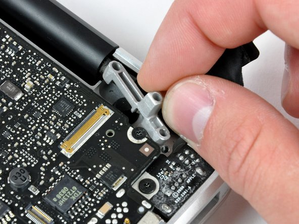

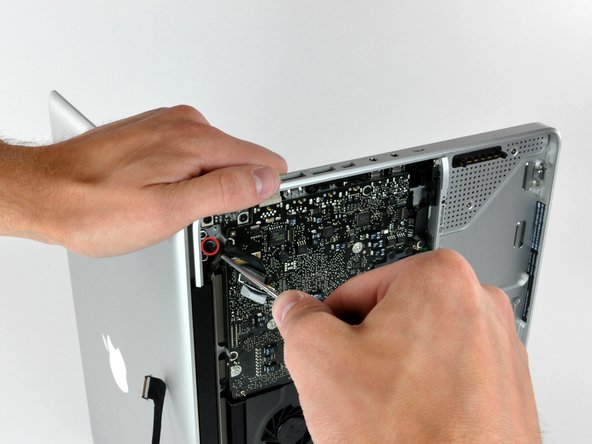

Image 1/2: One 7 mm Phillips screw.
  • Remove the following two screws from the display data cable bracket:
    • One 7 mm Phillips screw.
    • One 5 mm Phillips screw.
  • Lift the display data cable bracket out of the upper case.
Note for Step 10 during reassembly: Be careful when replacing the screw for the display cable bracket closest to the magnetic power cord receptacle. The interior magnet might attract the screw causing the screw to get pulled under the DC power circuit board which might then require that you disassemble things again to retrieve the screw.
wintermute - Reply

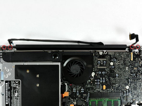

Image 1/1:
  • Remove the two outer 6 mm Torx screws securing each side of the display to the upper case (4 screws total).

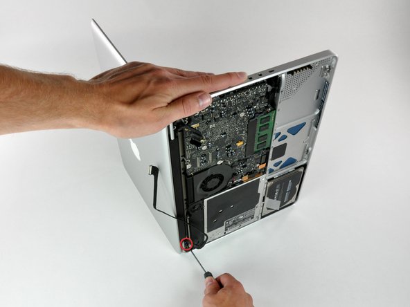

Image 1/1: Place your opened MacBook on a table as pictured.
  • Open your MacBook so the display is perpendicular to the upper case.
  • Place your opened MacBook on a table as pictured.
  • While holding the display and upper case together with your left hand, remove the 6 mm Torx screw from the lower display bracket.
Image 1/1: Remove the last remaining 6 mm Torx screw securing the display to the upper case.
  • Be sure to hold the display and upper case together with your left hand. Failure to do so may cause the freed display/upper case to fall, potentially damaging each component.
  • Remove the last remaining 6 mm Torx screw securing the display to the upper case.

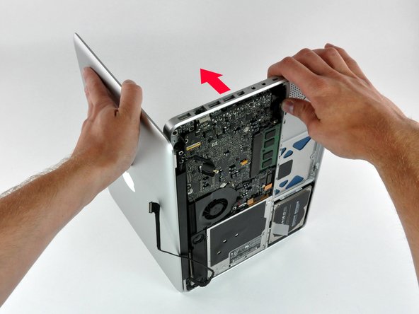

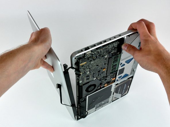

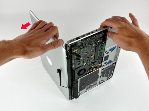

Image 1/3: Rotate the display slightly away from the upper case.
  • Grab the upper case with your right hand and rotate it slightly toward the top of the display so the upper display bracket clears the edge of the upper case.
  • Rotate the display slightly away from the upper case.
  • Lift the display away from the upper case, minding any brackets or cables that may get caught.

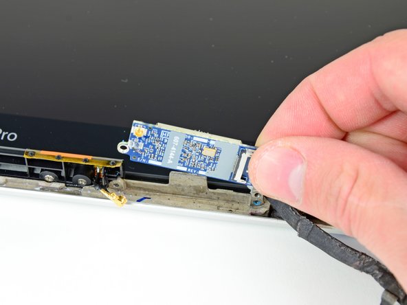

Image 1/1: When reattaching the AirPort Cable, make sure that the U-shaped notches on one side of the cable end are not visible (facing the card). If the cable is installed incorrectly, it will cause logic board damage.
  • Carefully pull the camera cable connector toward the right side of the display and out of its socket on the AirPort card.
  • When reattaching the AirPort Cable, make sure that the U-shaped notches on one side of the cable end are not visible (facing the card). If the cable is installed incorrectly, it will cause logic board damage.
I fried both of my Airport cards, couldn't figure out why, and came back here and read about these little U-shaped notches. I had to bring the computer into my office to compare both sides of this cable. I would be nice to make sure that this tid bit of information is very noticeable for those who are following along.
wcking - Reply
Yea, I fried two motherboards before I came back here and re-read that the U notches must face the airport card.
wcking -
