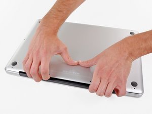

Image 1/2: Remove the lower case. Image 2/2: Remove the lower case.
  • Wedge your fingers between the lower case and the vent, and lift upward to release the clips holding the lower case to the upper case.
  • Remove the lower case.
I recommend using anti-static protection, i.e., wearing a ground strap, or at least touch metal chassis inside the computer before unplugging cables. Otherwise, you might create an ESD discharge into your RAM and have to replace it like I did!
d68ef792 - Reply

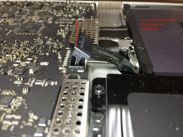

Image 1/3: If present, grab the plastic tab attached to the battery connector and pull it toward the front edge of the device.  For Late-2011 models the battery connector will not have a tab and is simply a plug that inserts straight down into the motherboard--to remove pry the plug straight up. Image 2/3: If the plastic tab is missing, use a spudger to pry the connector up from its socket. Image 3/3: Pull the tab parallel to the face of the logic board.
  • Whenever working near the logic board, it is always wise to first disconnect the battery to avoid short circuits.
  • If present, grab the plastic tab attached to the battery connector and pull it toward the front edge of the device. For Late-2011 models the battery connector will not have a tab and is simply a plug that inserts straight down into the motherboard--to remove pry the plug straight up.
  • If the plastic tab is missing, use a spudger to pry the connector up from its socket.
  • Pull the tab parallel to the face of the logic board.
This step is a little difficult in reverse, that is, when re-attaching the battery. It helps to tilt the laptop up so you can see the edge of the board that accepts the plug. It may look like there are two slots for it, it goes in the bigger slot that is further away from the board.

* There is no tab on the A1297 (late 2011) model's battery connector. Be careful with the connector, it chips off the edges easily! Otherwise the same as bhodges2 & Stephen's notes.

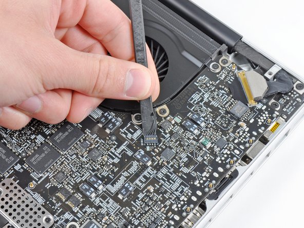

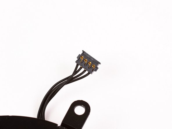

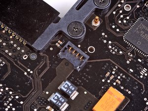

Image 1/3: It is useful to twist the spudger axially from beneath the fan cable wires to release the connector. Image 2/3: The fan socket and the fan connector can be seen in the second and third pictures. Be careful not to break the plastic fan socket off the logic board as you use your spudger to lift the fan connector straight up and out of its socket. The layout of the logic board shown in the second picture may look slightly different than your machine but the fan socket is the same. Image 3/3: The fan socket and the fan connector can be seen in the second and third pictures. Be careful not to break the plastic fan socket off the logic board as you use your spudger to lift the fan connector straight up and out of its socket. The layout of the logic board shown in the second picture may look slightly different than your machine but the fan socket is the same.
  • Use the flat end of a spudger to lift the right fan connector out of its socket on the logic board.
  • It is useful to twist the spudger axially from beneath the fan cable wires to release the connector.
  • The fan socket and the fan connector can be seen in the second and third pictures. Be careful not to break the plastic fan socket off the logic board as you use your spudger to lift the fan connector straight up and out of its socket. The layout of the logic board shown in the second picture may look slightly different than your machine but the fan socket is the same.
Needs a better photo to show how the plug is able to come off the socket vertically. In particular, the underside of the plug should be shown.
Alexander Atkins - Reply

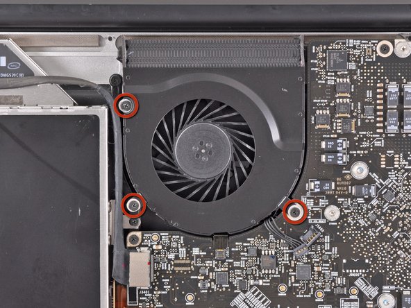

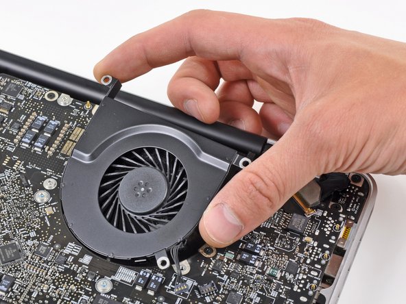

Image 1/1: In the Late 2011 MacBook Pro 17" Unibody these screws will be T6 Torx.
  • Remove the three 3.1 mm Phillips screws securing the right fan to the logic board.
  • In the Late 2011 MacBook Pro 17" Unibody these screws will be T6 Torx.
The fan fixing screws on my 17-inch, Mid 2010 MacBook Pro were Torx 6, not Philips 00.
Michael - Reply
... And the fan fixing screws on my 2009 MBP were *smaller* that the size implied by the tool requirements for this project. I initially tried a Phillips 00 screwdriver but it nearly stripped the screw head. It was necessary to switch to a Phillips 000 bit to actually get two of the screws to move.
rpwl -

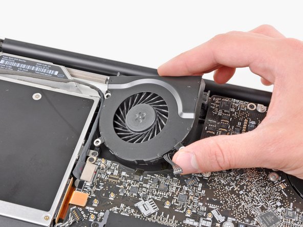

  • Remove the right fan from the upper case, minding its cable that may get caught.

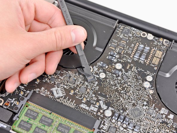

Image 1/1: It is useful to twist the spudger axially from beneath the fan cable wires to release the connector.
  • Use the flat end of a spudger to lift the left fan connector out of its socket on the logic board.
Image 1/2: Remove the left fan from the upper case, minding its cable that may get caught. Image 2/2: Remove the left fan from the upper case, minding its cable that may get caught.
  • Remove the three 3.1 mm Phillips screws securing the left fan to the logic board.
  • Remove the left fan from the upper case, minding its cable that may get caught.

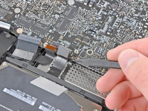

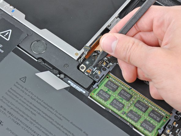

Image 1/1: Use the tip of a spudger to push the small plastic cable retainer away from the camera cable socket for enough clearance to remove the camera cable.
  • Before disconnecting the camera cable, a small plastic retainer stuck to the logic board must first be moved out of the way.
  • Use the tip of a spudger to push the small plastic cable retainer away from the camera cable socket for enough clearance to remove the camera cable.

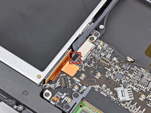

Image 1/1: The camera cable socket is very fragile. Do not apply any upward force to this socket, as it may break off the logic board. Pull the camera cable parallel to the face of the logic board.
  • Pull the camera cable toward the optical drive opening to disconnect it from the logic board.
  • The camera cable socket is very fragile. Do not apply any upward force to this socket, as it may break off the logic board. Pull the camera cable parallel to the face of the logic board.

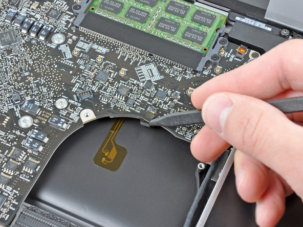

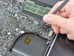

Image 1/1: Pry up from beneath the wires.
  • Use the flat end of a spudger to lift the subwoofer & right speaker connector out of its socket on the logic board.
  • Pry up from beneath the wires.

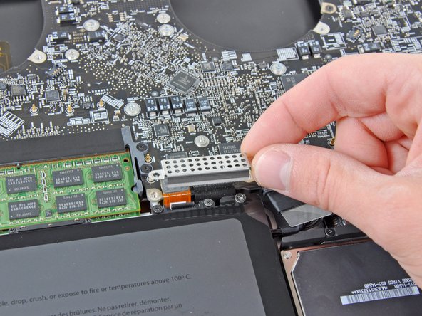

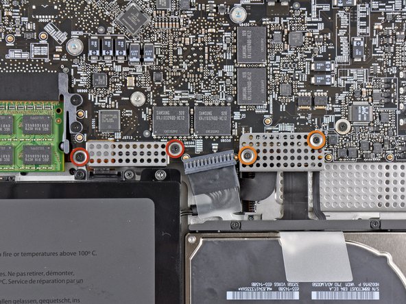

Image 1/3: Two 3.5 mm Phillips screws Image 2/3: Two 1.6 mm Phillips screws Image 3/3: Remove both connector shields from the logic board.
  • Remove the following four screws:
    • Two 3.5 mm Phillips screws
    • Two 1.6 mm Phillips screws
  • Remove both connector shields from the logic board.

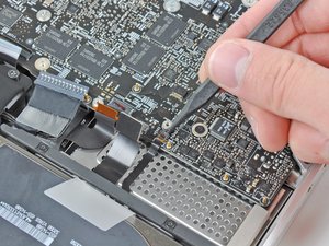

Image 1/1:
  • Use the flat end of a spudger to pry the trackpad connector up and out of its socket on the logic board.

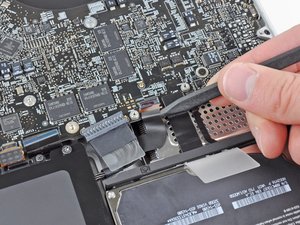

Image 1/2: Be sure you are prying up on the retaining flap, '''not''' the socket itself. Image 2/2: Pull the express card cage ribbon cable out of its socket.
  • Use your fingernail to flip up the retaining flap on the express card cage ribbon cable socket.
  • Be sure you are prying up on the retaining flap, not the socket itself.
  • Pull the express card cage ribbon cable out of its socket.
It might be easier to remove the ExpressCard ribbon cable in Step 18 by removing the Hard Drive cable first...use your judgment.
David DeAnda - Reply

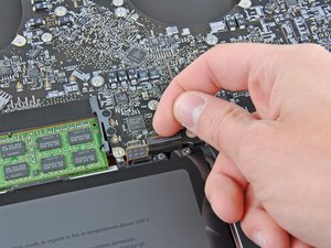

Image 1/1:

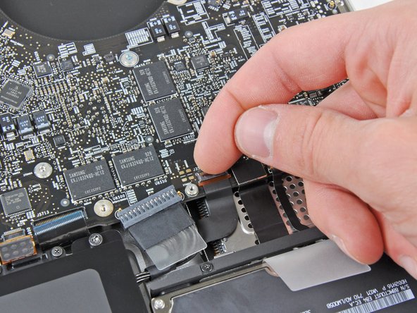

  • Use the flat end of a spudger to lift the hard drive cable connector up and out of its socket on the logic board.

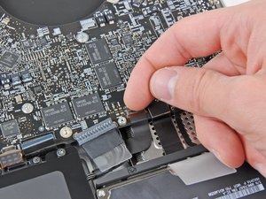

Image 1/2: Be sure you are prying up on the retaining flap, '''not''' the socket itself. Image 2/2: Pull the battery indicator ribbon cable out of its socket.
  • Use the tip of a spudger or your fingernail to flip up the retaining flap on the battery indicator cable socket.
  • Pull the battery indicator ribbon cable out of its socket.

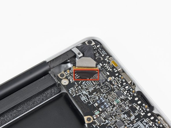

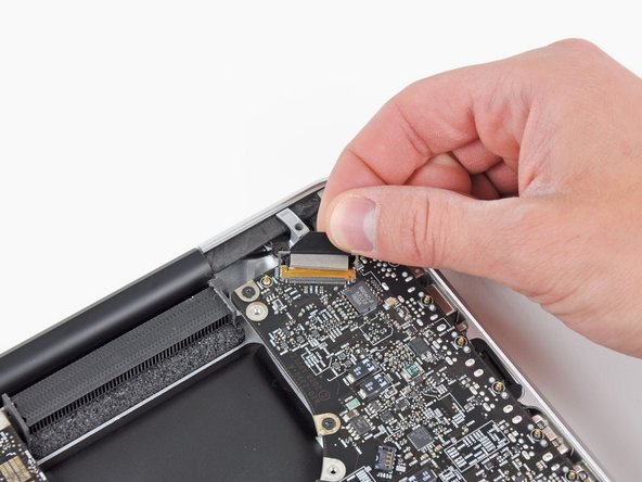

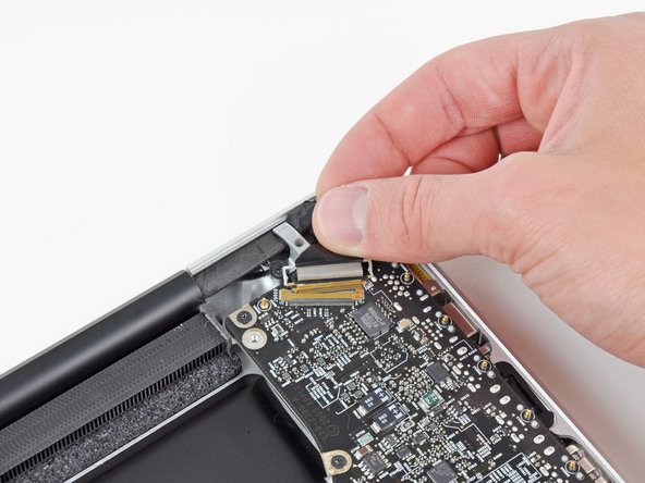

Image 1/3: Pull the display data cable out of its socket. Image 2/3: The display data cable socket is very fragile. '''Do not''' lift the connector upward as you disconnect it, as the socket may break off the logic board. Pull the cable parallel to the face of the logic board. Image 3/3: The display data cable socket is very fragile. '''Do not''' lift the connector upward as you disconnect it, as the socket may break off the logic board. Pull the cable parallel to the face of the logic board.
  • Lift the black plastic flap attached to the display data cable retainer and rotate it toward the DC-In side of the MacBook.
  • Pull the display data cable out of its socket.
  • The display data cable socket is very fragile. Do not lift the connector upward as you disconnect it, as the socket may break off the logic board. Pull the cable parallel to the face of the logic board.

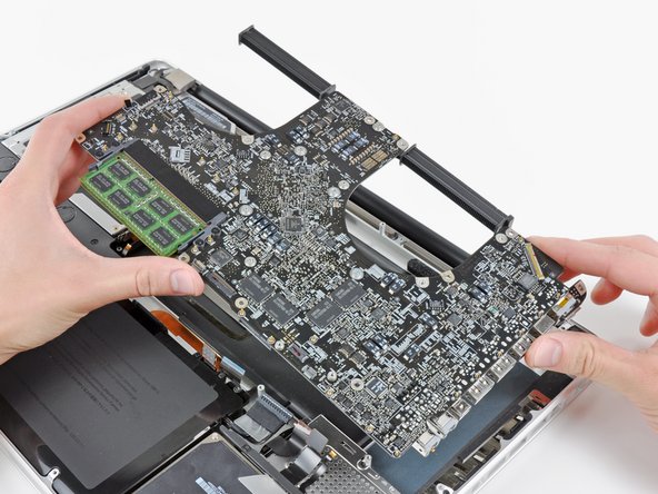

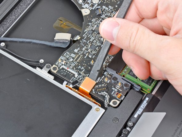

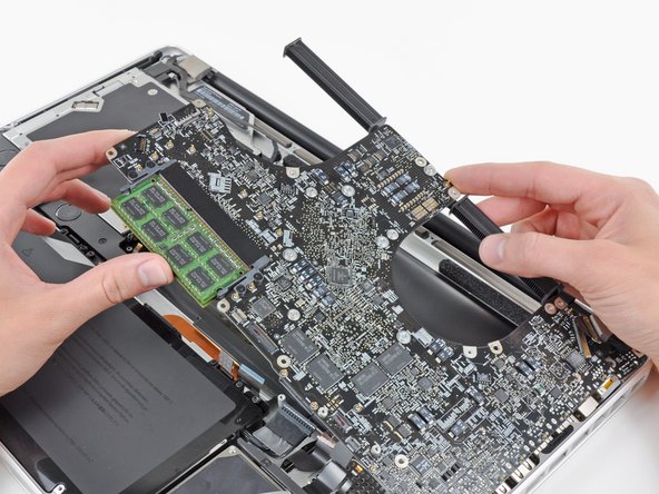

Image 1/2: Lift the logic board assembly from the side nearest the optical drive and lift it away from the upper case. Image 2/2: Note that you'll be removing the logic board and DC-in board together.
  • Handle the logic board assembly by its edges only.
  • Lift the logic board assembly from the side nearest the optical drive and lift it away from the upper case.
    • Note that you'll be removing the logic board and DC-in board together.
  • Carefully pull the ports and DC-In board away from the side of the upper case and remove the logic board assembly, minding any cables that may get caught.
Beware of the CCFL-connector (verify?) that is still in place on the other side of the logic board! You'll notice, though - just be aware of it. If you gently flip over the logic board (as if it where to 'hinge' over the point where it's still connected), you can put it aside upside-down and remove the connector with a spudger (in general I recommend against fingernails as they deprive your view).
LeonSteyns - Reply

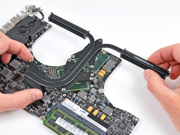

Image 1/1: If the heat sink appears to be stuck to the logic board after removing all eight screws, it may be helpful to use a spudger to separate the two components.
  • Remove the heat sink from the logic board.
  • If the heat sink appears to be stuck to the logic board after removing all eight screws, it may be helpful to use a spudger to separate the two components.
  • If you need to mount the heat sink back onto the logic board, we have a thermal paste guide that makes replacing the thermal compound easy.

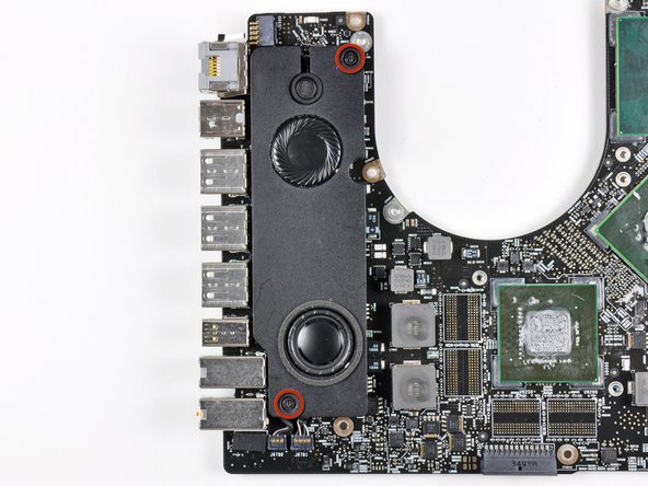

Image 1/1:

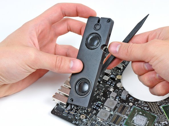

  • Remove the two 7.9 mm Phillips screws securing the left speaker to the logic board.

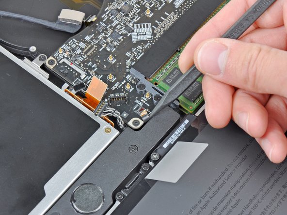

Image 1/2: Use the flat end of a spudger to lift the left speaker and microphone connectors out of their sockets on the logic board. Image 2/2: Use the flat end of a spudger to lift the left speaker and microphone connectors out of their sockets on the logic board.
  • Slightly lift the left speaker assembly away from the logic board.
  • Use the flat end of a spudger to lift the left speaker and microphone connectors out of their sockets on the logic board.

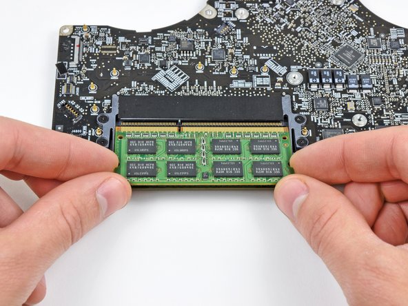

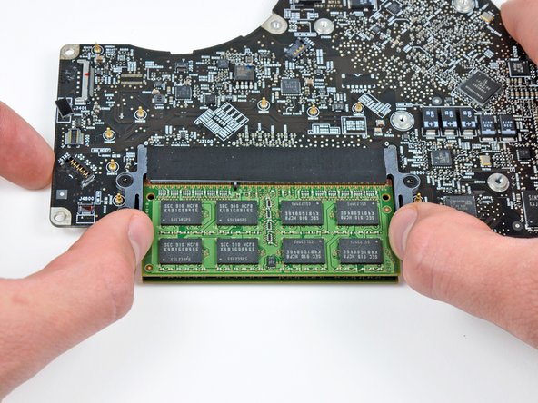

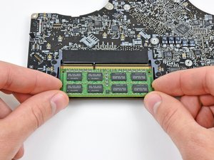

Image 1/2: These tabs lock the chip in place and releasing them will cause the chip to "pop" up. Image 2/2: After the RAM chip has popped up, pull it straight out of its socket.
  • Release the tabs on each side of the RAM chip by simultaneously pushing each tab away from the RAM.
  • These tabs lock the chip in place and releasing them will cause the chip to "pop" up.
  • After the RAM chip has popped up, pull it straight out of its socket.
  • Repeat this process if a second RAM chip is installed.
  • Logic board remains.
