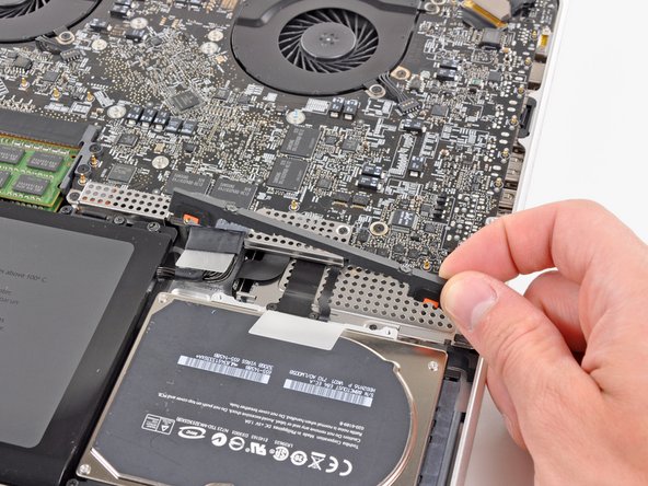

Image 1/3: If present, grab the plastic tab attached to the battery connector and pull it toward the front edge of the device.  For Late-2011 models the battery connector will not have a tab and is simply a plug that inserts straight down into the motherboard--to remove pry the plug straight up. Image 2/3: If the plastic tab is missing, use a spudger to pry the connector up from its socket. Image 3/3: Pull the tab parallel to the face of the logic board.
  • Whenever working near the logic board, it is always wise to first disconnect the battery to avoid short circuits.
  • If present, grab the plastic tab attached to the battery connector and pull it toward the front edge of the device. For Late-2011 models the battery connector will not have a tab and is simply a plug that inserts straight down into the motherboard--to remove pry the plug straight up.
  • If the plastic tab is missing, use a spudger to pry the connector up from its socket.
  • Pull the tab parallel to the face of the logic board.
This step is a little difficult in reverse, that is, when re-attaching the battery. It helps to tilt the laptop up so you can see the edge of the board that accepts the plug. It may look like there are two slots for it, it goes in the bigger slot that is further away from the board.
yary hluchan - Reply
Is this step really necessary? It is not part of the instructions how to replace the HDD in Apple's User Manual of the 2011 17" MBP.
Tobias Hahn - Reply
As it says in the step: "Whenever working near the logic board, it is always wise to first disconnect the battery to avoid short circuits." It is not required, but it is simple insurance to avoid a $1000+ repair should you accidentally short components on the board with something metal.
Andrew Bookholt -
There was no tab on my model. Battery is affixed to board and screws must be removed.
bhodges2 - Reply
Mine also, and looks as if removing connector could damage motherboard.
Stephen -
* There is no tab on the A1297 (late 2011) model's battery connector. Be careful with the connector, it chips off the edges easily! Otherwise the same as bhodges2 & Stephen's notes.
** (Pleas also include the exact Model and Part numbers like P/N: MD311D/A; Mod.: A1297 in the comments and notes for your MBP)
Pinguman - Reply
Why are there no guides for the Late 2011 17" MacBook Pro A1297 (2.4GHz i7 quad core, MD311LL/A)??? I just replaced the RAM in mine and discovered that not only is there no tab on the battery connector, but the connector pulls straight up, perpendicular to the logic board, rather than parallel. I almost ripped the wires out of the connector by trying to pull it out parallel to the logic board like this guide instructed! After finally getting it out, my advice to those with the Late 2011 model is to use a spudger to loosen the edges of the connector then lift the connector straight up to get it out safely.
Dave - Reply

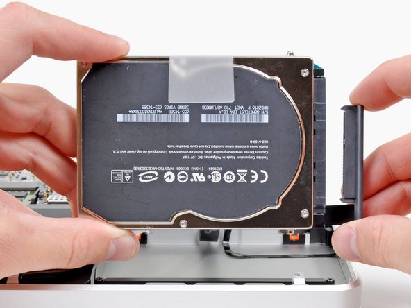

Image 1/1: Don't try to completely remove the hard drive just yet! Its cable is still connected.
  • Use the hard drive's pull tab to lift it out of the upper case.
  • Don't try to completely remove the hard drive just yet! Its cable is still connected.

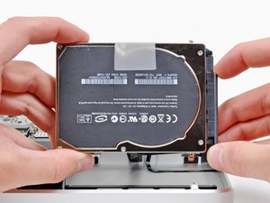

Image 1/2: Remove the hard drive from your MacBook Pro. Image 2/2: Remove the hard drive from your MacBook Pro.
  • Pull the hard drive connector away from the body of the hard drive.
  • Remove the hard drive from your MacBook Pro.

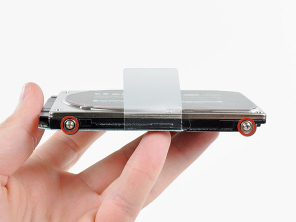

Image 1/2: If desired, peel off the plastic pull tab and transfer it to your new hard drive. Image 2/2: If you are installing a new hard drive, we have an [guide|751|OS X install guide] to get you up and running.
  • Remove the four T6 Torx screws around the outer edge of the hard drive.
  • If desired, peel off the plastic pull tab and transfer it to your new hard drive.
  • If you are installing a new hard drive, we have an OS X install guide to get you up and running.
You need to put the four screws into your new hard drive, then follow all steps in reverse.
