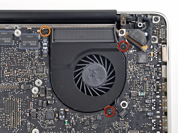

Image 1/1: Two 3.5 mm T6 Torx screws.
  • Remove the following three screws securing the left fan to the logic board:
    • Two 3.5 mm T6 Torx screws.
    • One 4.2 mm T6 Torx screw.

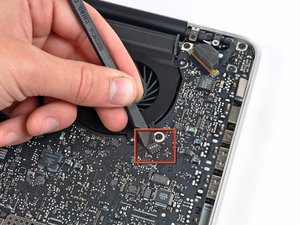

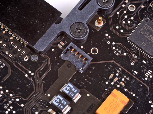

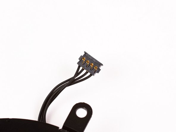

Image 1/3: It is useful to twist the spudger axially from beneath the fan cable wires to release the connector.
  • Use the flat end of a spudger to disconnect the left fan connector from the logic board.
  • It is useful to twist the spudger axially from beneath the fan cable wires to release the connector.
  • The fan socket and the fan connector can be seen in the second and third pictures. Be careful not to break the plastic fan socket off the logic board as you use your spudger to lift the fan connector straight up and out of its socket.
    • The layout of the logic board shown in the second picture may look slightly different than your machine but the fan socket is the same.
Mine had all three screws the same length (3.5 mm I believe)
Rusty Simmons - Reply

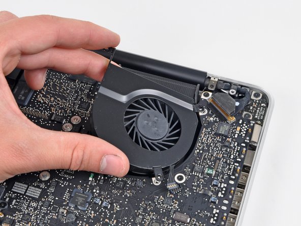

Image 1/1:
  • Lift the left fan out of the upper case.

Managed to break off a fan connector. Really poor mistake there, as it really is not too hard. Follow exactly like the picture and realize that it lifts up! But good news, I managed to break one of the least important parts and the computer still runs fine!
Sam - Reply

This is the hardest step IMO
brbulic - Reply
Indeed this s the hardest step.its not clear from the instruction that there are two elements to this component. The connector and also a metal retaining clip that needs to be rotated off the connector first.
mail - Reply
this was the hardest part of the dismantling for me. it's not super obvious in the pictures that there is a hinge and the metal piece, attached with tape, swings over and towards the DC-in.
shmianco - Reply
I found it easiest to grab the connector where the hinged metal piece connected to the body.
Replacing this connector was a bit fiddly, as you have to make sure it's lined up exactly before pushing it in, and because pushing it in requires a bit of force.
Kyle - Reply
Image 1/2: Be sure you are flipping up the hinged retaining flap, '''not''' the socket itself.
  • Use the tip of a spudger to flip up the retaining flap on the keyboard backlight ribbon cable ZIF socket.
  • Be sure you are flipping up the hinged retaining flap, not the socket itself.
  • Pull the keyboard backlight ribbon cable out of its socket.
Image 1/1: Seven 3.4 mm ( 3.1 mm) T6 Torx screws on the logic board
  • Remove the following nine screws:
    • Seven 3.4 mm ( 3.1 mm) T6 Torx screws on the logic board
    • Two 8 mm T6 Torx screws on the DC-In board
Image 1/3: If necessary, use the flat end of a spudger to separate the microphone from the upper case.
  • Carefully lift the logic board assembly from its left side and work it out of the upper case, minding the optical drive cable and the I/O ports that may get caught during removal.
  • If necessary, use the flat end of a spudger to separate the microphone from the upper case.
  • Pull the I/O port side of the logic board away from the side of the upper case and remove the logic board assembly.
I had a little difficulty pulling the motherboard before the battery. I'm not sure why you would want to do it in the order listed here, but doing steps 23 and 24 first helped the board come out easier.
maccentric - Reply
The thing that caught me on this step was that, at least on mine, the speaker box was glued/taped to the case, and so I got rather nervous trying to remove the logic board as it wouldn't move until said adhesive was pried apart. Thank goodness I knew the difference between the sounds of "board breaking" and "adhesive separating", but this step was still rather harrowing for me.
Joseph Sikorski - Reply
The microphone cable was easy to pry off the logic board for disassembly. For re-assembly, I was having a heck of a time getting the connector to connect to the logic board. There just isn't enough room to get your hands and tools in there and still see what you're doing (unless you're a dentist and you're used to that kind of thing). Anyway, I finally got brave and pulled the round, rubberized microphone from the case. I connected the short cable to the logic board, set the microphone in the made-for-the-microphone housing on the logic board, hoping it would stick itself back to the case once the logic board was in position, and I was back in business. In this case, simply stating "reverse these steps for reassembly" wasn't very forthcoming.
robk64 - Reply
When I did this step the microphone was REALLY STUCK to the upper case, it actually stayed stuck to it and disconnect "itself" from the mother board while I was lifting up everything.
Finally, there was no damage : I separated the microphone from the upper case while reassembling, then connected it back to the mother board and put it on its housing.
Greg - Reply
