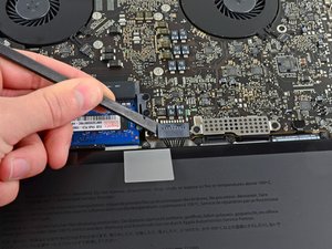

Edit Step 3 Battery Connector  ¶
  • For certain repairs (e.g. hard drive), disconnecting the battery connector is not necessary but it prevents any accidental shorting of electronics on the motherboard. If you do not disconnect the battery connector, please be careful as parts of the motherboard might be electrified.
  • Use the edge of a spudger to pry the battery connector upwards from its socket on the logic board.
  • It is useful to pry upward on both short sides of the connector to "walk" it out of its socket.
Image #1
Edit Step 4  ¶
  • Bend the battery cable slightly away from its socket on the logic board so it does not accidentally connect itself while you work.

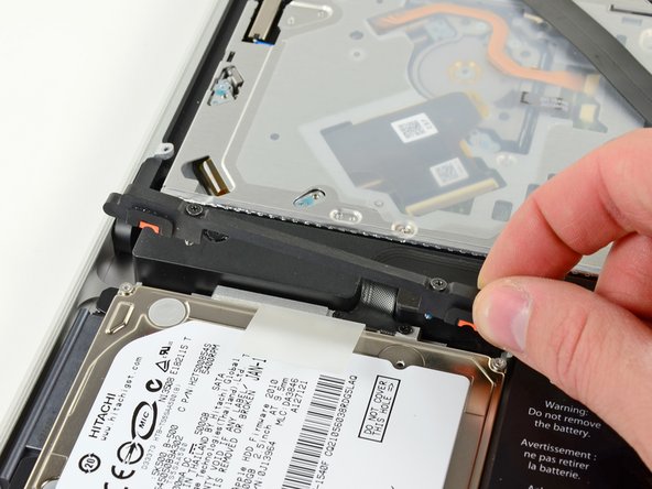

Edit Step 5 Hard Drive  ¶
  • Remove two Phillips screws securing the hard drive bracket to the upper case.
  • These screws are captive to the hard drive bracket.
Image #1
Edit Step 6  ¶
  • Lift the the retaining bracket out of the upper case.

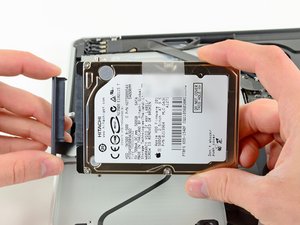

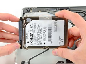

Edit Step 7  ¶
  • Lift the hard drive by its pull tab and pull it out of the chassis, minding the cable attaching it to the computer.
Image #1
Edit Step 8  ¶
  • Remove the hard drive cable by pulling its connector straight away from the hard drive.
Image #1

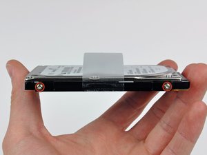

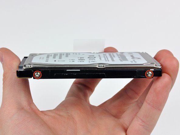

Edit Step 9 Hard Drive  ¶
  • Remove two T6 Torx screws from each side of the hard drive (four screws total).
  • You'll need to transfer these screws to your new hard drive if you're changing drives.
  • If desired, peel the pull tab off your old hard drive and transfer it to the side of your new drive.
  • If you are installing a new hard drive, we have an OS X install guide to get you up and running.
