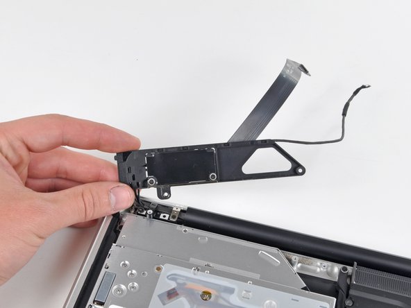

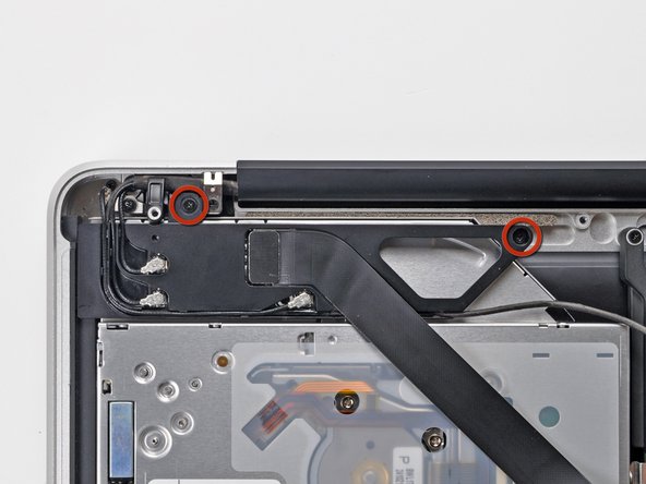

Image 1/2: Carefully rotate the AirPort/Bluetooth board housing (with AirPort/Antenna cables still attached) out of the lower case.
3 Edit Step 10  ¶
  • Remove the two Phillips screws securing the AirPort/Bluetooth board housing.
  • Carefully rotate the AirPort/Bluetooth board housing (with AirPort/Antenna cables still attached) out of the lower case.

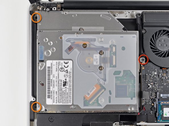

Image 1/1: One 4.5 mm Phillips screw securing the optical drive bracket to the upper case near the fan.
1 Edit Step 11  ¶
  • Remove the following three Phillips screws securing the optical drive to the upper case:
    • One 4.5 mm Phillips screw securing the optical drive bracket to the upper case near the fan.
    • Two 2.5 mm Phillips screws securing the optical drive to the upper case near the optical drive opening.

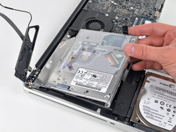

  • Lift the optical drive near its connector and pull it away from the upper case to remove it from the computer.

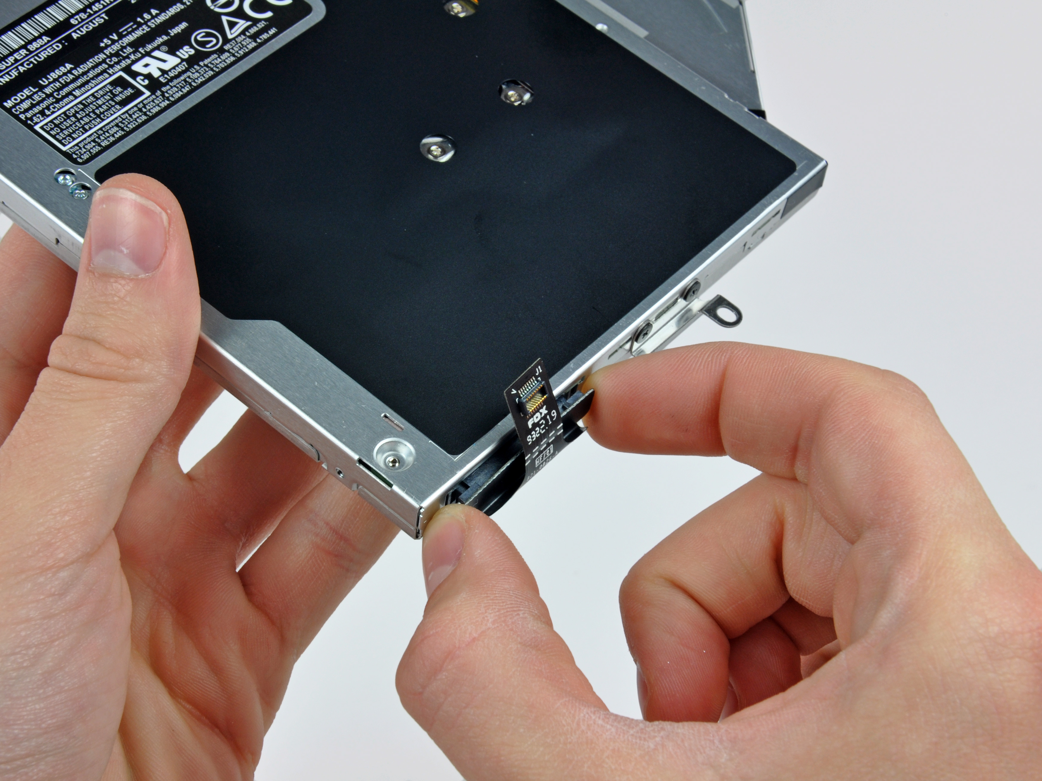

  • Pull the optical drive cable out of the optical drive.
  • Be sure to pull by the edges of the connector, not by the cable itself.

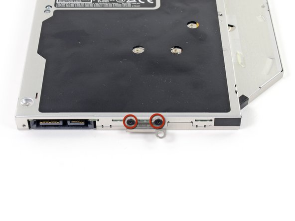

  • Remove the two black Phillips #0 screws securing the small metal mounting bracket. Transfer this bracket to your new optical drive or hard drive enclosure.
