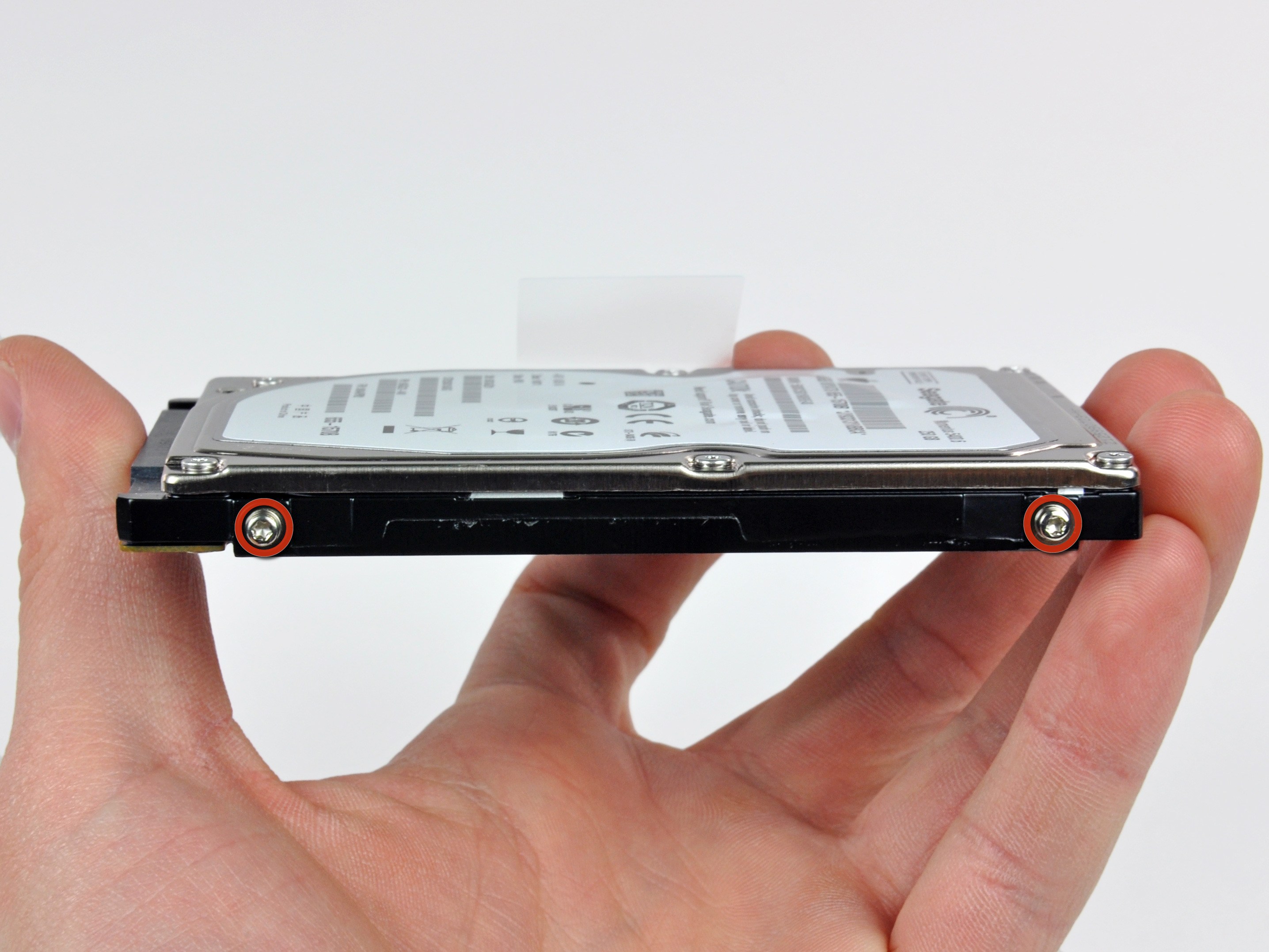

  11. MacBook Pro 15" Unibody Mid 2010 Hard Drive Replacement, Hard Drive: step 11, image 1 of 2 MacBook Pro 15" Unibody Mid 2010 Hard Drive Replacement, Hard Drive: step 11, image 2 of 2
    • Remove two T6 Torx screws from each side of the hard drive (four screws total).
    • You'll need to transfer these screws to your new hard drive if you're changing drives.
    • If desired, peel the pull tab off your old hard drive and transfer it to the side of your new drive.
    • If you are installing a new hard drive, we have an OS X install guide to get you up and running. Many recent Macs may be able to use OS X Internet Recovery.
