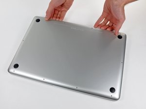

Remove the following ten screws securing the lower case to the upper case:
Seven 3 mm Phillips screws.
Three 13.5 mm Phillips screws.
Using both hands, lift the lower case near the vent to pop it off two clips securing it to the upper case.
Remove the lower case and set it aside.

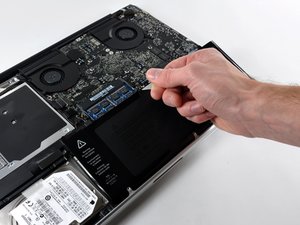

Use the tip of a spudger to bend back the finger of the "Warning: Do not remove the battery" sticker while you remove third five-point Pentalobe screw hidden underneath.
Lift the battery by its plastic pull tab and slide it away from the long edge of the upper case.
My T6 (appears to be same screw driver you have - $6 on amazon for 20piece set) did NOT fit int he battery screws...not sure if I had the wrong screws or what, but I went ahead w/o battery steps and it was pretty easy.
I also noticed that the new SDD (from crucial) didn't have the 4 screws, so I had to move those off the old HD and onto the new one.
Just had the same issue: T6 does not fit the battery screws ;-( ... but with a little bit more preassure it was possible to remove the screws.
Tilt the battery back enough to access the battery cable connector.
Pull the battery cable connector away from its socket on the logic board and remove the battery from the upper case.

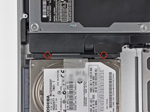

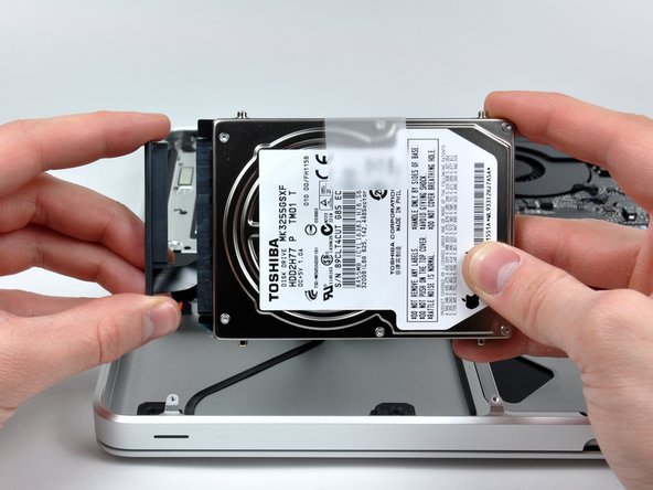

Remove the two Phillips screws securing the hard drive bracket to the upper case.
Lift the the retaining bracket out of the upper case.

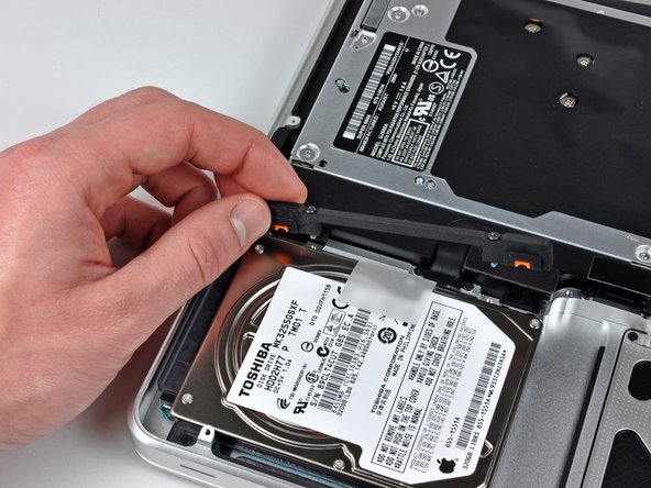

Lift the hard drive by its pull tab and pull it out of the chassis, minding the cable attaching it to the computer.
Remove the hard drive cable by pulling the hard drive straight away from the connector. Keep the connector steady. If pulled by the connector, it can be pulled too far and accidentally tear the hard drive cable.

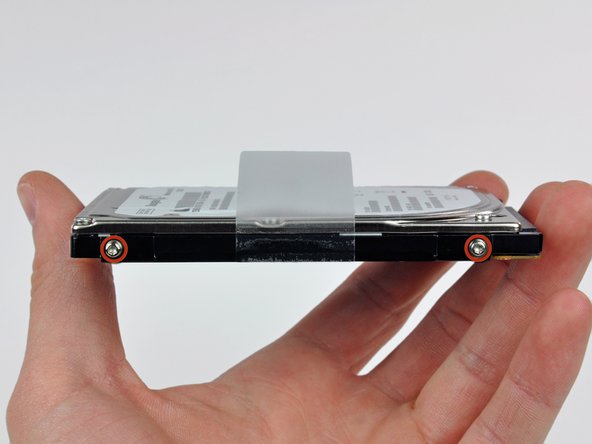

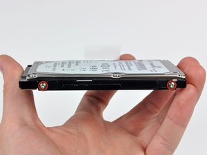

Remove two T6 Torx screws from each side of the hard drive (four screws total).
