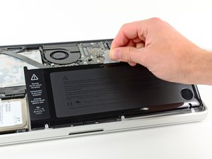

Edit Step 5 Battery  ¶
Image 1/1:
  • Remove the two 7.4 mm Tri-wing screws securing the battery to the upper case.
Edit Step 6  ¶
Image 1/1: Remove the last 7.4 mm Y1 Tri-wing screw securing the battery to the upper case.
Edit Step 6  ¶
  • Carefully peel the battery warning label off the upper case between the battery and the optical drive to reveal an additional Tri-wing screw.
  • Remove the last 7.4 mm Y1 Tri-wing screw securing the battery to the upper case.
  • Do not remove the label from the battery.
Edit Step 7  ¶
Image 1/1:
Edit Step 7  ¶
  • Use the attached plastic pull tab to remove the battery from the upper case.
