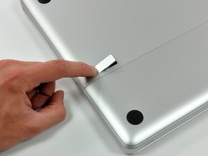

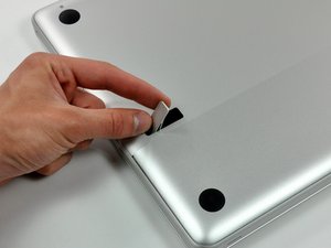

Image 1/2: Depress the grooved side of the access door release latch enough to grab the free end.  Lift the release latch until it is vertical. Image 2/2: Depress the grooved side of the access door release latch enough to grab the free end.  Lift the release latch until it is vertical.
  • With the case closed, place the Unibody top-side down on a flat surface.
  • Depress the grooved side of the access door release latch enough to grab the free end. Lift the release latch until it is vertical.
The A1286 has no Access Door.!!
I actually can see no sign of the battery!...

I assume you have the newer model, with the built-in battery. It's still removable with tools, but these are the wrong instructions for that model.

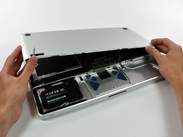

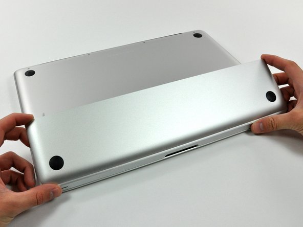

Image 1/1:
  • Using both hands, lift and remove the lower case off the upper case.
About midway along each edge is a snap. To release each snap, gently slide the flat edge of a Spudger under the lower case, then lift the lower case away.
jonathansturges - Reply

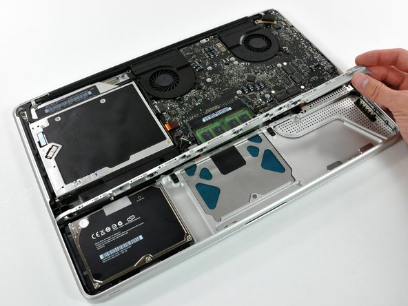

Image 1/1:
  • Lift the mid wall out of the upper case.

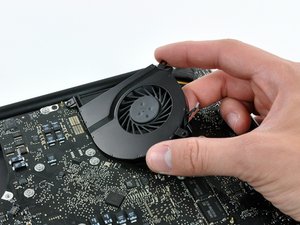

  • Remove the following six screws securing both the right fan and the left fan to the logic board:
    • Four 3.5 mm Phillips screws.
    • Two 3.2 mm Phillips screws.
Pry under the side where the wires connect.
colleenthompson - Reply

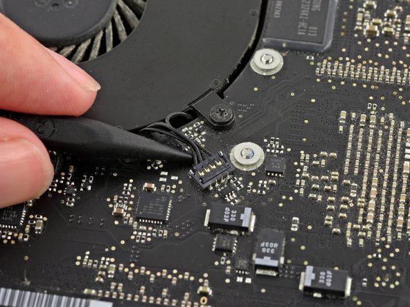

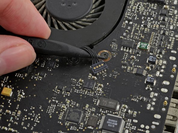

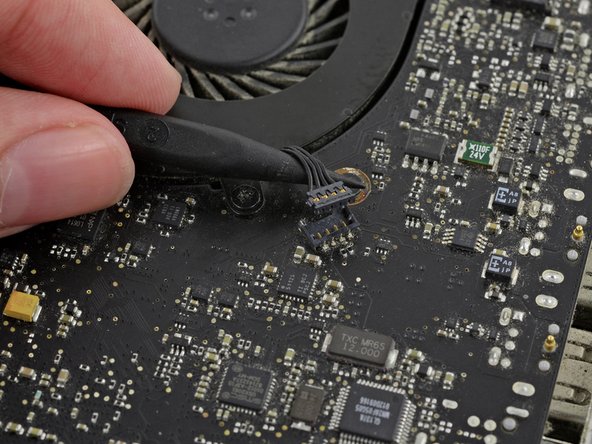

Image 1/3: Be sure to only pry up on the connector itself '''not on the socket''' or you may damage the machine. Image 2/3: It is useful to twist the spudger axially from beneath the fan cable wires to release the connector. Image 3/3: Remove the right fan from the case.
  • Use the tip of a spudger to lift the right fan connector straight up from its socket on the logic board.
    • Be sure to only pry up on the connector itself not on the socket or you may damage the machine.
    • It is useful to twist the spudger axially from beneath the fan cable wires to release the connector.
  • Remove the right fan from the case.
Be really gentle and patient with this connector, I popped the socket right off of the logic board (thankfully the already broken one that I was replacing). It actually shouldn't take much force, and just gently work on it until it comes out.
Mark Middleton - Reply

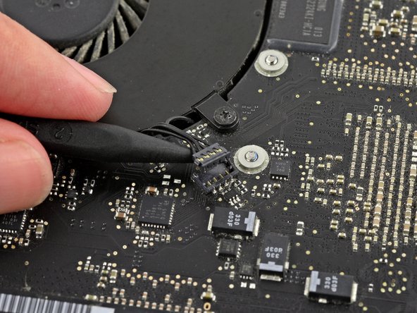

Image 1/3: Be sure to only pry up on the connector itself '''not on the socket''' or you may damage the machine. Image 2/3: It is useful to twist the spudger axially from beneath the fan cable wires to release the connector. Image 3/3: Remove the left fan from the case.
  • Use the tip of a spudger to lift the left fan connector straight up from its socket on the logic board.
  • Remove the left fan from the case.

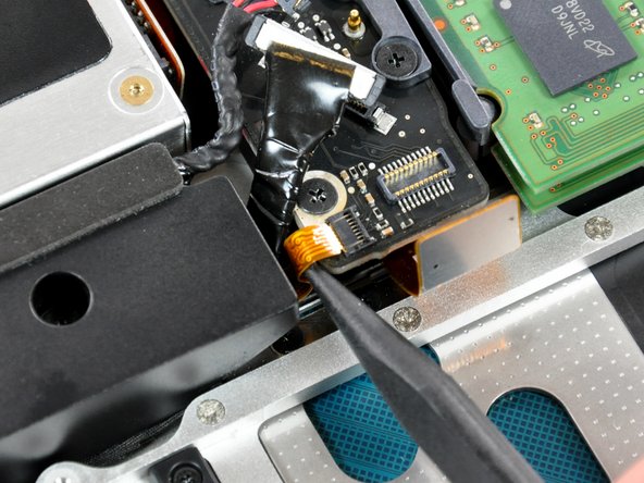

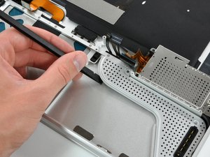

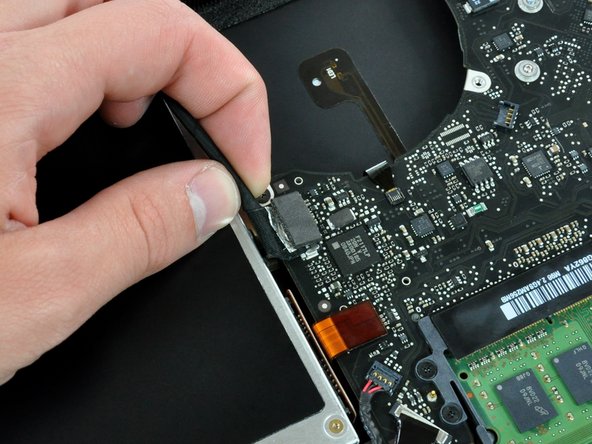

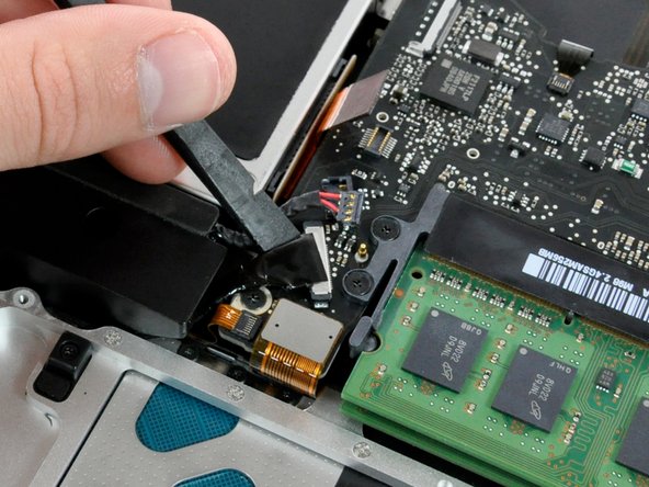

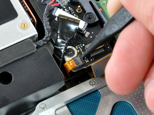

Image 1/1: Disconnect the camera cable by pulling the male end out of its socket, parallel to the logic board, '''do not''' lift it upwards.
  • Remove any adhesive from the camera cable connector.
  • Disconnect the camera cable by pulling the male end out of its socket, parallel to the logic board, do not lift it upwards.
There's a little shiny piece of plastic holding this item in place to keep it from sliding out of it's slot. It's glued on and if you don't take it off first, you'll likely bend the connector so that it won't work anymore. Ruined a motherboard because this step was missing.
maccentric - Reply
What this guy said - REMOVE the shiny plastic block first. Also the "straight away" means sliding outwards TOWARDS THE OPTICAL BAY - *NOT* upwards.
Damien - Reply

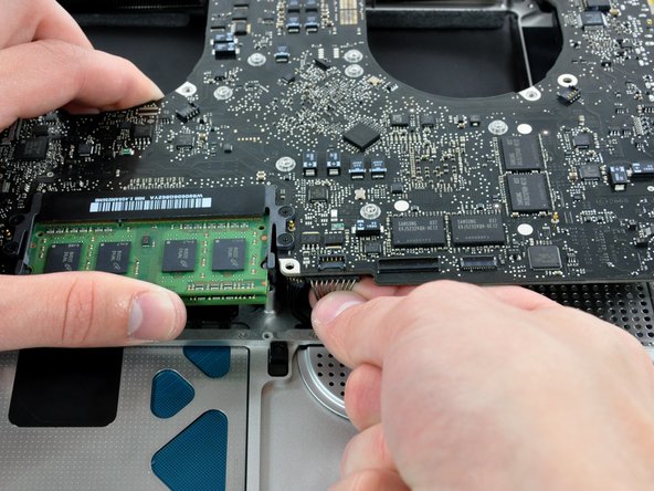

Image 1/1:
  • Use a spudger to carefully pry the optical drive connector straight up off its socket on the logic board.

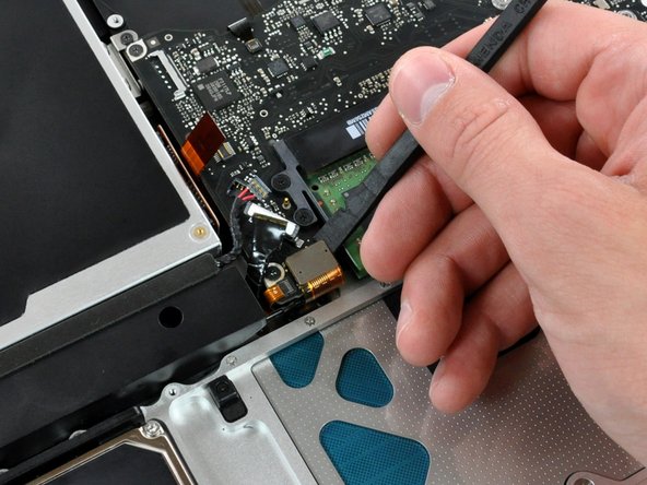

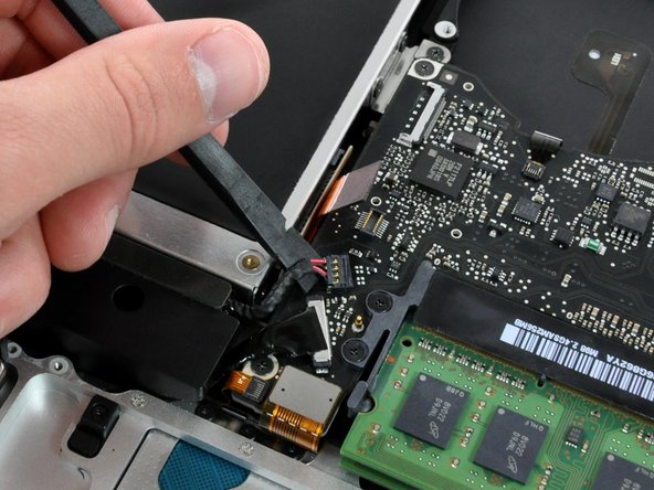

Image 1/1: Using the flat end of a spudger, pry the subwoofer connector straight up off its socket on the logic board.
  • If necessary, peel off the foam bumper covering the subwoofer connector.
  • Using the flat end of a spudger, pry the subwoofer connector straight up off its socket on the logic board.
  • Be very careful. This connection is delicate, the socket can be easily broken off the logic board.
I Broke the subwoofer socket on the logic board. Can I use without subwoofer, or do I now have to replace the logic board?
jbp0471 - Reply
Sorry to hear this. Yes, you can use the machine without the subwoofer. To be safe, cover the subwoofer plug with some electrical tape so that it can't cause a short circuit somewhere.
Marty Swartz -

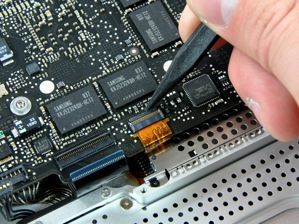

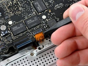

  • Use the flat end of a spudger to pry the silver-colored hard drive cable connector straight up out of its socket on the logic board.
Image 1/1:
  • Use a spudger to pry the trackpad connector straight up out of its socket on the logic board.

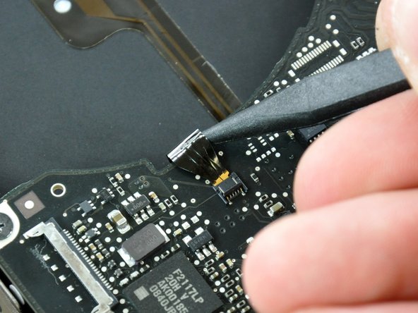

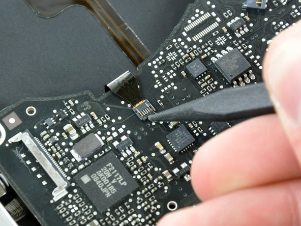

Image 1/2: Pull the IR/sleep LED ribbon cable straight out of its socket. Image 2/2: Pull the IR/sleep LED ribbon cable straight out of its socket.
  • Using the tip of a spudger, flip up the IR/sleep LED ribbon cable retaining flap.
  • Pull the IR/sleep LED ribbon cable straight out of its socket.
Hi, thanks for this tutorial: it solved my problem.
But unfortunately I have broken the IR/sleep LED ribbon cable socket on motherboard (cable is ok, socket crumbled): computer works fine but now it doesn't go on standby anymore. Is there a way to fix the cable on motherboard (for example with Kapton tape) or is there a software to manage computer standby?
Thanks in advance for your help.
Mary
mary - Reply

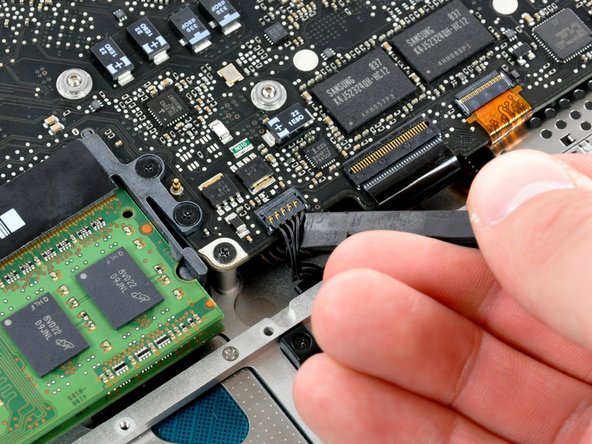

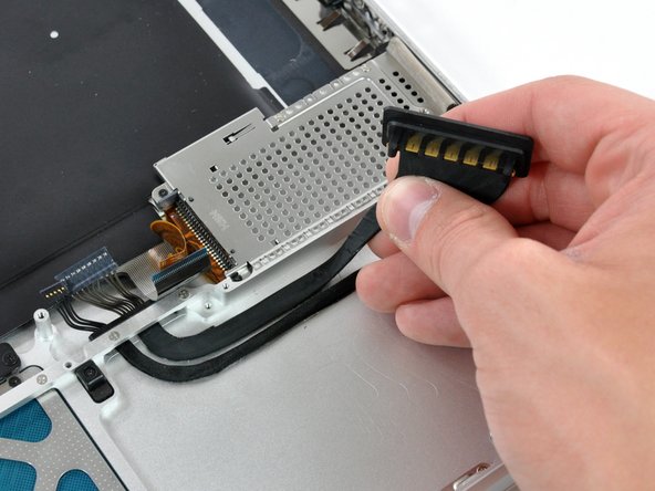

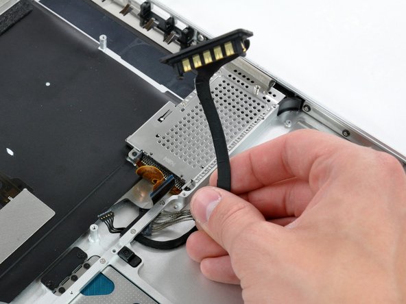

Image 1/1: Pry up under the cable wires to avoid pulling the socket itself off of the logic board.
  • Use a spudger to pry the battery indicator light connector straight up out of its socket on the logic board.
  • Pry up under the cable wires to avoid pulling the socket itself off of the logic board.

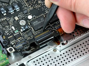

Image 1/2: Pull the keyboard ribbon cable straight out of its socket. Image 2/2: During reassembly, make sure to fully insert the keyboard ribbon cable back into the ZIF socket.
  • Using the tip of a spudger, flip up the keyboard ribbon cable retaining flap.
  • Pull the keyboard ribbon cable straight out of its socket.
  • During reassembly, make sure to fully insert the keyboard ribbon cable back into the ZIF socket.
I ran into trouble when re-installing the keyboard cable. I got everything put back together, plugged it in, and pressed Power... and nothing happened. I took everything apart again, reseated the heat sink and everything, put it back together... and the Power button didn't respond.
The MagSafe light came on, and the battery charge lights came on. But it wouldn't power up.
Finally I figured out that the keyboard cable is really tricky to get in correctly. If you can slide it out with the retaining clip locked (applying very little pressure), then the cable isn't actually in correctly. I had to really fiddle with it, and maybe slide it in one side first, to see that it actually needed to slide in another 1/8th inch or so beyond what felt like "in" the first few times I did it.
Once I'd secured that cable, my MacBook turned on again without a problem. So far, after just replacing the Thermal Paste (I didn't actually install a new heat sink), the computer is running 20°F cooler than it has in years. Thanks!
simolinic - Reply

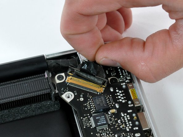

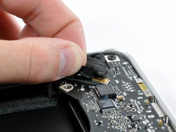

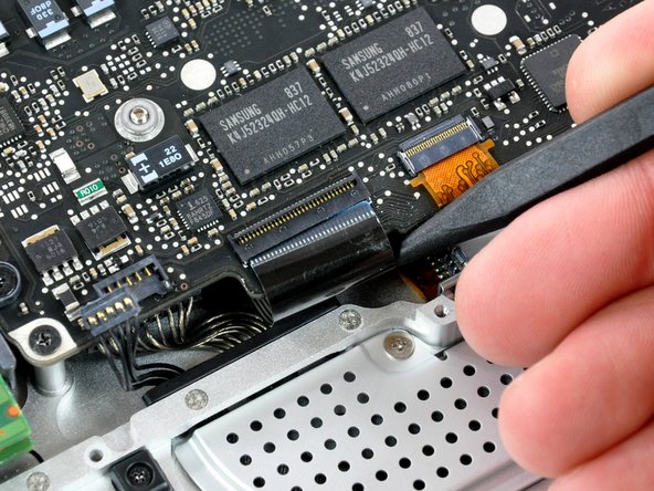

Image 1/2: Pull the display data cable connector straight away from its socket. Image 2/2: When disconnecting the display data cable, do not pull on the black tab secured to the cable lock. We recommend wiggling the cable while applying tension to slowly "walk" the connector out of its socket.
  • Grab the plastic pull tab secured to the display data cable lock and rotate it toward the DC-in side of the computer.
  • Pull the display data cable connector straight away from its socket.
  • When disconnecting the display data cable, do not pull on the black tab secured to the cable lock. We recommend wiggling the cable while applying tension to slowly "walk" the connector out of its socket.
  • Make sure the display data cable is placed correctly in its socket during reassembly. Failure to do so will result in a partially visible display or no display image at all.

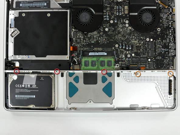

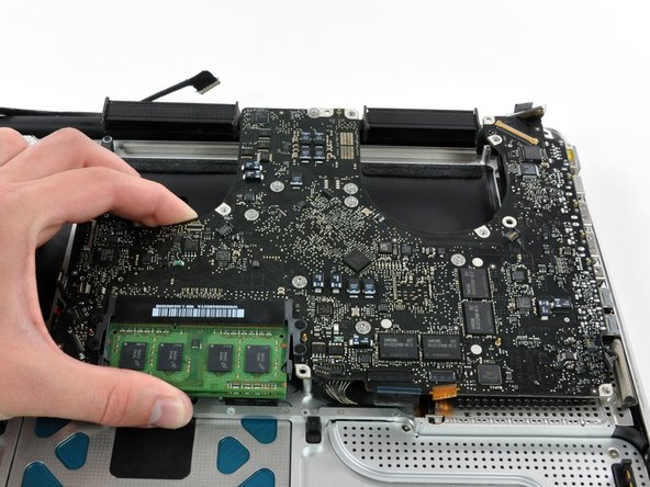

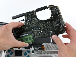

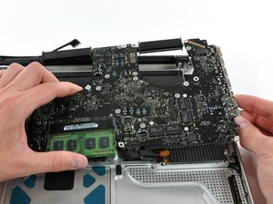

Image 1/1: Do not remove the logic board yet! There are connectors attached to the underside of the logic board that must first be disconnected.
  • Remove seven 3.2 mm Phillips screws securing the logic board to the upper case.
  • Do not remove the logic board yet! There are connectors attached to the underside of the logic board that must first be disconnected.
On reassembly, check carefully that none of the fiddly little cables are trapped under the logic board. I had to back up and liberate the subwoofer connector. It takes some careful jiggling to get the sockets seated in the port holes.

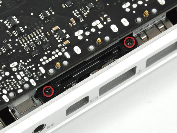

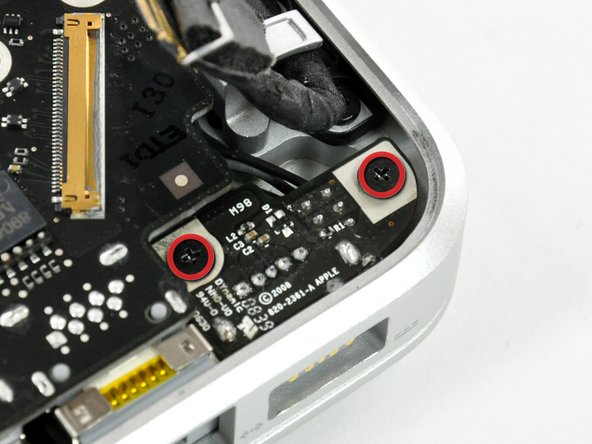

Image 1/1: Note: This step is not completely necessary, but it will make it easier to disconnect the cable that is connected to the DC-in board.
  • Remove two 7 mm Phillips screws securing the DC-in board to the upper case.
  • Note: This step is not completely necessary, but it will make it easier to disconnect the cable that is connected to the DC-in board.

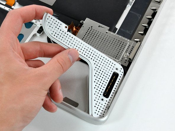

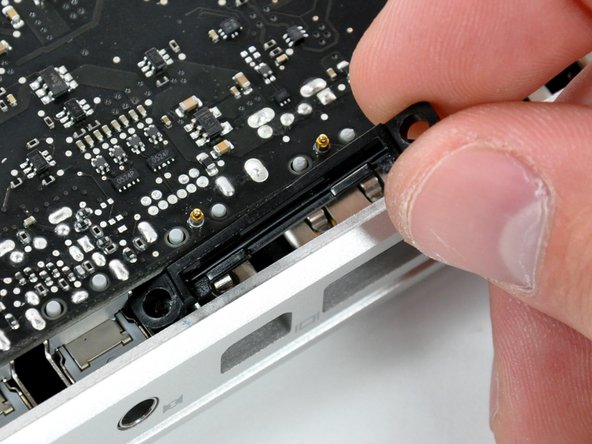

Image 1/2: Lift the bottom case clip out of the upper case. Image 2/2: Some MacBook Pro Unibodies do not have a bottom case clip and do not require this step.
  • Remove two 3.5 mm Phillips screws securing the bottom case clip to the upper case.
  • Lift the bottom case clip out of the upper case.
  • Some MacBook Pro Unibodies do not have a bottom case clip and do not require this step.
My clip is oriented 180 degrees (flipped) from this picture.
The bottom case clip is screwed to a black plastic bracket that's glued onto the upper case. My replacement upper case did not come with this bracket. I had to carefully pry it off the old upper case, taking care not to break it, and glue it to the new upper case before replacing the logic board.
I have a 2.66ghz 15inch Unibody Macbook Pro (A1286) and this step was not necessary.
Andrew Mostajo - Reply

Image 1/2: '''Do not''' entirely remove the logic board yet! Image 2/2: Ensure that the logic board is free from all connections to the upper case (except the battery connector) before proceeding.
  • Carefully lift the logic board assembly from the left side and work it out of the upper case, minding the port side that may get caught during removal.
  • Do not entirely remove the logic board yet!
  • Ensure that the logic board is free from all connections to the upper case (except the battery connector) before proceeding.
  • During reassembly, ensure all connectors and cables are not placed underneath the logic board. Some of the ribbon cables are very thin and fragile.
Image 1/2: Lift the logic board assembly out of the upper case. Image 2/2: Lift the logic board assembly out of the upper case.
  • Lift the logic board enough to grab the battery connector and pull it straight away from its socket on the logic board.
  • Lift the logic board assembly out of the upper case.
I didn't have to do this step, I just leaned the logic board up and changed the DC board.

  • Remove three 2 mm Phillips screws securing the battery connector cover to the upper case.
This whole procedure - removing the battery connector - is NOT NECESSARY! This battery connector is included on the Apple supplied replacement part. DO NOT go through the excessive effort to remove this part if you're getting an Apple part - you'll only end up giving them back an incomplete core part. Boo.
Matt Falcon - Reply

Image 1/2: De-route the battery connector cable through the gap in the upper case and remove it from the computer. Image 2/2: De-route the battery connector cable through the gap in the upper case and remove it from the computer.
  • Peel the battery connector cable off the adhesive securing it to the upper case.
  • De-route the battery connector cable through the gap in the upper case and remove it from the computer.
