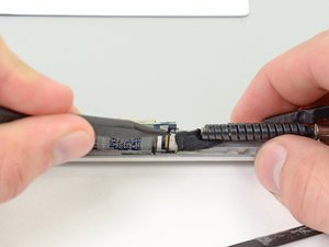

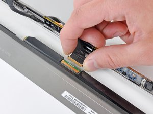

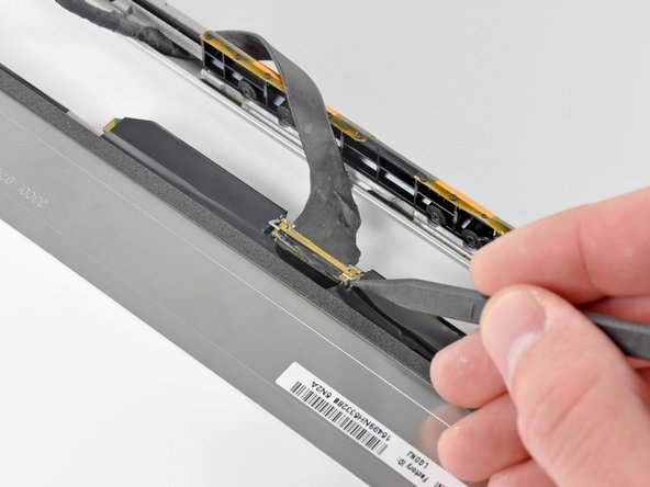

Image 1/2: Pull the LVDS connector straight away from its socket. Image 2/2: When disconnecting the LVDS cable, do not pull on the black tab secured to the LVDS cable lock. We recommend wiggling the cable while applying tension to slowly "walk" the connector out of its socket.
  • Grab the plastic pull tab secured to the LVDS cable lock and rotate it toward the DC-in side of the computer.
  • Pull the LVDS connector straight away from its socket.
  • When disconnecting the LVDS cable, do not pull on the black tab secured to the LVDS cable lock. We recommend wiggling the cable while applying tension to slowly "walk" the connector out of its socket.

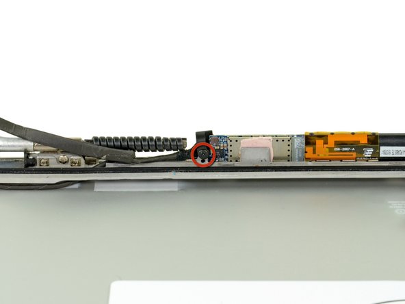

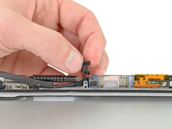

Image 1/2: This screw may remain captive in the LVDS cable. Image 2/2: Lift the LVDS cable bracket out of the upper case.
  • Remove the 7 mm Phillips screw from the LVDS cable bracket.
  • This screw may remain captive in the LVDS cable.
  • Lift the LVDS cable bracket out of the upper case.

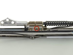

Image 1/1:

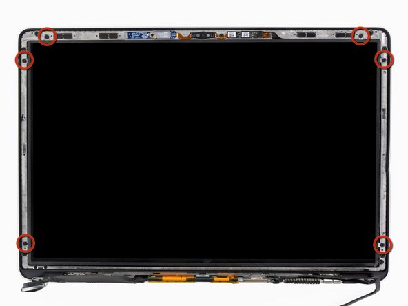

  • Remove the two outer 6 mm Torx screws securing each side of the display to the upper case (four screws total).
Ccouldn't make it past step 10 as the two T6 screws on the right stripped. I was using the correct tool, correctly seated, but the screws were simply unwilling to turn and the screw head gave out before they turned at all. The ones on the left came out alright, but there seems to be some type of thread glue on them. Recommendations on how to break that seal without stripping the screw heads might be a good idea. Otherwise - be forewarned.
Jonathan Field - Reply
I have the same problem with step 10. Can't remove the screw on the left, it is all damaged.
Benny Chew - Reply

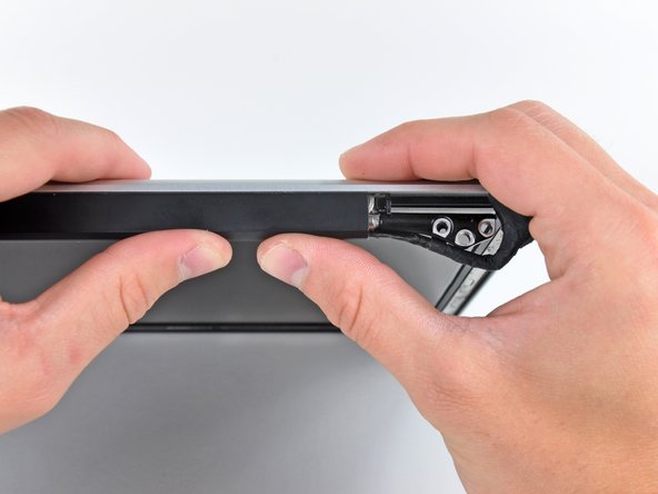

Image 1/3: Rotate the display slightly away from the upper case. Image 2/3: Lift the display away from the upper case, minding any brackets or cables that may get caught. Image 3/3: Lift the display away from the upper case, minding any brackets or cables that may get caught.
  • Grab the upper case with your right hand and rotate it slightly toward the top of the display so the upper display bracket clears the edge of the upper case.
  • Rotate the display slightly away from the upper case.
  • Lift the display away from the upper case, minding any brackets or cables that may get caught.

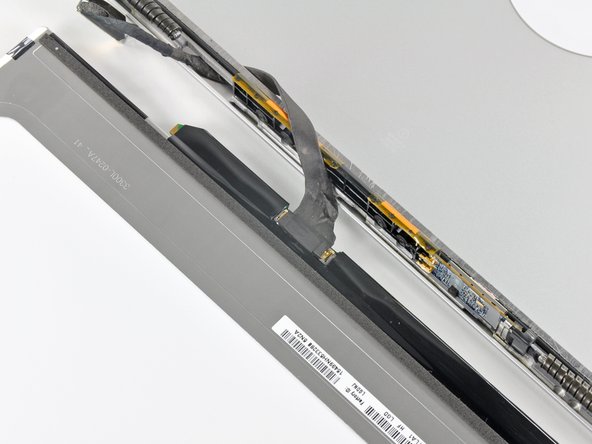

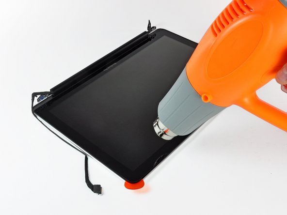

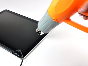

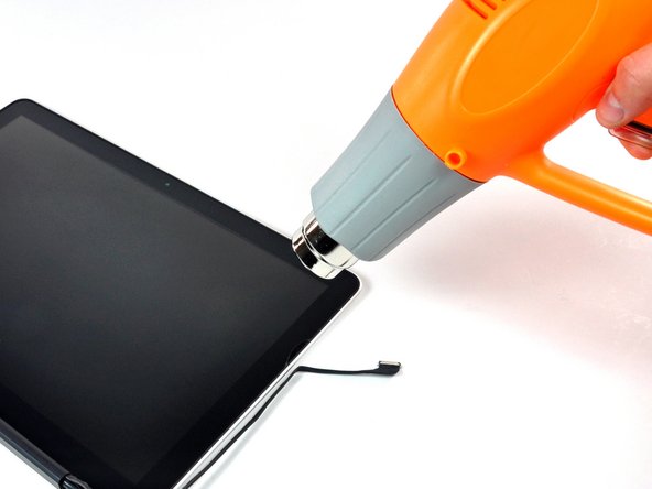

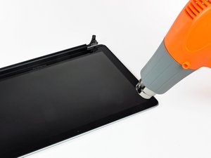

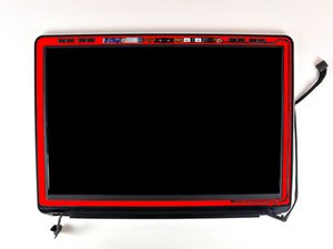

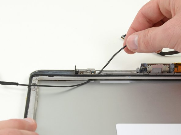

Image 1/2: Before starting, be sure to clean the display glass with lint-free cloth moistened with a mild solution; it will make the suction cup adhere better, and will make checking for dust on reassembly easier Image 2/2: With the heat gun set to low, start by heating the outer black border near the upper right corner of the glass panel.
  • In the following steps, you will use a heat gun to soften the adhesive securing the outer black border around the underside of the front glass panel to the display. The area the adhesive is applied to is shown in red in the second picture.
  • Before starting, be sure to clean the display glass with lint-free cloth moistened with a mild solution; it will make the suction cup adhere better, and will make checking for dust on reassembly easier
  • With the heat gun set to low, start by heating the outer black border near the upper right corner of the glass panel.
  • Always aim the heat gun away from the soft rubber strip around the display glass. Heating the rubber will cause it to melt slightly, turning its finish from matte to glossy. Touching overheated rubber can cause it to permanently deform.
  • Due to the heat applied, it is normal for a layer of condensation to develop on the inside of the glass panel and/or the outside of the LCD. It can be removed with glass cleaner once the glass is separated from the display.
Another caution is needed - the heat gun is capable of discoloring the LCD panel (giving uneven coloration) if it overheats. This is possible on the low setting. Proceed cautiously, heating in increments until the glass releases.
Alden Stradling - Reply
I was wondering the same, is absolutely necessary to disassemble the screen to change the glass? Can I jump to step 21?
caholzmann - Reply

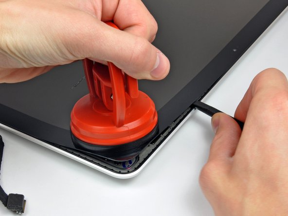

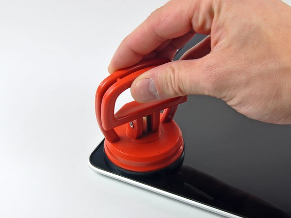

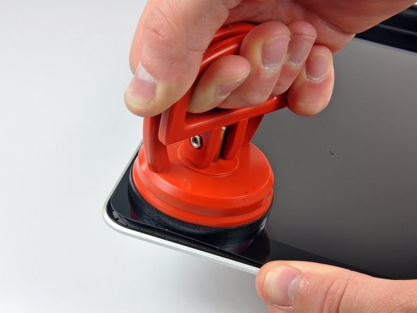

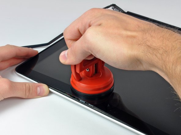

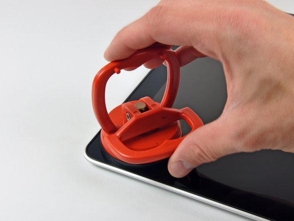

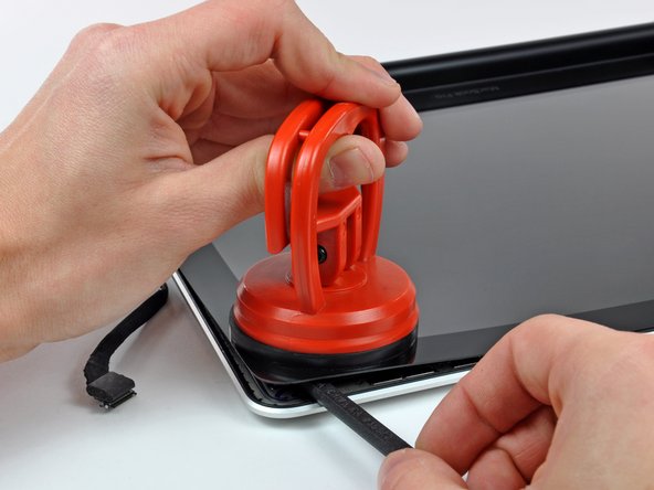

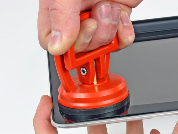

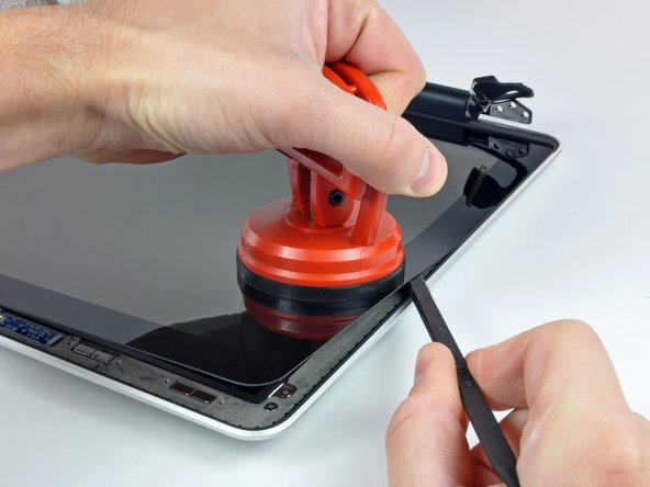

Image 1/3: Don't fasten the suction cup on top of the rubber strip around the edge of the display glass. Image 2/3: To attach the [product|IF145-023|suction cups] we sell, first position the suction cup with the movable handle parallel to the face of the glass panel. While lightly holding the suction cup against the glass, raise the movable handle until it is parallel with the other handle. Image 3/3: Slowly and gently pull the corner of the display glass up off the display assembly.
  • With the panel sufficiently heated, fasten a heavy-duty suction cup near the upper right corner of the display glass.
  • Don't fasten the suction cup on top of the rubber strip around the edge of the display glass.
  • To attach the suction cups we sell, first position the suction cup with the movable handle parallel to the face of the glass panel. While lightly holding the suction cup against the glass, raise the movable handle until it is parallel with the other handle.
  • Slowly and gently pull the corner of the display glass up off the display assembly.
  • If only the top edge of the glass lifts up (as seen in the third picture), repeat steps one and two until you can lift up the corner of the panel.

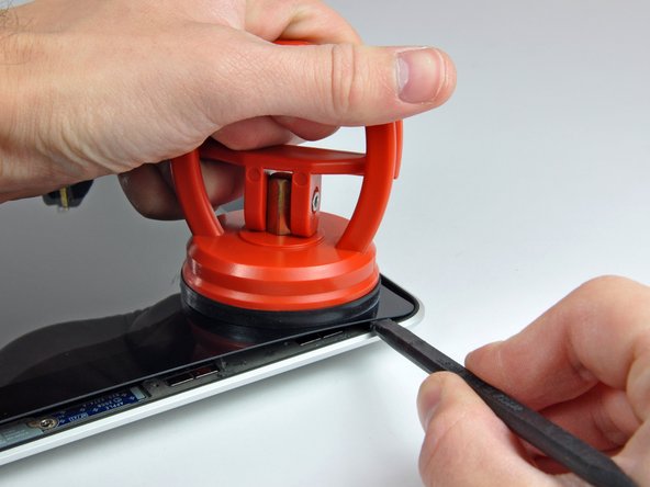

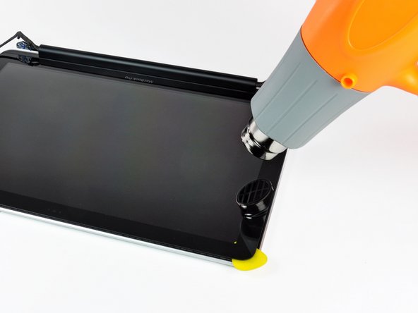

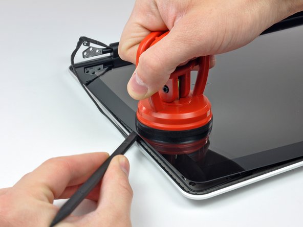

Image 1/3: Use the flat end of a spudger to gently pry up the adhesive securing the front glass to the display. Image 2/3: Pry up the glass panel a few inches away from the upper right corner along the top and right edges of the display. Image 3/3: Pry up the glass panel a few inches away from the upper right corner along the top and right edges of the display.
  • Gently lift the corner of the display glass enough to insert a spudger between it and the display assembly.
  • Use the flat end of a spudger to gently pry up the adhesive securing the front glass to the display.
  • Pry up the glass panel a few inches away from the upper right corner along the top and right edges of the display.
Be careful with the spudger and the soft rubber strip around the glass. Since the rubber strip has been heated up by the heat gun, it is easily smushed and deformed by the spudger.
robcork - Reply
Be patient and work slowly or else you will crack the glass like me.
BillyRachel1 - Reply
I can not get the glass to come up despite two tries and dicsoloring the LCD with too much heat. Why can't I get the glass to budge at all?
bollucks66 - Reply

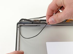

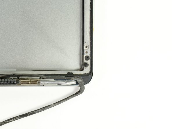

Image 1/2: Attach a suction cup along the right side of the front glass panel. Image 2/2: Pull up on the glass panel while you use the flat end of a spudger to separate it from the rest of the display assembly.
  • Use a heat gun to soften the adhesive under the black strip along the right side of the front glass panel.
  • Attach a suction cup along the right side of the front glass panel.
  • Pull up on the glass panel while you use the flat end of a spudger to separate it from the rest of the display assembly.
  • Continue working along the right edge of the front display glass until it is separated from the display.
  • It may be helpful to use a guitar pick or another thin plastic object to keep the upper right corner of the front glass panel from sticking back down to the display assembly.
If you don't have a guitar pick, playing cards works too.
robcork - Reply

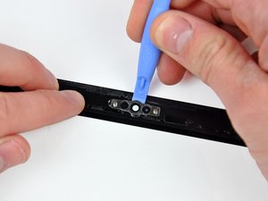

Image 1/2: Attach a suction cup near the upper left corner of the glass display panel. Image 2/2: Pull up on the suction cup and use the flat end of a spudger to carefully pry the glass display panel out of the display assembly.
  • Use a heat gun to soften the adhesive under the black strip near the upper left corner of the glass display panel.
  • Attach a suction cup near the upper left corner of the glass display panel.
  • Pull up on the suction cup and use the flat end of a spudger to carefully pry the glass display panel out of the display assembly.
  • Once the upper left corner has been separated from the display, it may be helpful to use a guitar pick or another thin plastic object to keep the glass from sticking back down to the display assembly.

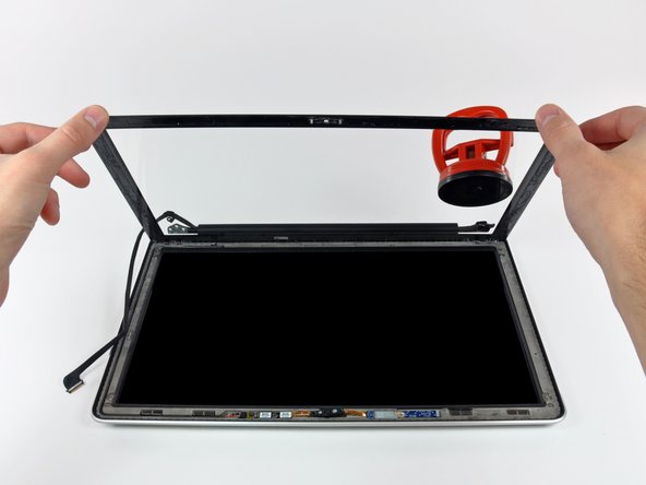

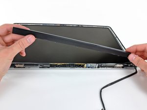

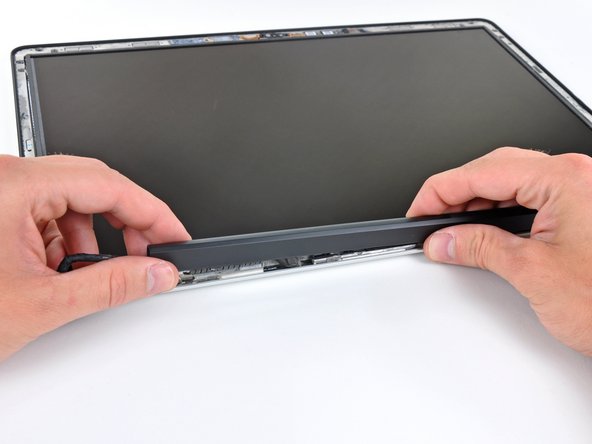

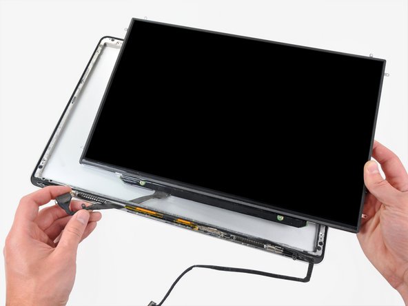

Image 1/2: If necessary, use the flat end of a spudger to free the bottom edge of the glass display panel from the display assembly. Image 2/2: Before reassembling, be sure to clean both the inside of the glass display panel and the LCD as any dust or fingerprints trapped inside will be annoyingly visible when the machine is on.
  • Now that the top, left, and right edges of the glass are free from the display, slowly lift the top edge of the glass panel and gently rotate it out of the display.
  • If necessary, use the flat end of a spudger to free the bottom edge of the glass display panel from the display assembly.
  • Before reassembling, be sure to clean both the inside of the glass display panel and the LCD as any dust or fingerprints trapped inside will be annoyingly visible when the machine is on.
If you will be reusing the glass, with new adhesive, then you will want to remove the old adhesive. This is a bit of a pain, as alcohol doesn't work, and you need to be careful to avoid damaging the black screen border, which is black paint on the back (adhesive) side of the glass.
To remove the adhesive, note that it is actually a thin film with rubber cement on both sides. First, use a razor to carefully pull up one corner of the film and gently peel it off of the glass. If you are gentle and slow, the underlying adhesive may also come off; if not, then rubbing with your finger or a hard rubber eraser will do the trick.
griscom - Reply

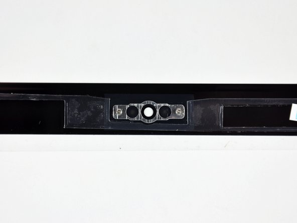

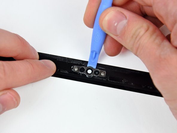

Image 1/2: Do not forget to stick the camera bracket down to the new front display glass before reassembly. Image 2/2: Do not forget to stick the camera bracket down to the new front display glass before reassembly.
  • Insert the edge of a plastic opening tool between the display glass and the camera bracket, and run it around the camera bracket to separate it from the display glass.
  • Do not forget to stick the camera bracket down to the new front display glass before reassembly.
This step is only needed if replacing the glass. If you are only replacing the LCD, there is no need to do this step

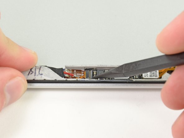

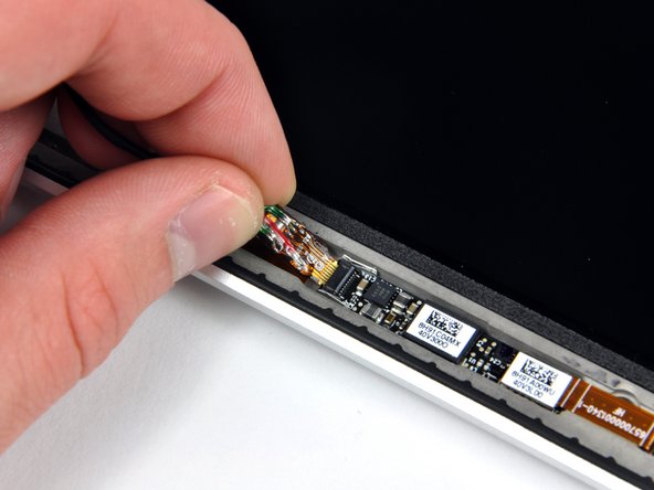

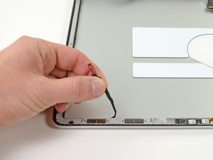

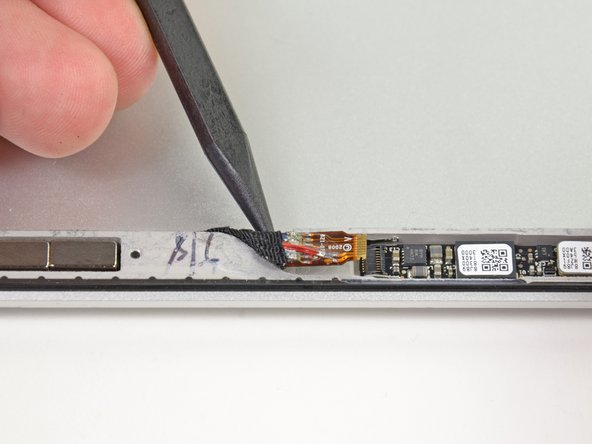

Image 1/3: To reconnect the cable, first use the tip of a spudger to remove the piece of foam tape over the camera cable ZIF socket. Image 2/3: Use the tip of a spudger to flip up the ZIF cable retainer on the camera cable socket. Image 3/3: Insert the camera cable into its socket on the camera board and use the tip of a spudger to snap down the ZIF cable retainer, locking the cable in place.
  • During the glass removal process, the camera cable may stick to the adhesive on the glass panel, disconnecting it from the camera board as the panel is lifted. If your camera cable is still connected to the camera board, skip this step.
  • To reconnect the cable, first use the tip of a spudger to remove the piece of foam tape over the camera cable ZIF socket.
  • Use the tip of a spudger to flip up the ZIF cable retainer on the camera cable socket.
  • Insert the camera cable into its socket on the camera board and use the tip of a spudger to snap down the ZIF cable retainer, locking the cable in place.
  • Reapply the piece of tape covering the camera cable socket.

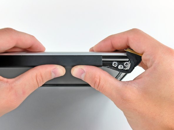

Image 1/2: The clutch cover will move approximately .25" and stop. Do not force it too far to the right. Image 2/2: When reinstalling the clutch cover, be sure to slip it over the components protruding from the lower edge of the display about .25" to the right of its final installed position on the display.
  • Slide the clutch cover toward the right edge of the display.
  • The clutch cover will move approximately .25" and stop. Do not force it too far to the right.
  • When reinstalling the clutch cover, be sure to slip it over the components protruding from the lower edge of the display about .25" to the right of its final installed position on the display.
Image 1/2: Working from right to left, carefully continue to release and lift the clutch along the lower edge of the display assembly. Image 2/2: Lift the clutch cover up off the front bezel and set it aside.
  • Starting at its far left end, rock the clutch cover along its long axis while pulling it away from the clutch hinge.
  • Working from right to left, carefully continue to release and lift the clutch along the lower edge of the display assembly.
  • Lift the clutch cover up off the front bezel and set it aside.
  • When reinstalling the clutch cover, be sure to widen the opening when slipping it over the small black plastic cosmetic cover that fills the open end of the clutch cover when it is in place. The cosmetic cover has very thin and delicate plastic arms that hold it to the right clutch hinge.

  • Remove the six 2.9 mm Phillips screws securing the LCD panel to the front bezel.
Hey guys, I need to get the part where the screws are on, whats its name or where could I find it? That part on my Computer broke.... Do you guys think its possible to guet it somewhere?

Image 1/1: It may be helpful to use one hand to feed the display data cable through its channel in the aluminum display assembly as you pull the LCD toward the top edge of the display with the other hand.
  • Pull the LCD toward the top edge of the display to slide the circuitry along its lower edge out of the recess in the aluminum display assembly.
  • It may be helpful to use one hand to feed the display data cable through its channel in the aluminum display assembly as you pull the LCD toward the top edge of the display with the other hand.

  • Peel the piece of tape covering the display data cable connector away from the edge closest to the LCD.
Image 1/2: Pull the display data cable straight away from its socket on the LCD. Image 2/2: Lift the LCD out of the display assembly and set it aside.
  • Use the tip of a spudger to flip up the thin steel retaining clip securing the display data cable to its socket on the LCD.
  • Pull the display data cable straight away from its socket on the LCD.
  • Lift the LCD out of the display assembly and set it aside.
  • If you are replacing the LVDS/display data cable, simply de-route it from its slot cut into the display casing.

  • Remove the 2.2 mm Phillips screw located near the bottom right corner securing the AirPort/iSight cable to the display assembly
Image 1/2: Lift and remove the plastic tab up off the inverter board. Image 2/2: Lift and remove the plastic tab up off the inverter board.
  • Remove the single 2.9 mm Phillips screw securing the plastic tab covering right edge of the inverter board.
  • Lift and remove the plastic tab up off the inverter board.

Image 1/2: Pull the AirPort cable straight out of its socket on the AirPort board. Image 2/2: Do not lift up on the AirPort cable, as its socket is very fragile. Pull the cable parallel to the face of the AirPort board.
  • Use the tip of a spudger to push the AirPort cable retaining lock away from its socket on the AirPort board.
  • Pull the AirPort cable straight out of its socket on the AirPort board.
  • Do not lift up on the AirPort cable, as its socket is very fragile. Pull the cable parallel to the face of the AirPort board.
Image 1/2: Continue de-routing the AirPort/iSight cable from the right side of the display assembly. Image 2/2: Continue de-routing the AirPort/iSight cable from the right side of the display assembly.
  • De-route the iSight ribbon cable from its channel near the top right corner of the display assembly.
  • Continue de-routing the AirPort/iSight cable from the right side of the display assembly.

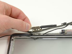

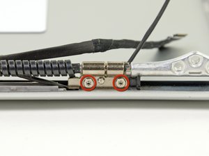

Image 1/3: Remove the right hinge up off the display assembly. Image 2/3: Remove the right hinge up off the display assembly. Image 3/3: Remove the right hinge up off the display assembly.
  • Remove three 2.5 mm T6 Torx screws securing the right hinge to the display assembly.
  • Remove the right hinge up off the display assembly.
Image 1/1: Remove the AirPort/iSight cable from the display assembly.
  • Pull the AirPort/iSight cable through the opening located near the bottom right corner of the display assembly.
  • Remove the AirPort/iSight cable from the display assembly.
