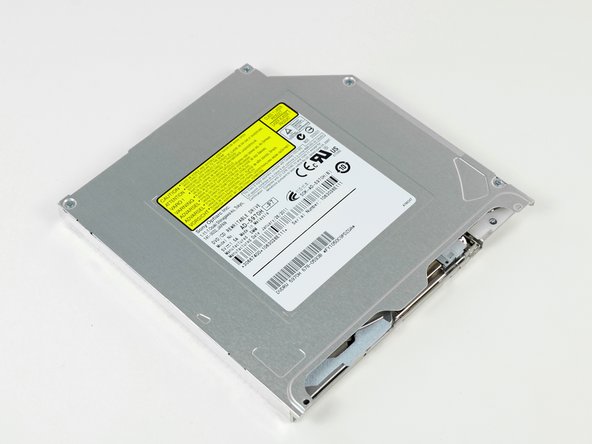

Introduction
MacBook Pro not reading CDs? Use this guide to replace a burned-out optical drive.

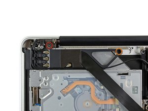

Use the flat end of a spudger to pry the AirPort/Bluetooth connector up from its socket on the logic board.
Use the flat end of a spudger to pry the optical drive connector up from its socket on the logic board.
Remove following two screws:
One 8.6 mm Phillips screw
One 3.9 mm Phillips screw

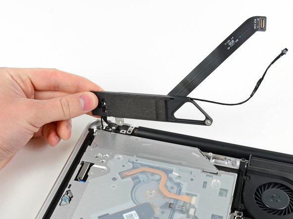

Carefully rotate the AirPort/Bluetooth board housing (with AirPort/Antenna cables still attached) out of the lower case.
Beware of step 8. Screws strip extremely easily. For some reason, that are extremely tough to get out and the metal is extremely soft so you are likely to screw yourself over real quick even if you use the right screwdriver. Happened to me and now it's impossible for me to take the @$%# thing off so I have to return my HDD bay and deal with having a useless disc drive.
I got burned here also. Unfortunately iFixit defaults to comments off, so I didn't see this until it was too late.
Yes, and I got stuck on step 8 for this simple task. Is there no way we can get the drive out while leaving the wireless/bluetooth board in place? I prefer to drill a small hole in the plastic of the board to reach the drive's screw underneath and find a way to slide it out towards the hard disk side.
I had the same thing happen with the 3.9 mm screw. To remove the drive afterwards I used a 1/16" drill bit to carefully remove the (stripped) screw head. I left most of the screw threads intact, and the remaining "post" is enough to hold the airport/bluetooth fixture in place with the one remaining screw. These are some seriously soft screws, folks, be careful!
i also screwed the screw, never saw a screw this soft. Still figuring out how to "unlock" it again...

Well. I too stripped the head on the left side screw. First I used a cheap #000 screwdriver. Stripped the head and the driver. Not realizing just how bad I had stripped the screw I got a #0000 and the right one came out. I made sure to apply firm downward pressure to minimize slip. The left side was to far gone. So...
I broke the housing. Yep. I'm a brute.
Anyway. I rolled it up out of the case as if I had actually removed the screw. Only to realize I don't have a T6. [facepalm]. I've spent way too much time just getting that #0000. I'll order myself a nice kit for future 'repairs'.
Oh and yes, the bluetooth and wifi work just fine. The right screw and the tight fitting of the housing seem to keep it in place ok.
I also failed here.... How can i unscrew both screws if the star of the head is destroyed??
I too stripped the screw on the right, and while I tried a few basic things to remove the screw, eventually I drilled out the screw head so I could remove the airport/bluetooth housing. Only the head came off, enough to free the housing, but it sits pretty snugly on there with just the one screw and that's enough for me.
Alright, Genius bar just made it worse, ended up taking a drill to it hoping to break the head off so I could pull it out bit it just wouldn't come off. In the end I pushed a flat screw driver down as hard as I could and It shifted.
I know many of you wont want to put a drill to your shiny (expensive) mac, but the screw is surrounded and strong so you wont break through or damage anything.
Just have a steady hand ;)
I stripped both screws before reading these comments- disaster.
The only reason for removing these screws is so you can get access to the Torx screw beneath the Bluetooth/wireless board (ie the top left screw circled red in step 9). I Had the idea of drilling directly into the black wireless/Bluetooth plastic board directly above this top left Torx screw shown in step 9. I could then use a long thin Torx screwdriver to reach through the hole and unscrew it, without having to remove the stripped screws holding the wireless/Bluetooth board in place at all. Be careful drilling into the board(!), but worked perfectly for me. Once the Torx screws are removed, it just takes a bit of jiggling to carefully remove the optical drive out from under the board, and put the hd drive in.
If you're reading this before having stripped the two screws, I'd recommend not even trying to unscrew the Bluetooth board and just drill a hole in it, assuming you have steady hands. I'll try to upload a photo to show what I mean.

All you need to unscrew the short screw (and don't screw up) is a soldering iron. You should apply heat to aluminum column located below the head of the screw. Loctite-like glue in thread loses its grip when heated, so you probably will unscrew that little bastard without any issues. It worked for me, even with semi-stripped head!
Siht. I screw up the screw too. And then I realize there are 24 comments in this step. Now I make 25 of it. That little fcuking 3.9mm...
Anyway, so I drilled that striped screw head with 3mm tip, totally striped that screw so seperated rim, removed Airport supports, there still 1mm of screw steam thingy, got rid of that using small nipper, put new screw in.
Use very, I mean very sharp even your finger bleed when touch the edge of small screw driver. Regular #0 or #00 driver will distroy your screw head.
I stripped the screw on the right, and finally got it out with one of the screw extractors sold by iFixit: Precision Screw Extractor Set
I used a Philips PH000 with applied pressure and the screws came out fine.
Made same mistake here (rushed through the directions and didn't even notice the warning!). I completely stripped the smaller screw but I was able to get it out easily with an extractor drill bit, the kind readily available in hardware stores (Grabit Micro was the brand name here in the U.S.). Ordered a replacement screw from pbparts re the advice above (thanks for the part number!).
Stripped this one too. I think it was fixed in with Locktite. Had to buy a Grabit Micro to remove it. Started with the #1 but when I reversed the bit it wouldn't catch. Thought I would have to drill it out completely, but tried with the #2 and the hole drilling end of the bit caught in the hole I'd already drilled with the #1. If you're about to follow through these instructions I would make sure to have some Grabit drill bits or other stripped screw removal tools on hand before you start.

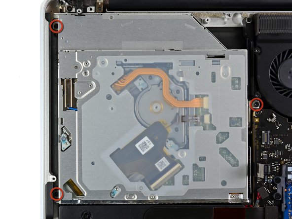

Remove the three 3.5 mm T6 Torx screws securing the optical drive to the upper case.
I actually found this section to be the most difficult, the T6 screws are soft as butter, apply plenty of pressure when removing. The one towards the front of the laptop looking from the back is the most problematic.

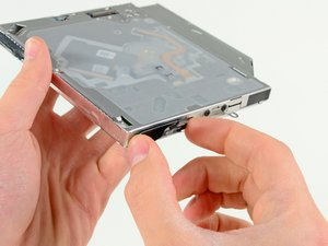

Lift the optical drive near its connector and pull it away from the upper case to remove it from the computer.
Pull the optical drive cable out of the optical drive.

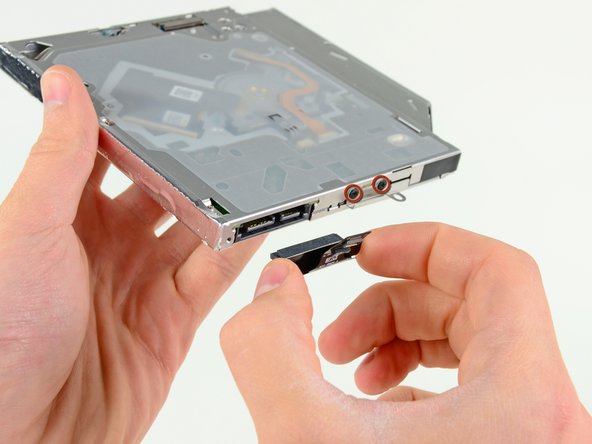

Remove the two black Phillips #0 screws securing the small metal mounting bracket. Transfer this bracket to your new optical drive or hard drive enclosure.
