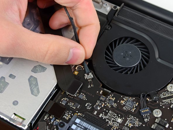

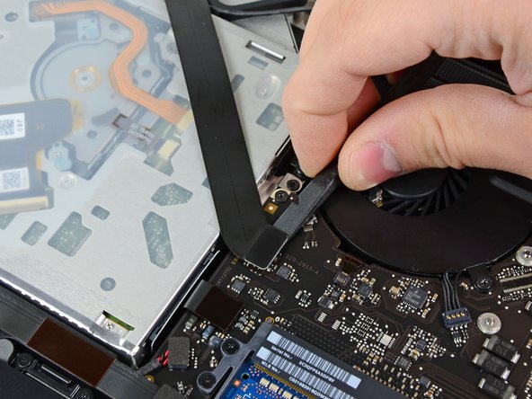

Image 1/1:
  • Bend the battery cable slightly away from its socket on the logic board so it does not accidentally connect itself while you work.
Image 1/1: Pull the cable parallel to the face of the logic board toward the optical drive opening.
  • Pull the camera cable connector straight out of its socket on the logic board.
  • Pull the cable parallel to the face of the logic board toward the optical drive opening.
This step did not provide enough direction and is the reason my cable is either broke/not working now. I tried pulling it out of the logic board, as indicated, but it did not budge. I was extremely careful not to damage it, so I gave up on trying to remove it once I saw that it wasn't moving. Lo and behold, once I fired the Macbook up again, the camera is no longer connected. This step should have additional details/explanation as to why the cable may not come out/what to do if it doesn't (I was able to proceed to the next steps by working around the cable, so it didn't even have to be removed as the guide might have you think).
Does anyone know how to properly fix it/where to buy a replacement camera/iSight cable? I would like to fix this if possible.
jackalbert - Reply

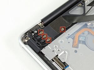

Image 1/2: Image 2/2:

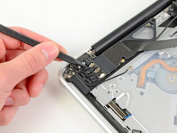

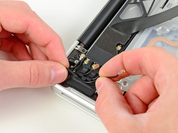

  • Use the tip of a spudger to pry the four antenna connectors up from their sockets on the AirPort/Bluetooth board.
I found the problem with my wifi: sadly the connector solder joint j4 of the wifi board was not stable enough. now the socket is inside of the connector and not joined with the board. How do I remove the socket from inside of the connector? Is this even possible?
Bodo Tasche - Reply

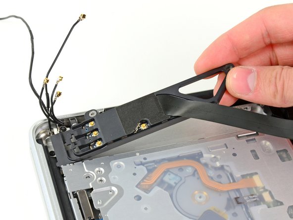

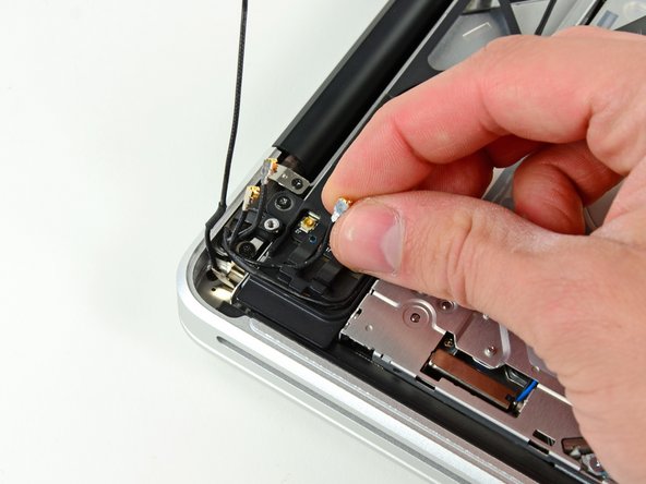

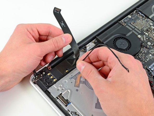

Image 1/3: De-route the camera cable from its channel in the AirPort/Bluetooth housing. Image 2/3: De-route the camera cable from its channel in the AirPort/Bluetooth housing. Image 3/3: De-route the camera cable from its channel in the AirPort/Bluetooth housing.
  • De-route all four antenna cables from their channels in the AirPort/Bluetooth housing.
  • De-route the camera cable from its channel in the AirPort/Bluetooth housing.

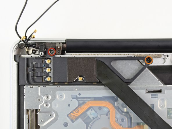

Image 1/1: One 8.6 mm Phillips screw
  • Remove the following two screws securing the AirPort/Bluetooth assembly to the upper case:
    • One 8.6 mm Phillips screw
    • One 3.9 mm Phillips screw
I want to know Lot No. of " 3.9 mm Phillips screw" Step 9.
That was broken... :( Is there anyone who can help me?
YoungWook Jo - Reply
the same problem, do you know which size the screw is??
adambartusz91 -
Looking for replacement screws for the Airport/Bluetooth module. The head stripped and I was able to successfully remove the damaged screw but now I need a replacement. If I could get the part number for the screws I could probably order it. It's the screw on the right in step 9.
MacGyver - Reply
MacGyver, how did you finally remove that screw? Same problem here.
Heinz -
Also curious. Both screws are stripped on mine.
Marc Opperman -

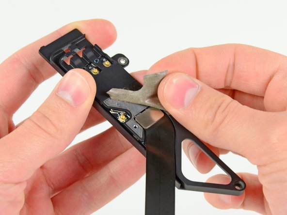

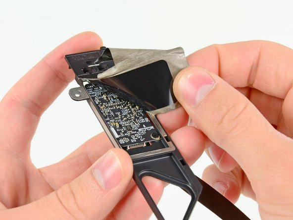

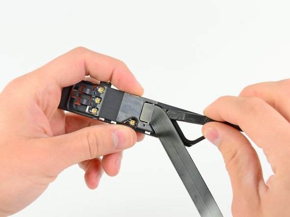

  • Peel and remove the piece of EMI tape wrapped around the AirPort/Bluetooth assembly.
Where can I get a new piece of EMI tape wrapped around the AirPort/Bluetooth assembly?
Rusty - Reply
Use a blade to pick up this tape as it easily tears. Take your time with it and stick it to a clean plastic surface so it doesn't curl. It'll then go back on OK. I suggest you replace with the longest edge first and carefully wrap the tape back on when replacing.
Rich Moog - Reply

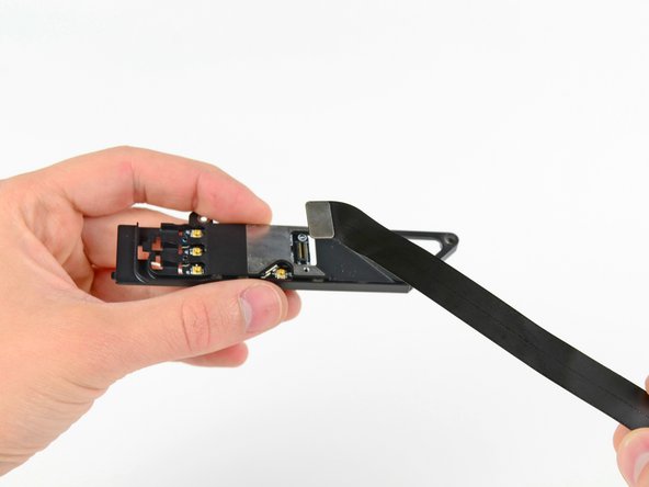

Image 1/2: Remove the AirPort/Bluetooth cable from the AirPort/Bluetooth assembly. Image 2/2: Remove the AirPort/Bluetooth cable from the AirPort/Bluetooth assembly.
  • Use the flat end of a spudger to pry the AirPort/Bluetooth cable away from its socket on the AirPort/Bluetooth board.
  • Remove the AirPort/Bluetooth cable from the AirPort/Bluetooth assembly.

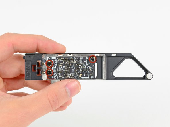

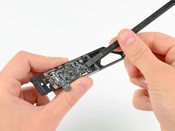

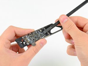

Image 1/2: Use the flat end of a spudger to dislodge the AirPort/Bluetooth board from its recess in the AirPort/Bluetooth board housing. Image 2/2: Use the flat end of a spudger to dislodge the AirPort/Bluetooth board from its recess in the AirPort/Bluetooth board housing.
  • Remove the three Phillips screws securing the AirPort/Bluetooth board to the AirPort/Bluetooth board housing.
  • Use the flat end of a spudger to dislodge the AirPort/Bluetooth board from its recess in the AirPort/Bluetooth board housing.

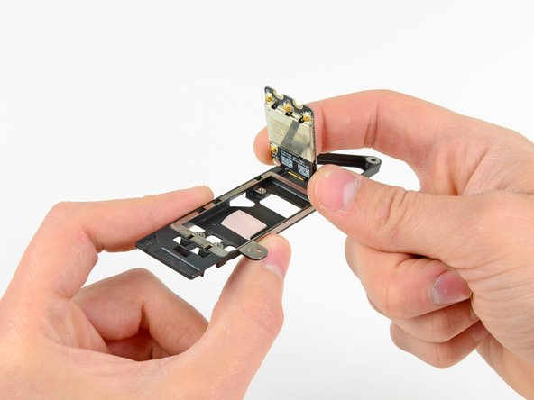

Image 1/1:
  • Remove the AirPort/Bluetooth board from its aluminum housing.

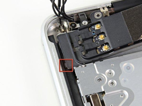

  • Before securing the AirPort/Bluetooth bracket to the upper case, be sure the small tab on its left edge is inserted into the small void cut into the black plastic optical drive opening.
