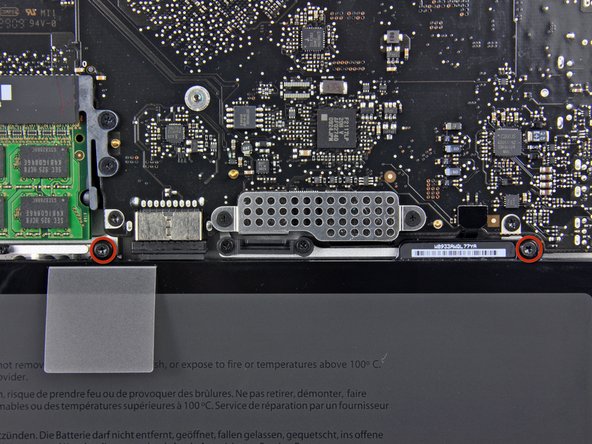

Image 1/1:
  • Remove the two exposed five-point Pentalobe screws along the top edge of the battery.
The screws holding my battery were all worn out since an earlier removal. So instead of ruining them even more I put some saran wrap on the tip of my pentalobe driver and gently unscrewed them.
magnus - Reply
I have a problem with these screw. They a completly warn and I need some new ones to fix the new Battery.
Does anyone know which thread it is and which length?
alexanderleith - Reply

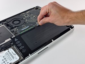

  • Lift the battery by its plastic pull tab and slide it away from the long edge of the upper case.
  • Do not try to completely remove the battery just yet.
Image 1/1: Pull the battery cable connector away from its socket on the logic board and remove the battery from the upper case.
  • Tilt the battery back enough to access the battery cable connector.
  • Pull the battery cable connector away from its socket on the logic board and remove the battery from the upper case.

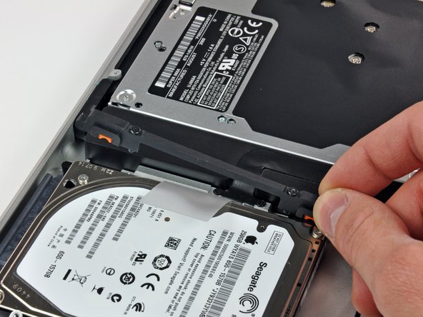

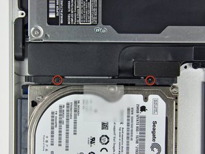

Image 1/2: These screws are captive to the hard drive bracket. Image 2/2: Lift the the retaining bracket out of the upper case.
  • Remove two Phillips screws securing the hard drive bracket to the upper case.
  • These screws are captive to the hard drive bracket.
  • Lift the the retaining bracket out of the upper case.

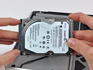

Image 1/1:
  • Lift the hard drive by its pull tab and pull it out of the chassis, minding the cable attaching it to the computer.

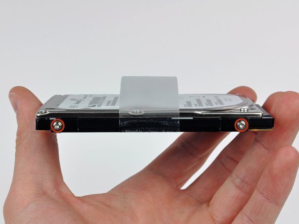

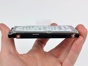

Image 1/2: You'll need to transfer these screws to your new hard drive if you're changing drives. Image 2/2: If you are installing a new hard drive, we have an [guide|751|OS X install guide] to get you up and running.
  • Remove two T6 Torx screws from each side of the hard drive (four screws total).
  • You'll need to transfer these screws to your new hard drive if you're changing drives.
  • If you are installing a new hard drive, we have an OS X install guide to get you up and running.

The guide states you must remove the battery in order to replace the hard drive. This is incorrect- it is merely a safety precaution. If you do not have the specific pentalobe screwdriver, DO NOT ATTEMPT THIS. I just replaced a hard-drive in one of these macs, that someone had already stripped the screw head. The screws are tapered too, so no getting it out once stripped.
The battery does not interfere with this repair, so simply remove the two screws on the hard-drive bracket (step 8), replace the drive then put the mac back together.
squarefrog - Reply

Actually I could just lift the battery connector without removing the battery at all. Worked out fine for me.
hanshans - Reply

Removing the battery connector was hard to do with finger force alone, I had to entice it with a flat head screw driver. Getting the full iFixIt toolkit gives you all of the tools except the spudger which really could be improvised with something else.
jmeredith - Reply
