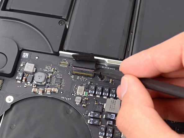

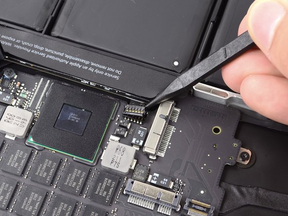

Peel back the warning label covering the battery connector.
Have laptop charging issues after this. When fully charged and i plug in magsafe it starts with green, then turns red and stays red (like if it was charging). Status bar says NOT charging. If i use battery a little bit (down to 69%) magsafe does the same (green then stay red). Status bar says battery 69% NOT charging. and it seems to be true. Any suggestions?
Double check the connection from the battery to the logic board and the logic board socket itself... Might have damaged by disconnect/reconnect.
Using the flat end of a spudger, gently pry the battery connector straight up out of its socket on the logic board.
Bend the battery cables back and out of the way, ensuring that the battery connector doesn't accidentally make contact with the logic board.

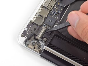

Use the tip of a spudger to pry the three AirPort antenna cables straight up off of their sockets on the AirPort board.

These are notoriously difficult to remove. I actually damaged 2/3 of the connector pins during the process. Thankfully i was still able to fit them in place. This step should not be underestimated.
I damaged 1/3 of these litte guys, how did you get them back together?!
is there a way to replace the antenna?
unless you have really tiny fingers, a tweezer helps, just be careful not to damage the wires or the board as your holding each cable in place. Oh and take your time - this is like the most frustrating step in the process, imo.
Definitely the hardest step (when putting it back together). The three pins were on progressively longer plugs, so I put the shortest one on the left and so on. This helps with getting the right angle. I used my fingers and the spudger to guide them back in. It took me easily 10-15 minutes to do this. The pattern that worked eventually was to first adjust the angle of the pin head so that it's x/y/z axes would line up perfectly with the connection if you are able to bring it together just so. If you're off on any of these while you try to bring it together, you won't be able to just click it down at the end. Good luck!
Removing these 3 tiny cables is completely unnecessary. I removed my fan last week to clean and it slips by these cables. For some dumb reason i wanted to follow this "correct" procedure and now one of the gold connections detached from the wire like it was nothing. Seriously, dont do this. I used a spunger and was very delicate putting it back on... And look what happened. SKIP!
travismlive is right, you do not need to remove these cables or the airport card. Just remove the I/O board cable, undo the screws, and detach the antenna cables from the fan where they are glued with a spudger. Unlock the ZIF-socket and the you can wriggle the fan out. Probably saved my airport card, thanks travismlive!
I only successfully reattached 1 of the 3 AirPort cables, I just taped the other two. But the AirPort seems to work fine. Do these also have anything to do with Bluetooth though? I do seem to have trouble with Bluetooth after this operation. In any case, it was worth it... I replaced the screen with a new Apple screen for less than 1/2 the Apple Store wanted! Thanks!
Would soldering them back in place be better than taping? I certainly don't want spare solder on my motherboard, so I figure that'd be a last resort only if I lose AirPort connectivity.

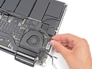

Insert the flat end of a spudger underneath the rubber heat sink cover on the right fan.
Slide the spudger underneath the length of the cover, releasing the adhesive.
Lift the cover and flip it back so that you can access the cables underneath.
Use your fingers to pull the AirPort/Camera cables up off the fan.
Carefully de-route the cables from the plastic cable guide.

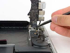

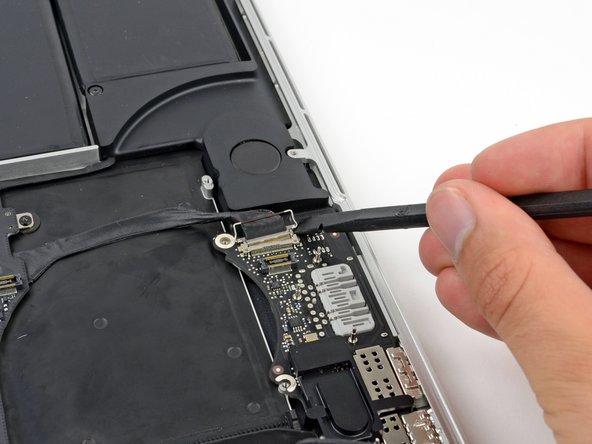

Using the flat end of a spudger, pry the I/O Board connector straight up out of its socket on the logic board. On reassembly, connect this end first as it does not flex.
In a similar fashion, remove the I/O Board connector from its socket on the I/O Board.
Remove the I/O Board cable from the MacBook Pro.

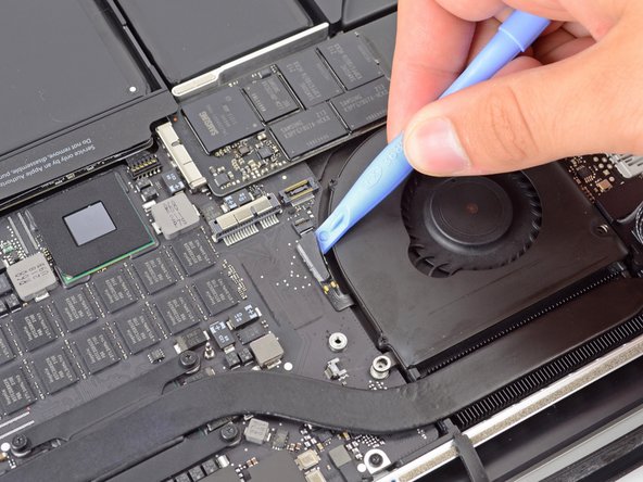

Use the tip of a spudger to flip up the retaining flap on the right fan ribbon cable ZIF socket.
Starting at the top of the cable, slide a plastic opening tool under the right fan cable to free it from the logic board.
I was able to flip the retaining flap while removing the damaged fan but accidentally dislodged after installing the replacement fan. Again, be very careful at this stage. Thankfully my new fan appears to function normally.

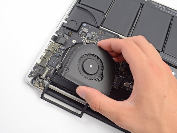

Remove the following three screws securing the right fan to the logic board:
One 4.4 mm T5 Torx screw
One 3.9 mm T5 Wide Head Torx screw
One 5.0 mm T5 Torx screw with 2 mm collar
Lift and remove the right fan out from the MacBook Pro.

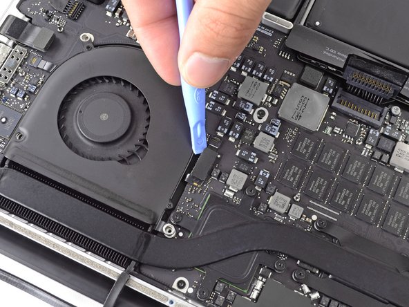

Use the flat end of a spudger to lift the rubber heat sink cover up off the left fan.
This came of super easy as the glue seemed to have dried up or something of that nature; anyone know if this is an issue?
Also it seemed like there are clips on sides of the rubber heat sink which I couldn't work out how to clip it back on, so I placed it back where it was after and it seems to be ok; maybe it isn't meant to clip on hard and rather just to be a security measure. Anyone else had this?

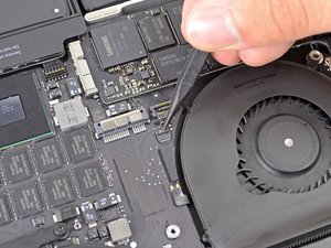

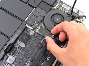

Remove the single 3.1 mm T5 Torx screw securing the SSD to the logic board.
When I got to this step I realized the screw was stripped. I'm unsure if it was stripped by my efforts -- I used the prescribed P5 screwdriver that was also used for the other screws, and the screwdriver still works when putting the lid back on.
So to extract the stripped screw in Step 5 I've ordered iFixit's Precision Screw Extractor Set.
Now I'm wondering if I also need to find a replacement screw since I probably won't be able to use the stripped one again after it's been extracted? The screw is called: 3.1 mm T5 Torx screw as per this guide .. the best I can find on eBay are screws called: 1,4 X 3,1 mm Torx T5 or 1,5 X 3,1 mm Torx T5 ... will one of these work? Would I be able to just go to a hardware store and find the proper screw or is it a specialty item?
I'm sure you've long since figured it out, but for the benefit of anyone else reading this, a P5 is not a T5. It's a different screwdriver. The driver for the screws on the outside of the case will not work on the screw holding the SSD. I'm not sure why they left it off in the list of tools at the top.
For the Macbook Pro Retina 15" Late 2013 models, I've heard the SSD is soldered to the logic board. This guide is for that model, but it doesn't address the soldering issue. Have I just been misinformed on this issue? Has anyone tried it with the late 2013 model yet?
The SSD is not soldered to the board. You maybe thinking of the RAM which is soldered. (thank you apple) *dripping sarcasm*
I was needing to send my mid 2014 15" MacBook Pro in for a keyboard repair, and my company IT department shipped me a loaner of the same model except that it had a smaller SSD in it than mine, and said I should swap the SSDs between the two and then send mine back with the smaller drive in it to get fixed. I've been unable to swap the drives because neither mine nor the loaner (which are both the same model) appear to have a T5 screw holding the SSD in place. Both of them appear to have a T4, not a T5 (whatever it is is smaller than a T5 anyway, so I'm guessing it's a T4). So now I'm on hold until I can find a T4 screwdriver.
OK, got the new tool set, and yes, it really is actually a T5 screw, you just need a really sharp driver. My existing T5 driver was getting a little dull on the tip. So make sure you have a really new/precision T5 driver/bit to use (and again I'll point out that ifixit failed to list this tool in the list of needed tools at the top).

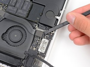

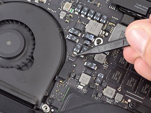

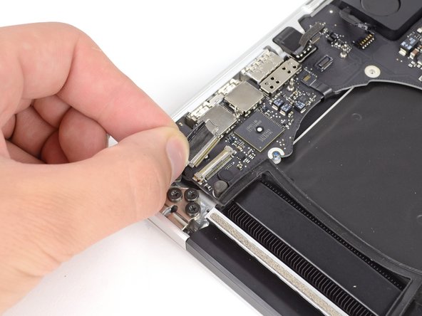

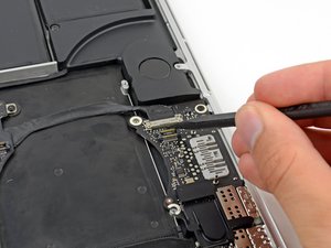

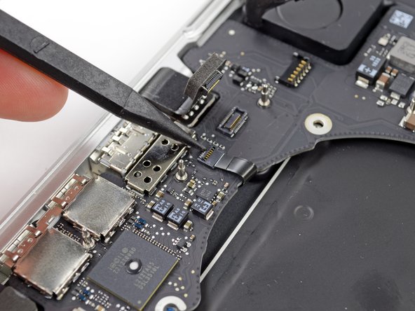

Use the tip of a spudger to flip up the I/O board data cable lock and rotate it toward the battery side of the computer.
Use the flat end of a spudger to slide the I/O board data cable straight out of its socket on the logic board.
This is a difficult step. A few images for the removal of the cable would be good/better

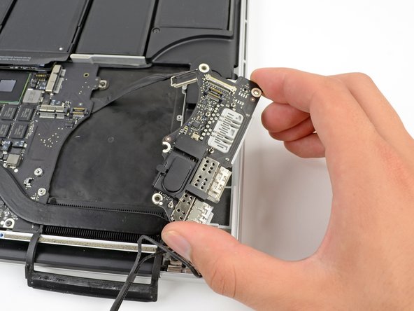

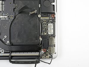

Remove the two 3.1 mm T5 Torx screws securing the I/O board to the logic board.
Carefully lift the I/O board and remove it from the lower case.

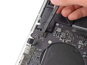

Use the flat end of a spudger to pry the headphone jack connector up from its socket on the logic board.
Use the flat end of a spudger to pry the left speaker connector up and out of its socket on the logic board.
Use the tip of a spudger to pry the right speaker connector up and out of its socket on the logic board
This step could use an image showing the cable lock in the "up" position, releasing the connector. It is hard to see how it works in the "down" position. I think this is the actual connector - there are images in the PDF linked here:

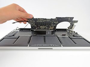

Lifting from the side nearest the battery, rotate the logic board toward the top of the MacBook Pro.

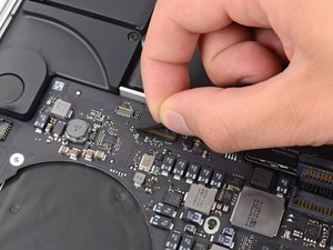

Using the flat end of a spudger, carefully push the MagSafe 2 connector out of its socket on the bottom of the logic board.
Remove the logic board assembly from the MacBook Pro.

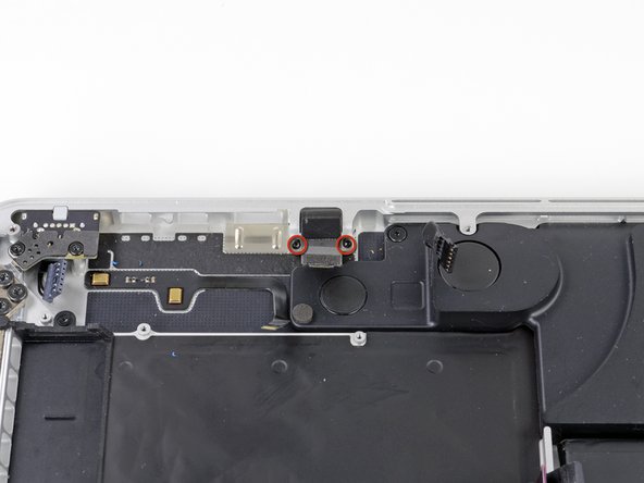

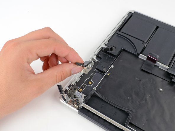

Remove the two 3.6 mm T5 Torx screws securing the headphone jack to the upper case assembly.
Slide the headphone jack away from the upper case.
Lift and remove the headphone jack out from its recess in the upper case.
