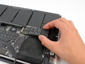

  • Remove the single 3.1 mm T5 Torx screw securing the SSD to the logic board.
When I got to this step I realized the screw was stripped. I'm unsure if it was stripped by my efforts -- I used the prescribed P5 screwdriver that was also used for the other screws, and the screwdriver still works when putting the lid back on.
So to extract the stripped screw in Step 5 I've ordered iFixit's Precision Screw Extractor Set.
Now I'm wondering if I also need to find a replacement screw since I probably won't be able to use the stripped one again after it's been extracted? The screw is called: 3.1 mm T5 Torx screw as per this guide .. the best I can find on eBay are screws called: 1,4 X 3,1 mm Torx T5 or 1,5 X 3,1 mm Torx T5 ... will one of these work? Would I be able to just go to a hardware store and find the proper screw or is it a specialty item?
Lorte Messenger - Reply
I'm sure you've long since figured it out, but for the benefit of anyone else reading this, a P5 is not a T5. It's a different screwdriver. The driver for the screws on the outside of the case will not work on the screw holding the SSD. I'm not sure why they left it off in the list of tools at the top.
Dave Miller -

I was needing to send my mid 2014 15" MacBook Pro in for a keyboard repair, and my company IT department shipped me a loaner of the same model except that it had a smaller SSD in it than mine, and said I should swap the SSDs between the two and then send mine back with the smaller drive in it to get fixed. I've been unable to swap the drives because neither mine nor the loaner (which are both the same model) appear to have a T5 screw holding the SSD in place. Both of them appear to have a T4, not a T5 (whatever it is is smaller than a T5 anyway, so I'm guessing it's a T4). So now I'm on hold until I can find a T4 screwdriver.
Dave Miller - Reply
OK, got the new tool set, and yes, it really is actually a T5 screw, you just need a really sharp driver. My existing T5 driver was getting a little dull on the tip. So make sure you have a really new/precision T5 driver/bit to use (and again I'll point out that ifixit failed to list this tool in the list of needed tools at the top).
Dave Miller -

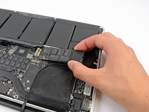

Image 1/2:
  • Slightly lift the rightmost side of the SSD and firmly slide it straight away out of its socket on the logic board.

According to Everymac (http://www.everymac.com/systems/apple/ma...) this would not be possible for late 2013 15" retina models, with PCIe based SSD. So, will these steps also apply to that model? Just want to be really sure!
Levi
Levi - Reply
I read the whole article, and from what you have written i hope you meant about this part.
"Specifically, the "Mid-2012" and "Early 2013" models use a 6 Gb/s SATA-based SSD whereas the "Late 2013" and "Mid-2014" models use a PCIe 2.0-based SSD. These SSD modules are neither interchangeable nor backwards compatible."
If so it means you can not use an SSD meant for "Mid-2012" and "Early 2013" for a laptop of "Late 2013" and "Mid-2014" or vice-versa, they are still removable and replaceable but please do make sure that the replacement is intended for the model that you have.
Abbas Mustafa Bhaijibhai -
