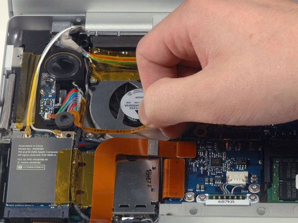

Image 1/1:
  • Lift the lift fan up and carefully peel up the tape securing the fan to the heat sink as you go.
The tape you peel up may no longer be sticky enough when putting it down on a replacement fan. I used some electrical tape cut to size to redo the seal.
cgollner - Reply
The ring at the top which holds the top screw appeared to be underneath the same ring for the speaker and this made it really tricky to remove the fan.
You really have to get the right angle. Persevere as it will come away with some gentle encouragement.
Be sure to transfer the black tape to the new unit or else replace it with electrical tape.
Joshua May - Reply
