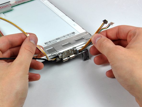

Image 1/2: Carefully peel the camera cable off the foam tape along the top edge of the LCD. Image 2/2: Carefully peel the camera cable off the foam tape along the top edge of the LCD.
  • Remove the pieces of tape covering the display data cable and camera cable connectors.
  • Carefully peel the camera cable off the foam tape along the top edge of the LCD.
Image 1/2: Pull the display data cable connector away from its socket on the LCD. Image 2/2: Pull both cables parallel to the face of the logic board.
  • Gently pull the camera cable away from its socket on the camera board.
  • Pull the display data cable connector away from its socket on the LCD.
  • Pull both cables parallel to the face of the logic board.
Image 1/2: If you have a Core 2 Duo Model A1211 machine, refer to picture 2 and remove two Phillips screws connecting the clutch assembly to the lower edge of the front display bezel near the display data cable. Image 2/2: If you have a Core 2 Duo Model A1211 machine, refer to picture 2 and remove two Phillips screws connecting the clutch assembly to the lower edge of the front display bezel near the display data cable.
  • If you have a Core Duo machine, refer to picture 1 and remove three Phillips screws connecting the clutch assembly to the lower edge of the front display bezel near the display data cable.
  • If you have a Core 2 Duo Model A1211 machine, refer to picture 2 and remove two Phillips screws connecting the clutch assembly to the lower edge of the front display bezel near the display data cable.
Image 1/1: Remove the small rectangular steel bracket by sliding it away from the right clutch hinge.

Image 1/1:
  • De-route the inverter/camera cable from the left clutch hinge and remove it from the display.
monumentally poor photograph here. refer back to step 12 for an idea of how much of the mesh shielded section of the inverter/camera cable to leave sticking out past the clutch body, its a good 4-5mm more than shown in this photo (which i discovered only after working back from steps 34 to 18. not happy with the quality and level of detail of these instructions at all.
