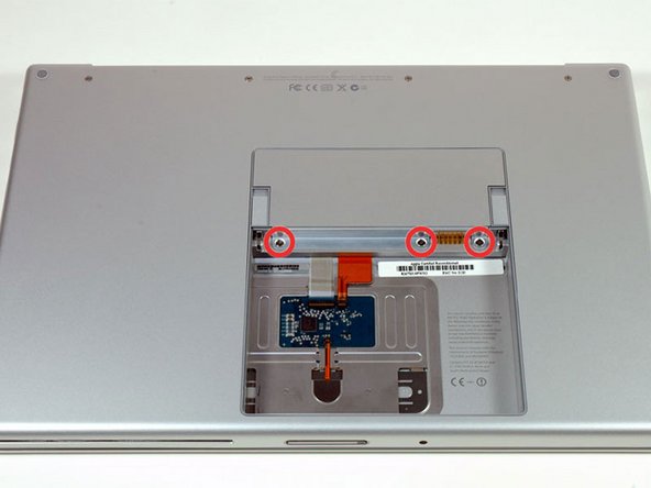

  • Remove the two 2.8 mm Phillips screws in the battery compartment near the latch.
Image 1/1: Two 10 mm T6 Torx screws on either side of the RAM slot.
  • Remove the following 6 screws:
    • Two 10 mm T6 Torx screws on either side of the RAM slot.
    • Four 14.5 mm Phillips screws along the hinge.

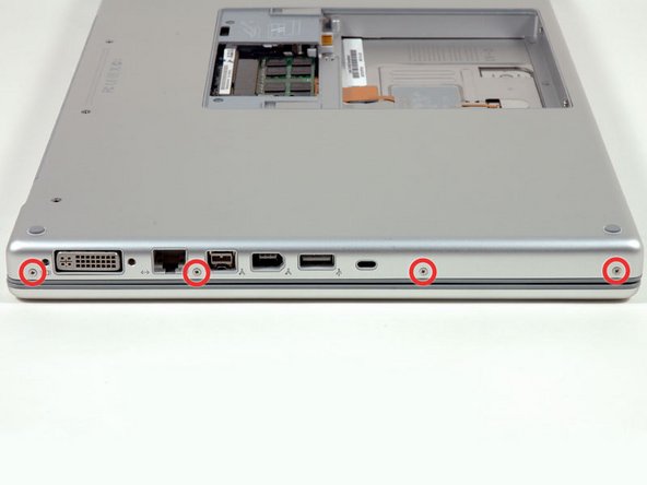

  • Remove the four 3.2 mm Phillips screws on the port side of the computer.
"port side of the computer" should read "starboard side". It's on the right-hand side when the computer is positioned normally in front of you.
joeycoole - Reply
Port side as in I/O port side, as in the side that has the FireWire and ethernet ports. This is a MacBook, not a sailboat ;)

  • Rotate the computer 90 degrees and remove the two 3.2 mm Phillips screws from the rear of the computer.
Image 1/1:
  • Rotate the computer 90 degrees again and remove the four 3.2 mm Phillips screws from the side of the computer.

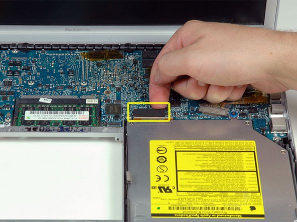

  • Disconnect the orange SuperDrive ribbon cable from the logic board, removing tape as necessary.

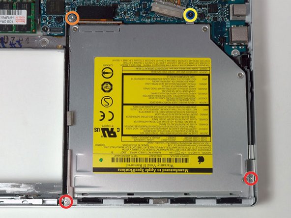

  • Remove the following 4 screws:
    • Two 3.3 mm silver Phillips screws on either side of the SuperDrive.
    • One 4.7 mm silver T6 Torx screw from the top left corner of the drive
    • One 6.2 mm black Phillips screw at the top right corner of the drive.
Regarding the following instruction: -
Be aware there are two of these on the bottom (if the slot is facing you) screws close to each other, one is for the actual drive assembly itself and the other is attaching the drive to the Mac. Beware you choose the correct one.
Lucifer - Reply

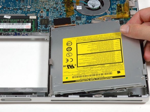

Image 1/1:
  • Lift the optical drive up and out of the computer.

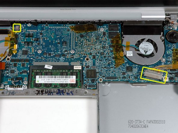

  • Disconnect the hard drive and ExpressCard connectors from the left side of the logic board.
Image 1/1:
  • Disconnect the iSight and display data cables from the logic board by sliding the cables out of their connectors, removing tape as necessary.
Image 1/1:

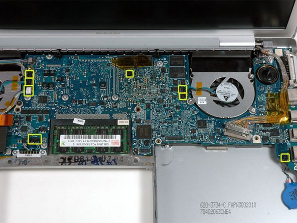

  • Disconnect the eight indicated connectors by placing a spudger beneath each cable and lifting up.
Be careful when putting the logic board back into place, you can easily overlook the small cable that fits at the top, otherwise you have the frustrating experience of having to remove all the screws again!
sfuseau - Reply
On putting this back together, I'm finding the small upper cable that presumably is battery monitoring (lower left hand corning of the picture) is not staying in place (I'm using the one that shipped with the lower tray, not the original). I'm thinking either some of the anti-static tape, or a rebending of the wires to help apply continuous pressure. I had to take the top off one already as a consequence of this, as it wouldn't power-up on battery alone, and the next day, the problem appears to have returned.
schurger - Reply

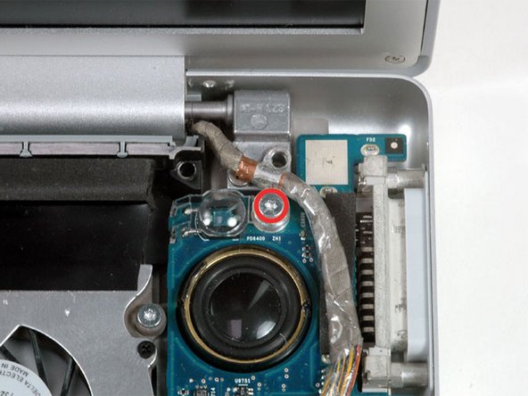

  • Remove the silver T6 Torx screw securing the ground loop in the display data cable to the casing.
Image 1/1: Lift the clear plastic shield off the right ambient light sensor.
  • Remove the single T6 Torx screw securing the clear plastic shield over the right ambient light sensor.
  • Lift the clear plastic shield off the right ambient light sensor.

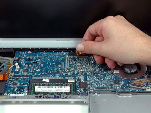

  • Peel up the orange Kapton tape securing the right thermal sensor cable to the logic board.

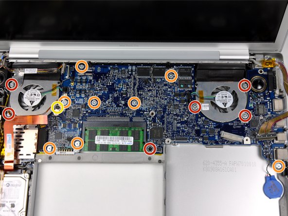

Image 1/1: One 4.4 mm black Phillips screw to the right of the ram slot.
  • Remove the following 15 screws:
    • One 4.4 mm black Phillips screw to the right of the ram slot.
    • Eight 4.7 mm silver T6 Torx screws securing the logic board to the lower case.
    • One 6.2 mm black T6 Torx screw on the right side of the left fan.
    • Five 9.4 mm silver T6 Torx screws securing the left and right fans.
In the diagram, the yellow circle and the orange next to it should be swapped. The black screw won't even grasp the threads in the indicated hole.
Monica Anderson - Reply
where the foto of step 20??!! (
kohaua - Reply
The five red rings indicating the screws on the left and right fan should be green not red.

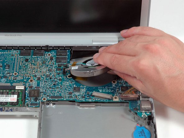

Image 1/1: Place the fan above the Airport card. It is not necessary to remove the fan from the computer entirely.
  • Hold the logic board down with one hand and use your other hand to lift the left fan up from its housing. There is a piece of black tape securing the fan to the heat sink. Carefully peel this tape up from the heat sink as you lift the fan up.
  • Place the fan above the Airport card. It is not necessary to remove the fan from the computer entirely.

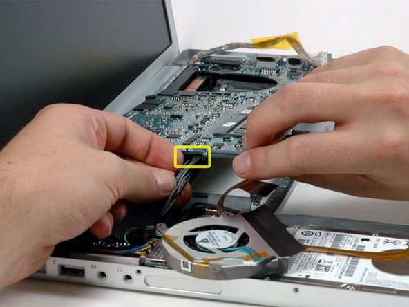

Image 1/1:
  • Lift up the left side of the logic board and disconnect the gray and black power cable from the bottom of the board.

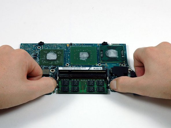

Image 1/1: Pull the chip directly out from its connector.
  • Release the tabs on each side of the RAM chip at the same time. These tabs lock the chip in place and releasing them will cause the chip to "pop" up.
  • Pull the chip directly out from its connector.
  • If there are two RAM chips installed, repeat the above procedure for the second chip.
