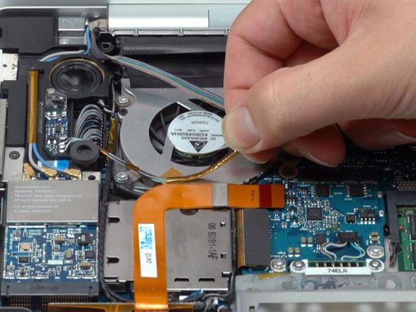

Do not yank the upper case off quickly. The case is attached to the logic board via a ribbon cable.
Lift up at the rear of the case and work your fingers along the sides, freeing the case as you go. Once you have freed the sides, you may need to rock the case up and down to free the front of the upper case (there are some hidden plastic clips that need to be clicked off).

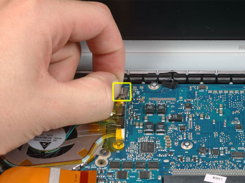

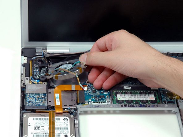

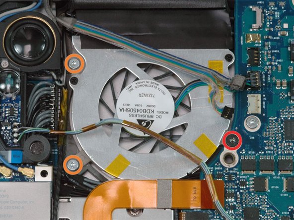

what a money saver and life saver. iFixit is awesome! Have to admit though you need to be fearless to open up your computer and take a chance. Be VERY careful with the connectors, and know how they are connected or they will break. The iSight cable pulls out to the left, but DONT pull on the wires. Use the spudger to wiggle out the metal tabs on the connector. Don't lift up on the connector. And the heat sink tape doesn't come off that easiy either. Once you pull the front of the fan upright so it's on it's edge, then use the spudger and go behind to pull the black tape off SLOWLY. And while you're reaching over those delicate prts, make sure you don't bang down on some resistor or other part. It's a thrill when you put it back together and you DON'T HEAR A THING! The fan is QUIET. Didn't realize how loud it was getting.
I finally got around to replacing both my fans. I had tried cleaning and putting drop of WD40 on the post of each one. They worked, but were noisy. Now I have replaced both fans and the computer is absolutely quiet(as far as I can tell) And cooler too. I went ahead and upgraded to 10.7(the highest OS it will take), so it is like I have a new computer. Thanks, ifixit
