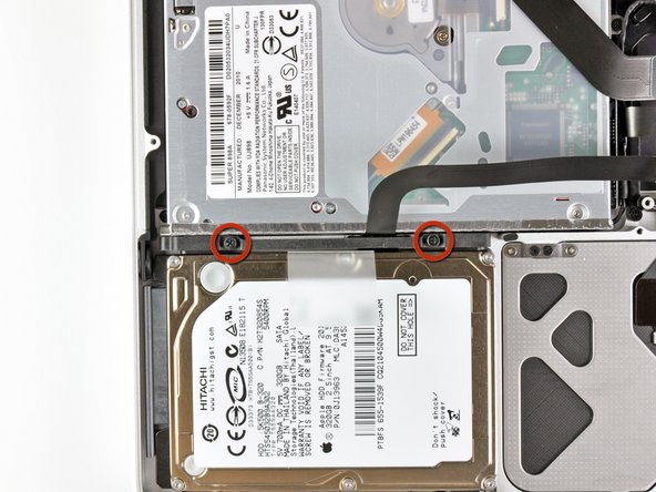

Image 1/1: Three 14.4 mm Phillips #00 screws
  • Remove the following ten screws:
    • Three 14.4 mm Phillips #00 screws
    • Three 3.5 mm Phillips #00 screws
    • Four 3.5 mm shouldered Phillips #00 screws

Tip: Use one of those weekday pill holders to have a cheep way to store screws you remove and each day of the week can be for different sizes or parts. It has been handy to have (much less expensive than the magnetic mat.
Robert Wacker - Reply
Great tutorial. I found that using a Phillips #0 in lieu of the #00 worked much better.
kschmesk - Reply
I tried the PH #00 for the 10 screws that hold the bottom case and it's too big, instead PH #000 works perfectly. Are you sure this screws are #00?
Alex - Reply

I have found that my MacBook Pro 13 Late 2011 has five shouldered screws and not four. I am not sure exactly where it goes but I have put it in the top left corner of the picture as it is the odd one out.
GotMac - Reply
Hello, where can I buy the screws I need in case I lose one of them?
taylornya - Reply
on my device the #00 screwdriver was a bit too small. a #0 was the perfect one
Maximilian Klotz - Reply
I found with mine that the shouldered and un-shouldered screws were reversed (the three un-shouldered screws going where the orange colour indicates). Also, I found that the front four screws went in at an angle.
gilded yak - Reply

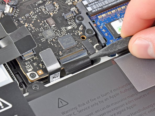

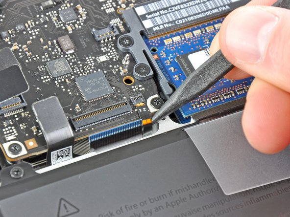

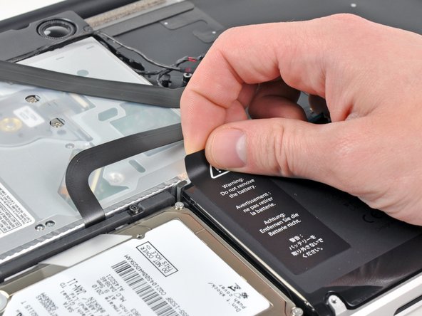

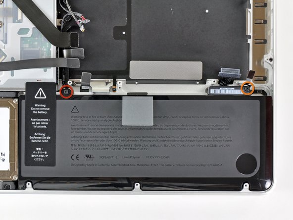

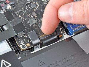

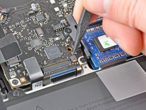

Image 1/2: It is useful to pry upward on both short sides of the connector to "walk" it out of its socket. Be careful with the corners of the connectors, they can be easily broken off. Image 2/2: It is useful to pry upward on both short sides of the connector to "walk" it out of its socket. Be careful with the corners of the connectors, they can be easily broken off.
  • Use the edge of a spudger to pry the battery connector upwards from its socket on the logic board.
  • It is useful to pry upward on both short sides of the connector to "walk" it out of its socket. Be careful with the corners of the connectors, they can be easily broken off.
Is this step of removing the battery connector required?
manodh - Reply
yes - as with disassembly of any electronic component you have to remove any power source. You don't want to accidentally turn the Mac on
khull -
This step is not really required. Apple does not recommend it.
Steven Layton - Reply
My Battery does not get recognized after i disconnected it, screw this site!
Diego Hernandes -
Rather than be careful of the corners of the connector i would say don't use the spudger anywhere near the corners. While the corner looks like the obvious place to begin to pry it up from, it will break. Levering from the sides as the instructions suggest works well.
ausmkv - Reply
wonder why apple does not recommend it?!
Peter - Reply
I would recommend it, one careless short and the whole board is dead......
John - Reply
simply remove the battery rather than disconnecting the cable
toiu - Reply
Don't know what the deal is with the battery, but this IS a necessary step to keep from frying the logic Board if you accidentally touch something and short it out. I did this step every time during my troubleshooting and The battery was ALWAYS recognized by the system the next time I turned the MBP on. So be safe and don't fry your logic board in the process...
fasthans - Reply
Prying the battery connector off does not take much force. I did exactly what the guide suggested (walked it off back and forth) with the spudger without any problems. Just be very gentle, much like with anything inside laptops, they are very fragile and need to be worked with carefully. A+ instructions, battery replacement was a success.
aekinaka - Reply
Installed/upgraded 4gb RAM to the system maximum 16gb and installed a 500 gb SSD today....DID NOT disconnect the battery cable....no issues at all when I powered back up. Then did a clean install of OSX Yosemite....next I used a time machine backup to put all my stuff back on the new HD. From start to finish it took about 4 hours. Macbook boots up right at 16 seconds now.
MacProUser - Reply
Easiest to use two spudgers, one on each short end, I found.
Simon Mundy - Reply
I took off th Airport /Bluetooth connectors but the number J3 connector is broken and so where can i buy J3 connecter for the Airport/bluetooth board
Zeerachen - Reply
Its a lot easier and safer (corner wise) to pry it using the flat side of the black spudger directly in front of the connector (don't go/use the corners) very easily you will be able to pry it further by inserting the spudger into a better and thicker plastic section of the connector
Ed Oliver - Reply
DON'T remove the Battery Cable, you risk the battery NOT being recognised when you start the Mac up again, or breaking it!! More to the point, APPLE DOES NOT RECOMMEND THIS, so don't do it! I Installed 2x 8GB ( 16Gb total) of Crucial Mac RAM at 1333Mhz for my Late 2011 MacBook Pro, and it works beautifully, fully recognised and working well. I followed these instructions, but as Apple didnt recommend disconnecting the battery, I skipped this step, and as well as taking less time, nothing was damaged or broken, and everything works perfectly!!! Just make sure that you DISCHARGE ALL STATIC ELECTRICITY FROM YOUR HANDS, by touching a metal surface in the Mac. Apple recommends the edge of the Optical Disk Drive ( Big silver thing ) before touching any parts. Also, Take care removing the RAM out of its packet, DO NOT touch the Gold connectors, and hold the RAM by the edges. Finally, be PATIENT, GENTLE and it should all go perfectly. I managed it first time, with no technical ability, so follow my advice. Good luck!
Bradley Marks - Reply
Followed the tuto Step by step. Disconnected the battery (quite easily).
No problem when I lit the Mac on again. Battery's here, date's right.
nichoferr - Reply

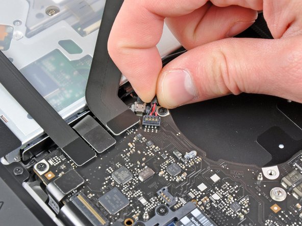

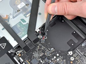

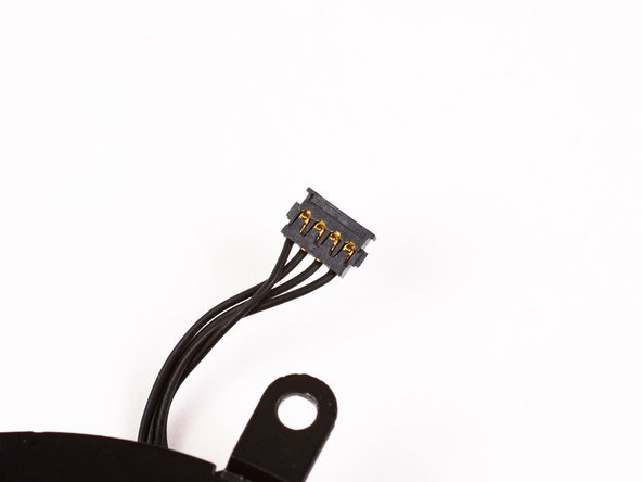

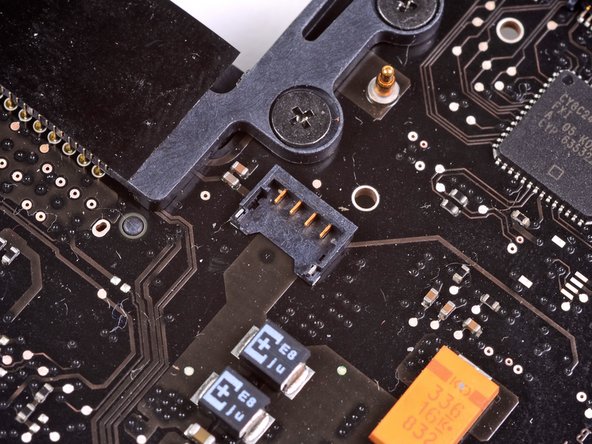

Image 1/3: It is useful to twist the spudger axially from beneath the fan cable wires to release the connector. Image 2/3: The fan socket and the fan connector can be seen in the second and third pictures. Be careful not to break the plastic fan socket off the logic board as you use your spudger to lift the fan connector straight up and out of its socket. The layout of the logic board shown in the second picture may look slightly different than your machine but the fan socket is the same. Image 3/3: The fan socket and the fan connector can be seen in the second and third pictures. Be careful not to break the plastic fan socket off the logic board as you use your spudger to lift the fan connector straight up and out of its socket. The layout of the logic board shown in the second picture may look slightly different than your machine but the fan socket is the same.
  • Use the edge of a spudger to gently pry the fan connector up and out of its socket on the logic board.
  • It is useful to twist the spudger axially from beneath the fan cable wires to release the connector.
  • The fan socket and the fan connector can be seen in the second and third pictures. Be careful not to break the plastic fan socket off the logic board as you use your spudger to lift the fan connector straight up and out of its socket. The layout of the logic board shown in the second picture may look slightly different than your machine but the fan socket is the same.

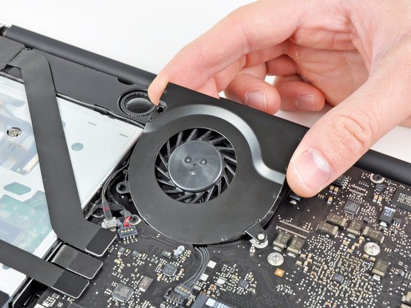

Image 1/1: One 7.2 mm T6 Torx screw
  • Remove the following three screws securing the fan to the logic board:
    • One 7.2 mm T6 Torx screw
    • Two 5.3 mm T6 Torx screws
These are T5 screws
dbell316 - Reply
I think so too, (maybe on a certain batch?) tried a T6 and its too big
billytalentlovexo -
No they are T6
tweakland - Reply
Nope just tried a T6 and its too big, don't have a T5 but it's gotta be one
billytalentlovexo -
It would be helpful to have recommendations about how to clean the dust from inside. What places to direct the compressed air,
garyrclark - Reply

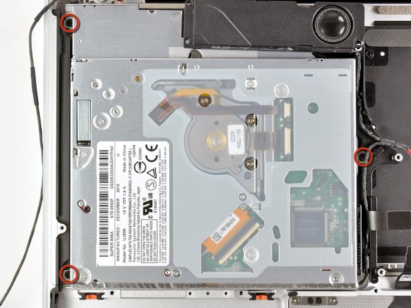

Image 1/2: Pull the right speaker/subwoofer cable upward to lift the connector out of its socket on the logic board. Image 2/2: Pull the right speaker/subwoofer cable upward to lift the connector out of its socket on the logic board.
  • Use the tip of a spudger to pull the right speaker/subwoofer cable out from under the retaining finger molded into the upper case.
  • Pull the right speaker/subwoofer cable upward to lift the connector out of its socket on the logic board.
Image 1/1: Pull the cable parallel to the face of the logic board. Pulling the cable upward may damage the logic board or the cable itself.

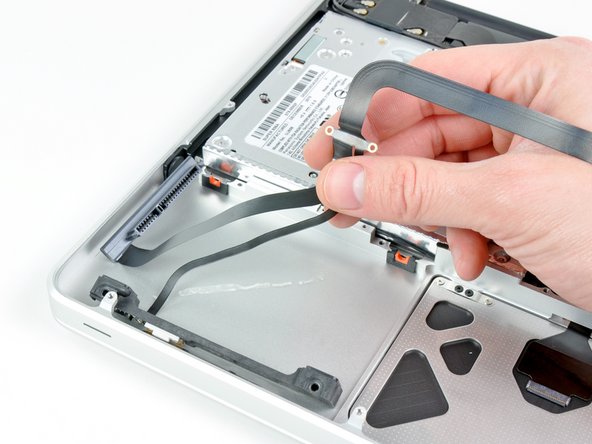

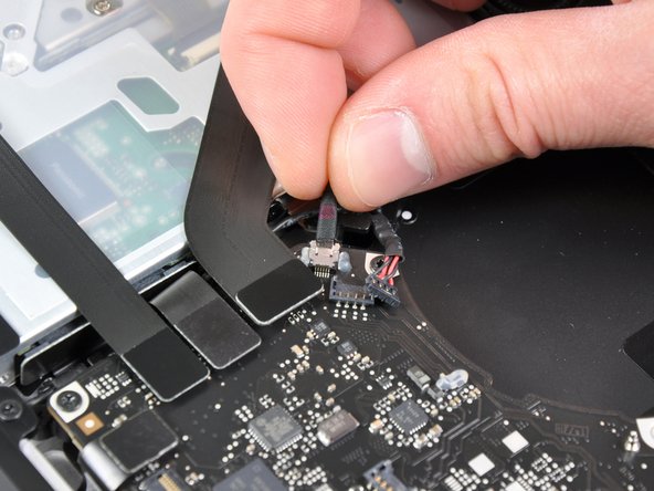

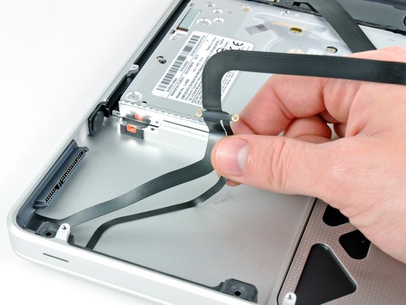

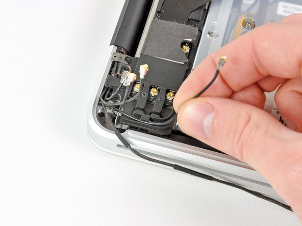

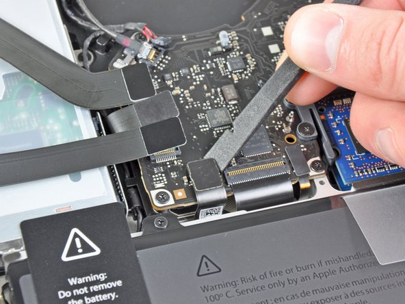

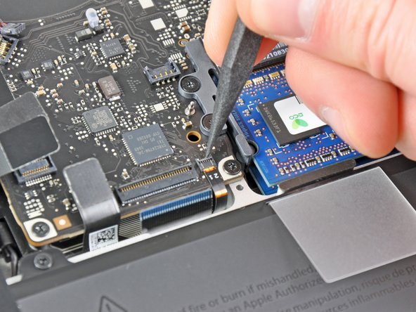

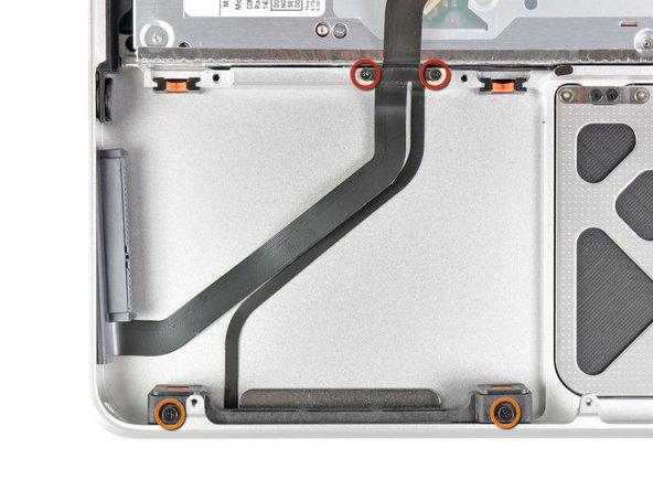

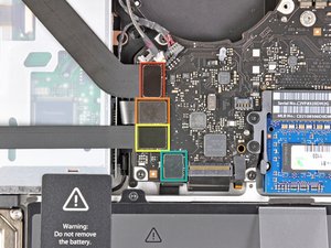

Image 1/2: AirPort/Bluetooth cable Image 2/2: Optical drive cable
  • Disconnect the following four cables:
    • AirPort/Bluetooth cable
    • Optical drive cable
    • Hard drive cable
    • Trackpad cable
  • To disconnect the cables, use the flat end of a spudger to pry their connectors up from the sockets on the logic board.
On the mid-2009 13" MacBook Pro 5,5 the Airport/Bluetooth cable is different from the other three cables in this step. It's fabric wrapped, and its connection works in a fashion more like the display data cable connection, although it does not have a lock that releases by pulling a tab back over the cable. So, to those of you who are repairing this model, be careful. Prying upward is not the way to remove this cable. I played with it until I could detect which parts were moving which way and why. Although I can't say with precision how the connection works, I removed it by gently coaxing slightly up at an angle and back along the plane of the optical drive. The idea is to pull the cable back out of its socket while lifting slightly.
Too bad we can't post photos in the comments.
Larry Horton - Reply

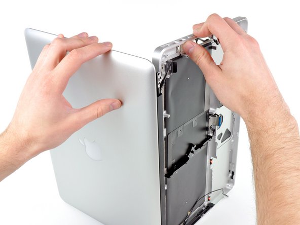

Image 1/3: Be sure you are prying up on the hinged retaining flap, '''not''' the socket itself. Image 2/3: Use the tip of a spudger to pull the keyboard ribbon cable out of its socket. Image 3/3: Use the tip of a spudger to pull the keyboard ribbon cable out of its socket.
  • Use your fingernail to flip up the retaining flap on the keyboard ribbon cable ZIF socket.
  • Use the tip of a spudger to pull the keyboard ribbon cable out of its socket.
Hello i've a late 2011 and have manged to break the keyboard ribbon cable ZIF socket. Is this a part that can be replaced? Ribbon is still good just the plastic has broken on the edge. Thanks
Derek Cowan - Reply
No, You'll need to replace the logic board. I'd probably just use a wired or bluetooth keyboard and put the money towards a new machine.
maccentric -
I ran into trouble reattaching the keyboard ribbon cable into the ZIF socket. I couldn't grasp it in a way that let me push it all the all back. A local repair guy told me his trick: use a piece of tape. Attach a piece of tape to the ribbon cable and make a tab so you can pull the cable into the socket. Use of a piece of tape that you can easily remove. Works like a charm.
David - Reply
David, thank you so much for the tape suggestion! A little Scotch tape just ended 15 minutes of eyes-widening frustration. :)
simolinic - Reply
if the zif socket got fried which parts must be replaced?
Jacob - Reply

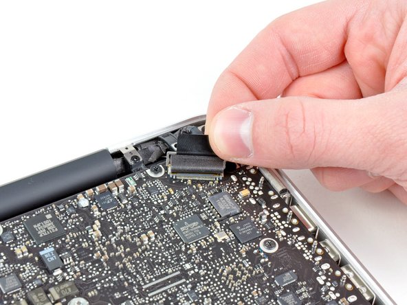

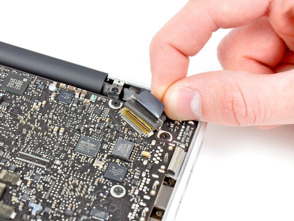

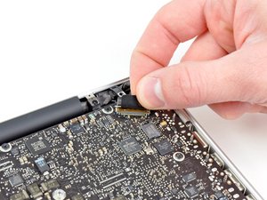

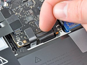

Image 1/3: Pull the display data cable straight out of its socket on the logic board. Image 2/3: Do not lift up on the display data cable, as its socket is very fragile. Pull the cable parallel to the face of the logic board. Image 3/3: Do not lift up on the display data cable, as its socket is very fragile. Pull the cable parallel to the face of the logic board.
  • Grab the plastic pull tab secured to the display data cable lock and rotate it toward the DC-In side of the computer.
  • Pull the display data cable straight out of its socket on the logic board.
  • Do not lift up on the display data cable, as its socket is very fragile. Pull the cable parallel to the face of the logic board.
Its quite delicate, pull gently and it will pop out with a slight clicking sound
Leo Jose - Reply
On my mid-2009 13" MacBook Pro 5,5 the display data cable was square with the motherboard, rather than at an angle. I'm not experienced with working on computer connections, but if I were going to describe this procedure, it would be more like:
"Grasp the plastic tab on the end of the display data cable connection, and pull it gently back over the cable, toward the DC-in board. The tab is connected to a flat rectangular 'ring' that locks the cable to its connection, and when you pull the tab, the rectangular lock will flip back over the cable, allowing the cable to be removed by pulling the same direction, parallel to the surface of the motherboard."

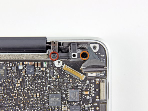

Image 1/2: One 8.6 mm Phillips screw Image 2/2: One 5.5 mm Phillips screw
  • Remove the following two screws:
    • One 8.6 mm Phillips screw
    • One 5.5 mm Phillips screw

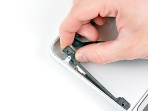

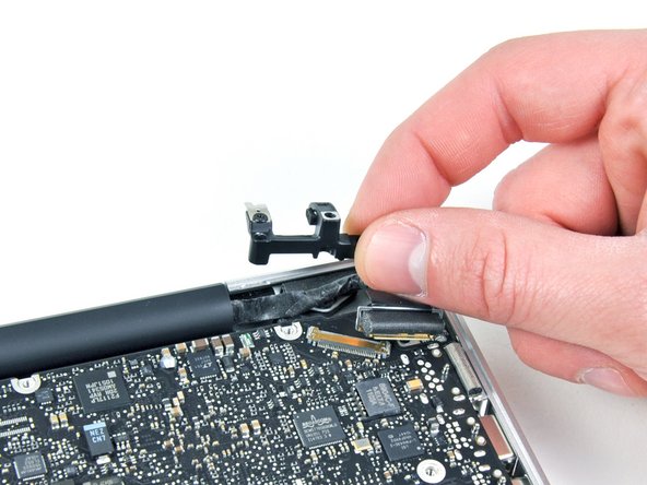

  • Remove the display data cable retainer from the upper case.
The last screw is the onde that's getting me. Been trying to take it out for half an hour...
leotowers - Reply
Image 1/1:
  • Use the tip of a spudger to gently peel the microphone off the adhesive securing it to the upper case.
Image 1/1: Without flexing the board, maneuver it out of the upper case, minding the flexible connection to the DC-In board that may get caught in the upper case.
  • Minding the many connectors near its edges, lift the logic board from the end nearest the optical drive.
  • Without flexing the board, maneuver it out of the upper case, minding the flexible connection to the DC-In board that may get caught in the upper case.
  • Remove the logic board.
I am stuck here. When I lift the logic board, it doesn't come out. I don't want to force it out by fear of breaking it. Please help
Jean F - Reply
I had the same issue. After wiggling the logic board back and forth and slowly applying more force, just up the threshold where I felt uncomfortable, it came out. The problem appeared to be caused by glue on the heatsink barcode sticking to the layer underneath.
Shaun - Reply
Same experience here. I used a longish spudger slipped under the logic board to carefully separate the black backlight shield from the underside of the logic board. I suspect the processor and/or the GPU sticks the two together. Be careful and patient separating the backlight shiled...it is delicate..go slow and use minimal force...
fasthans - Reply
It is heat not glue that caused the sticking...
fasthans - Reply
I got the microphone cable out fine, but what I'm really struggling with is the camera cable - it doesn't seem to wanna come out and I don't want to force it because I know it's fragile. Anyone find a trick for this?
ingwis - Reply

Image 1/1: One 5.6 mm Tri-wing screw
    • One 5.6 mm Tri-wing screw
    • One 13 mm Tri-wing screw

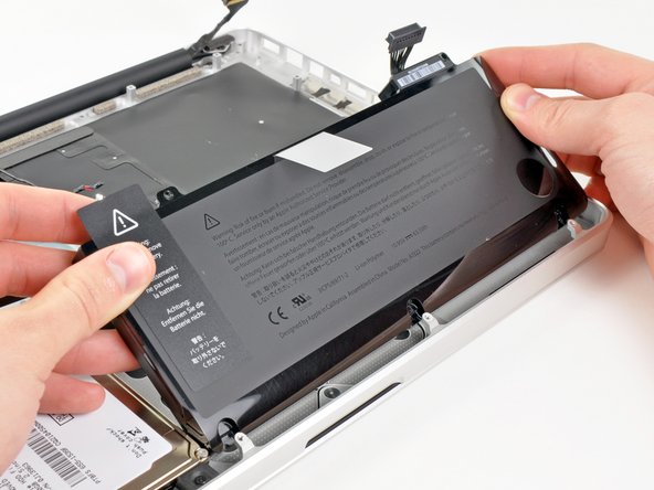

Image 1/1: Do not remove the label from the battery.
  • Carefully peel the battery warning label off the upper case between the battery and the optical drive.
  • Do not remove the label from the battery.
Image 1/1:
  • Use the attached plastic pull tab to help remove the battery from the upper case.
Image 1/2: These screws will remain captive to the hard drive bracket. Image 2/2: Remove the hard drive bracket.
  • Remove the two Phillips screws securing the hard drive bracket to the upper case.
  • These screws will remain captive to the hard drive bracket.
  • Remove the hard drive bracket.
  • The hard drive bracket may be firmly seated against the upper case.

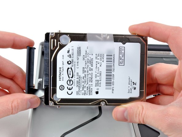

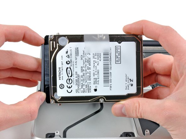

Image 1/3: Pull the hard drive cable away from the body of the hard drive. Image 2/3: Remove the hard drive. Image 3/3: Remove the hard drive.
  • Use the attached pull tab to lift the hard drive out of the upper case.
  • Pull the hard drive cable away from the body of the hard drive.
  • Remove the hard drive.
Image 1/1: Two 3 mm Phillips screws
  • Remove the following four screws:
    • Two 3 mm Phillips screws
    • Two 9.7 mm Phillips screws

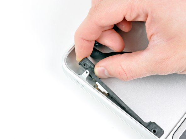

  • Carefully peel up the thin IR sensor/sleep LED ribbon cable from the adhesive securing it to the upper case.

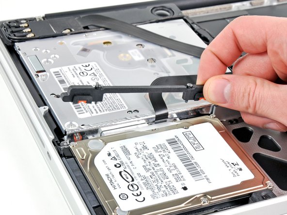

Image 1/2: Remove the hard drive cable. Image 2/2: Remove the hard drive cable.
  • Pull the front hard drive bracket containing the IR sensor/sleep LED away from the front edge of the upper case.
  • Remove the hard drive cable.

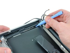

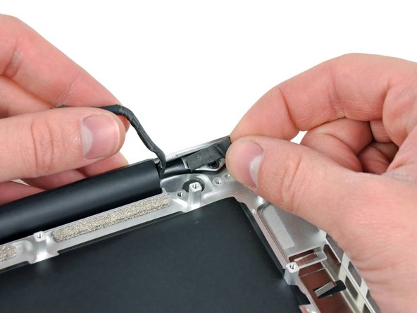

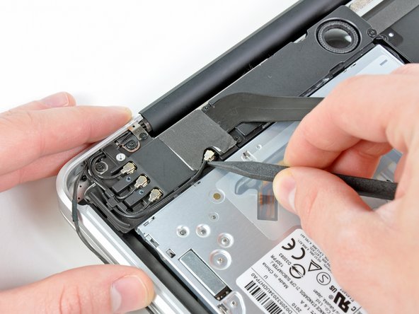

Image 1/1: De-route the camera cable out from under the retaining finger molded into the AirPort/Bluetooth bracket.
  • Carefully move the AirPort/Bluetooth ribbon cable out of the way as you peel the camera cable off the adhesive securing it to the subwoofer and the AirPort/Bluetooth bracket.
  • De-route the camera cable out from under the retaining finger molded into the AirPort/Bluetooth bracket.

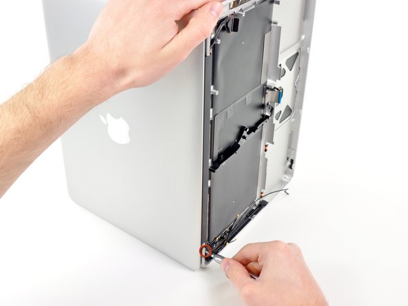

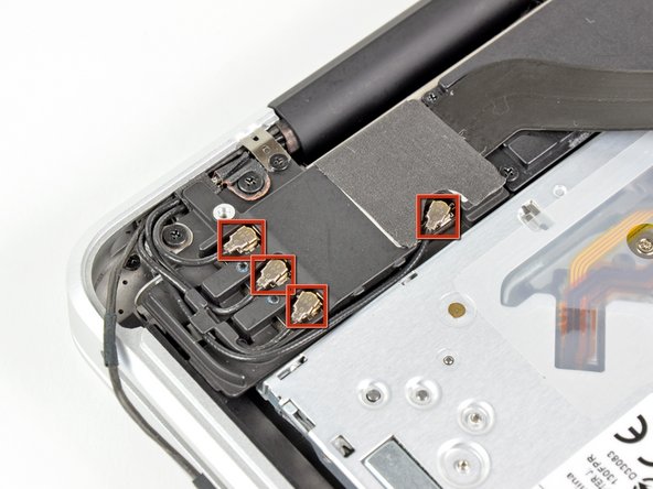

Image 1/3: To do so, use the tip of a spudger to pry their connectors up from the sockets on the AirPort/Bluetooth board. Image 2/3: De-route each of the cables from their channels in the AirPort/Bluetooth bracket. Image 3/3: De-route each of the cables from their channels in the AirPort/Bluetooth bracket.
  • Disconnect the four antenna connectors boxed in red in the first picture.
  • To do so, use the tip of a spudger to pry their connectors up from the sockets on the AirPort/Bluetooth board.
  • De-route each of the cables from their channels in the AirPort/Bluetooth bracket.
When I went to remove these cables, 2 of the three cables came off the display screen, and seem to have not been attached for a while as they were both very frayed. I have reassembled the computer, and it appears to be working fine, could anyone clarify what these cables should be doing? Many thanks!
Oscar Knowles - Reply

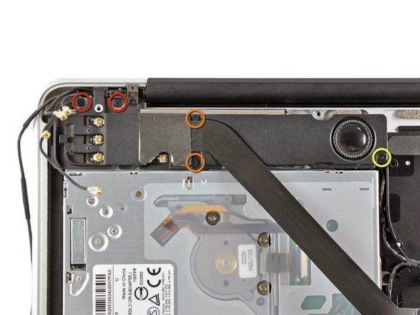

Image 1/1: Two 10.3 mm Phillips screws
  • Remove the following five screws:
    • Two 10.3 mm Phillips screws
    • Two 3.1 mm Phillips screws
    • One 5 mm Phillips screw
The second picture shows exactly how things are assembled, so looking at the picture tells you if you done any mistake or not. The first picture is very good for an overview the second to show the details.
MacWiniac - Reply

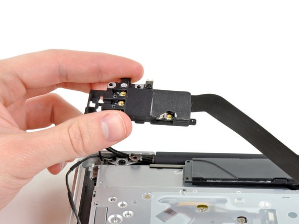

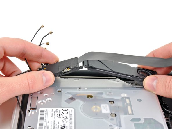

Image 1/2: Remove the AirPort/Bluetooth board assembly. Image 2/2: Remove the AirPort/Bluetooth board assembly.
  • Pull the AirPort/Bluetooth assembly and the Subwoofer upward near the center of the side of the optical drive until they clear each other.
  • Remove the AirPort/Bluetooth board assembly.

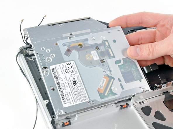

Image 1/1:
  • Remove the three 2.7 mm Phillips screws securing the optical drive to the upper case.
Image 1/1:
  • Lift the optical drive from the edge nearest the display and remove it from the upper case.

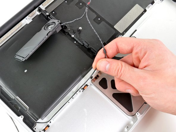

Image 1/1:
  • Peel the right speaker cable off the upper case.

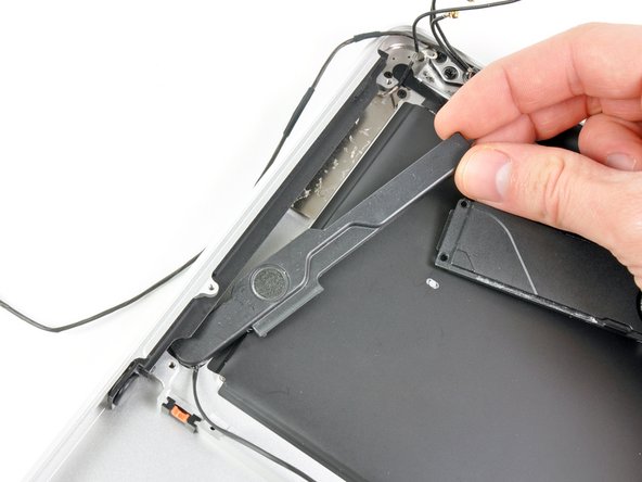

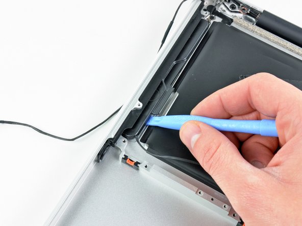

Image 1/2: Start prying up from the edge of the right speaker nearest the display. Starting from the other side may damage one of the antennas. Image 2/2: Pry up along the edge of the right speaker until it is separated from the upper case.
  • Use a plastic opening tool or another thin prying object to carefully pry the right speaker up from the adhesive securing it to the upper case.
  • Start prying up from the edge of the right speaker nearest the display. Starting from the other side may damage one of the antennas.
  • Pry up along the edge of the right speaker until it is separated from the upper case.
Image 1/1:
  • Pull the right speaker out from under the optical drive opening.

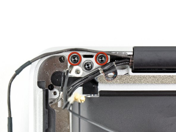

Image 1/1: We purposely have you leave one screw attaching the display to the upper case to aid in future steps.
  • Remove two of the three 6 mm T8 Torx screws securing the right side of the display to the upper case.
  • We purposely have you leave one screw attaching the display to the upper case to aid in future steps.

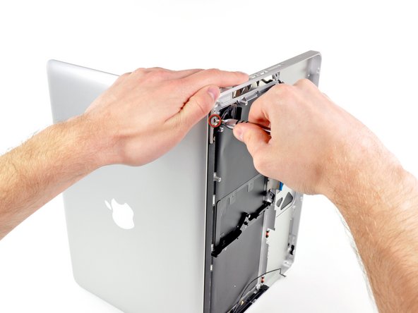

Image 1/1: Remove the last remaining T8 Torx screw securing the display to the upper case.
  • Be sure to hold the display and upper case together with your left hand. Failure to do so may cause the freed display/upper case to fall, potentially damaging each component.
  • Remove the last remaining T8 Torx screw securing the display to the upper case.

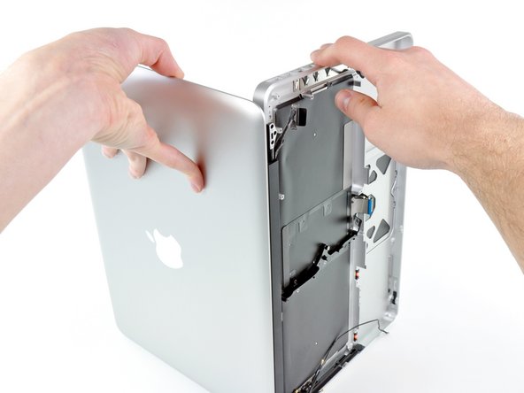

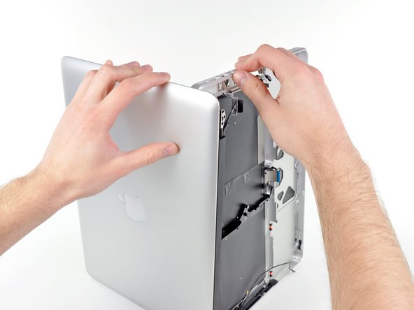

Image 1/3: Rotate the display slightly away from the upper case. Image 2/3: Lift the display up and away from the upper case, minding any brackets or cables that may get caught. Image 3/3: Upper case remains.
  • Grab the upper case with your right hand and rotate it slightly toward the top of the display so the upper display bracket clears the edge of the upper case.
  • Rotate the display slightly away from the upper case.
  • Lift the display up and away from the upper case, minding any brackets or cables that may get caught.
  • Upper case remains.

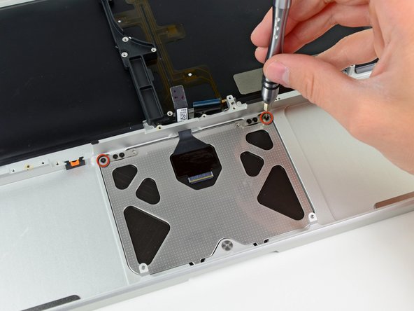

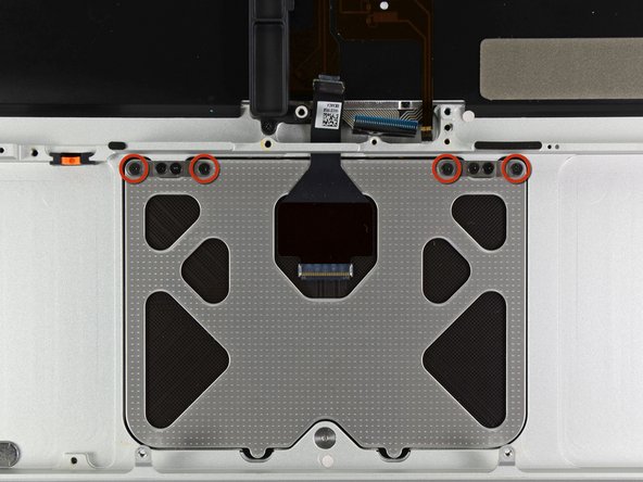

Image 1/1:
  • Remove the four 1.2 mm Phillips screws highlighted in red.

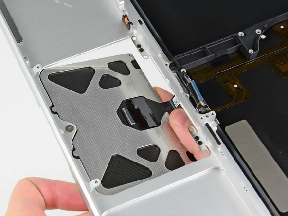

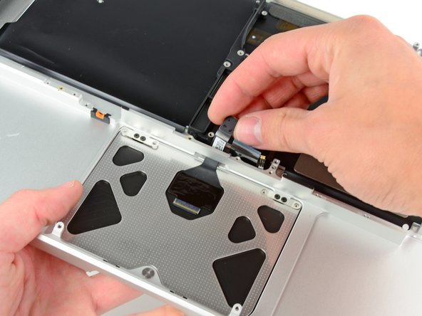

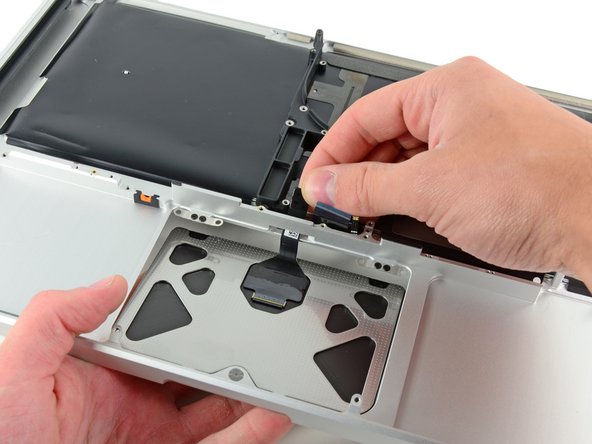

Image 1/1: Remove the trackpad and set it aside.
  • Pull the trackpad away from the outer edge of the upper case.
  • Remove the trackpad and set it aside.

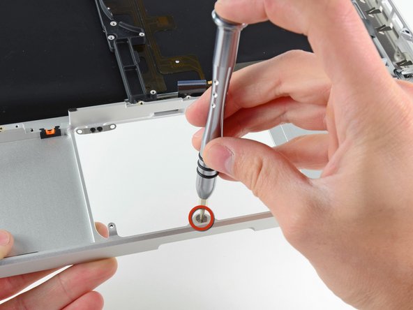

Image 1/1: Use a T6 Torx screwdriver to loosely install the 1.1 mm set screw included with your new upper case into its tapped hole near the middle of the trackpad opening on your new upper case.
  • In the following steps, you will be working on your new upper case.
  • Use a T6 Torx screwdriver to loosely install the 1.1 mm set screw included with your new upper case into its tapped hole near the middle of the trackpad opening on your new upper case.
  • Only tighten it about one turn for now.
