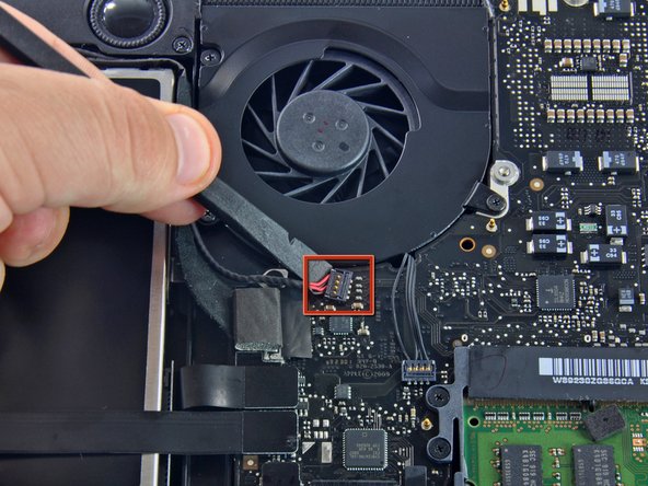

Pull the camera cable connector toward the optical drive to disconnect it from the logic board.

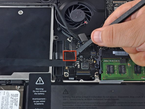

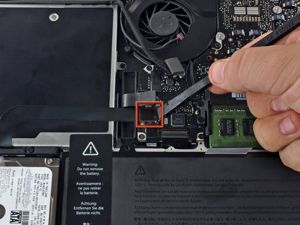

Use the flat end of a spudger to pry the optical drive connector straight up off the logic board.
Use the flat end of a spudger to pry the hard drive connector straight up off the logic board.

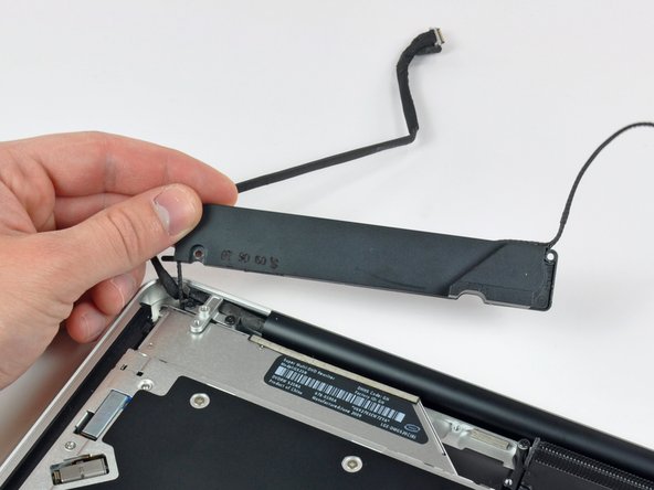

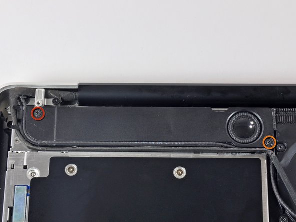

Remove the following screws securing the subwoofer to the upper case:
One 3.8 mm Phillips screw.
One 5 mm Phillips screw
Remove the two 10 mm Phillips screws securing the camera cable bracket to the upper case.
Lift the camera cable bracket out of the upper case.

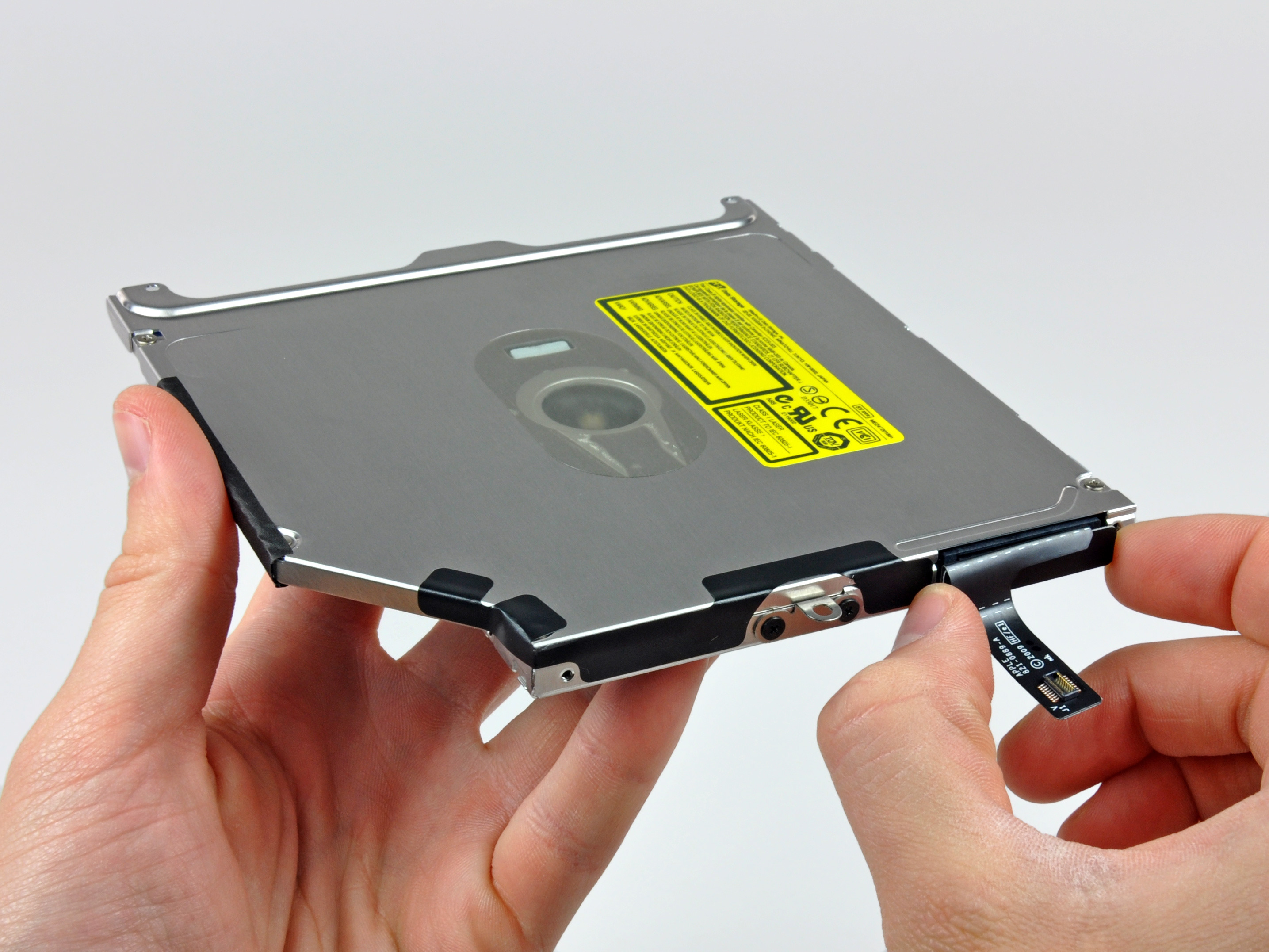

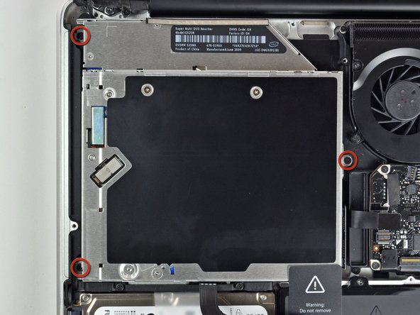

Remove the three 2.5 mm Phillips screws securing the optical drive to the upper case.

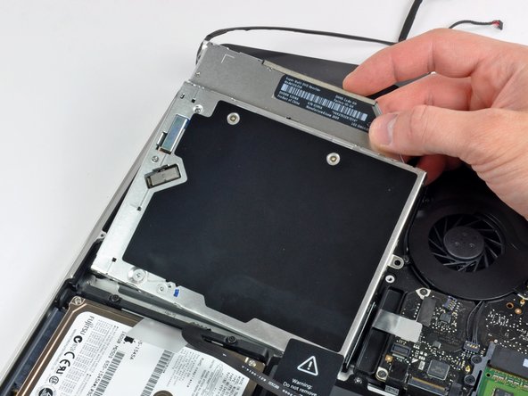

Lift the optical drive from its right edge and pull it out of the computer.
Remove the optical drive cable by pulling it straight away from the optical drive.

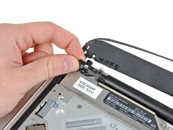

Remove the two black Phillips #0 screws securing the small metal mounting bracket. Transfer this bracket to your new optical drive or hard drive enclosure.

During this step, I accidentally ripped out the whole subwoofer connector from the logic board.. I tried taping it back with scotch tape, but it didn't work - my right speaker and subwoofer don't work anymore.. what are my options? Solder it back on?
Archdelux - Reply
It is not necessary to remove the camera cable connector (step 5) or the camera cable connector (step 10). Simply push the camera cable gently aside to remove one of the three screws securing the optical drive (step 11). Gently wiggle the optical drive from under the camera cable connector and go to step 12. Less chance of ruining your motherboard!
tomhart - Reply
It does indeed come out of the connector, but the picture makes it hard to see how; the connector it goes into sits on top of the board—however, I, too, ripped mine off the board trying to remove it; I only got it out of the clip after I tore it off. SIMPLY DONT; it's unnecessary. I plan to solder it back if one of my Robotics club friends lets me borrow a soldering iron.
Rachel - Reply
I avoided disconnecting the camera cable. If you are careful, it's not needed. I've taken tons of PC's apart and its 1 million times more complicated than a mid 2010 MBP! I've had my MBP for 5 years and I'm now upgrading memory, adding a SSD for OS and 750gb in the optical drive for storage. My computer has just started getting slower. This couldn't be any easier to do!
amp1069 - Reply

I'm having a similar problem where I think I messed something with this step and now my computer is REALLY slow and I cant get any wifi. Heres my story.
I am going to put a SSD in place of my HDD so I also took the optical drive out of my mac to reduce the weight. If this matters I also changed the fan because that was broken. I'm wondering what the problem could be. One thing im confused by in the guide was step 5. Am I supposed to remove that connector? If so how do I do that? I may have wiggled that a little trying to take it out.
My computer will boot up very slowly but the mouse and keystrokles lag by about 4-5 seconds. The computer won't connect to wifi. The battery symbol has an "x" inside the battery so I keep in plugged in. It also has my apps in the dock and my name in the upper right hand corner.
Any ideas what is wrong? If something is wrong how do I clone my old data onto my new hard drive? If you have any questions about my situation ill gladly answer them.
Billy Walsh - Reply

I did on my 15" MBP (putting a SSD) without any problem
but I did it on this very model 13" on a friend MBP
and it seems the optical drive cable is dead (both drives works connected elsewhere ) the only other part i was not able to test separately is the data doubler from OWC that allows to fit a SSF in place of the optical drive.
Do anybody experience this ?
The optical drive cable shows no sign of tearing i unplugged it very carefully
BUT once disconnected during the optical drive extraction from its original location the cable might have touch the logical board (not sure just guessing)
Any clues welcome !!
