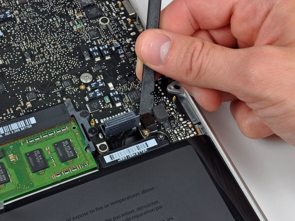

15 Edit Step 3 Battery  ¶
Image 1/1: Use the flat end of a spudger to lift the battery connector up out of its socket on the logic board.
  • For precautionary purposes, we advise that you disconnect the battery connector from the logic board to avoid any electrical discharge.
  • Use the flat end of a spudger to lift the battery connector up out of its socket on the logic board.

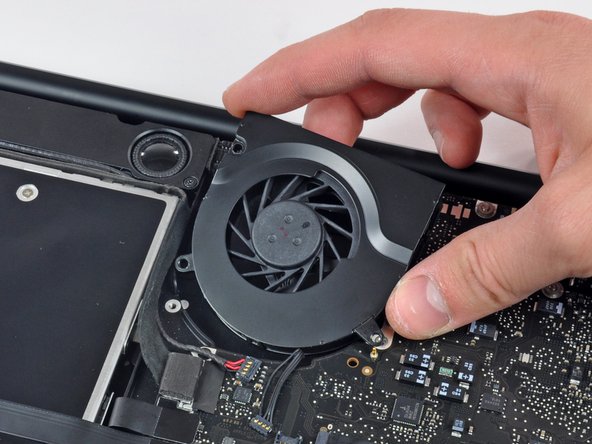

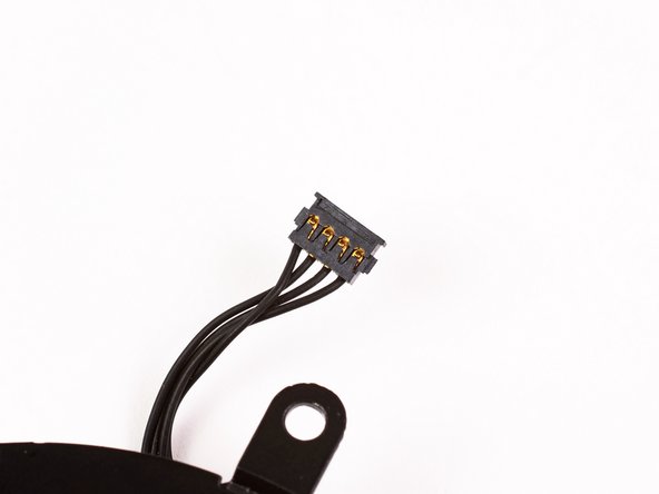

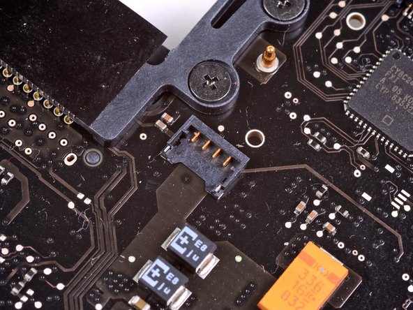

5 Edit Step 4 Fan  ¶
Image 1/3: It is useful to twist the spudger axially from beneath the fan cable wires to release the connector.
5 Edit Step 4 Fan  ¶
  • Use a spudger to pry up the fan connector out of its socket on the logic board.
  • It is useful to twist the spudger axially from beneath the fan cable wires to release the connector.
  • The fan socket and the fan connector can be seen in the second and third pictures. Be careful not to break the plastic fan socket off the logic board as you use your spudger to lift the fan connector straight up and out of its socket. The layout of the logic board shown in the second picture may look slightly different than your machine but the fan socket is the same.

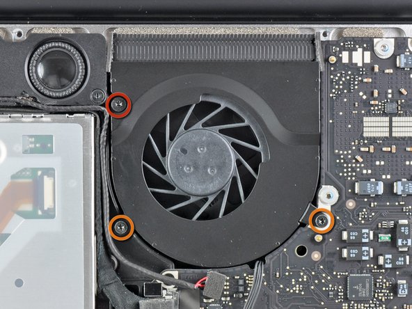

Edit Step 5  ¶
Image 1/1: One 7 mm T6 Torx screw
Edit Step 5  ¶
  • Remove the following three screws:
    • One 7 mm T6 Torx screw
    • Two 5.4 mm T6 Torx screws
Edit Step 6  ¶
Image 1/1:
Edit Step 6  ¶
  • Lift the fan out of the upper case.

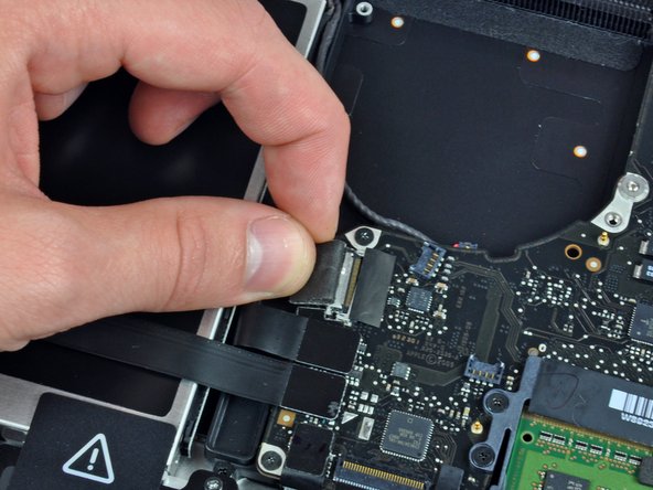

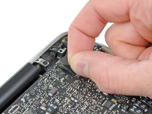

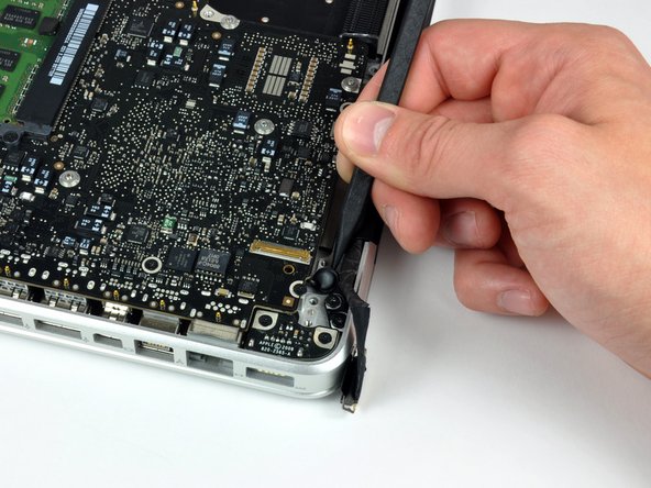

2 Edit Step 7 Logic Board  ¶
Image 1/3: Pull the display data cable connector straight away from its socket.
  • Grab the plastic pull tab secured to the display data cable lock and rotate it toward the DC-In side of the computer.
  • Pull the display data cable connector straight away from its socket.

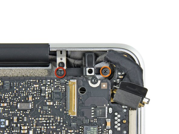

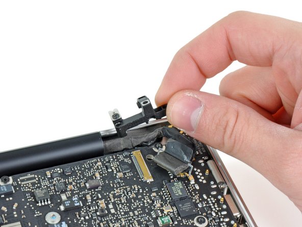

2 Edit Step 8  ¶
Image 1/2: One 8.6 mm Phillips
2 Edit Step 8  ¶
  • Remove the following two screws securing the display data cable bracket to the upper case:
    • One 8.6 mm Phillips
    • One 5.6 mm Phillips
  • Lift the display data cable bracket out of the upper case.

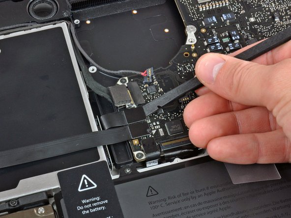

Edit Step 11  ¶
Image 1/3:
Edit Step 11  ¶
  • Use the flat end of a spudger to pry the optical drive, hard drive, and trackpad cable connectors up off the logic board.

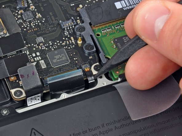

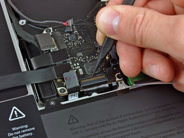

2 Edit Step 12  ¶
Image 1/3: Use your spudger to slide the keyboard ribbon cable out of its socket.
2 Edit Step 12  ¶
  • Use your fingernail or the tip of a spudger to flip up the cable retaining flap on the ZIF socket for the keyboard ribbon cable.
  • Use your spudger to slide the keyboard ribbon cable out of its socket.

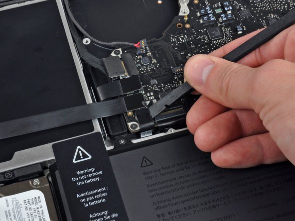

4 Edit Step 14  ¶
Image 1/3: Use your spudger to slide the keyboard backlight ribbon cable out of its socket.
4 Edit Step 14  ¶
  • Use the tip of a spudger to flip up the cable retaining flap on the ZIF socket for the keyboard backlight ribbon cable.
  • Use your spudger to slide the keyboard backlight ribbon cable out of its socket.

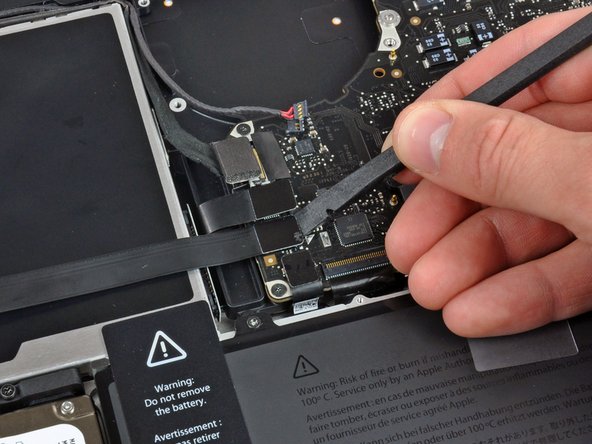

Edit Step 15  ¶
Image 1/1:
Edit Step 15  ¶
  • Use the flat end of a spudger to pry the battery indicator cable connector up off the logic board.

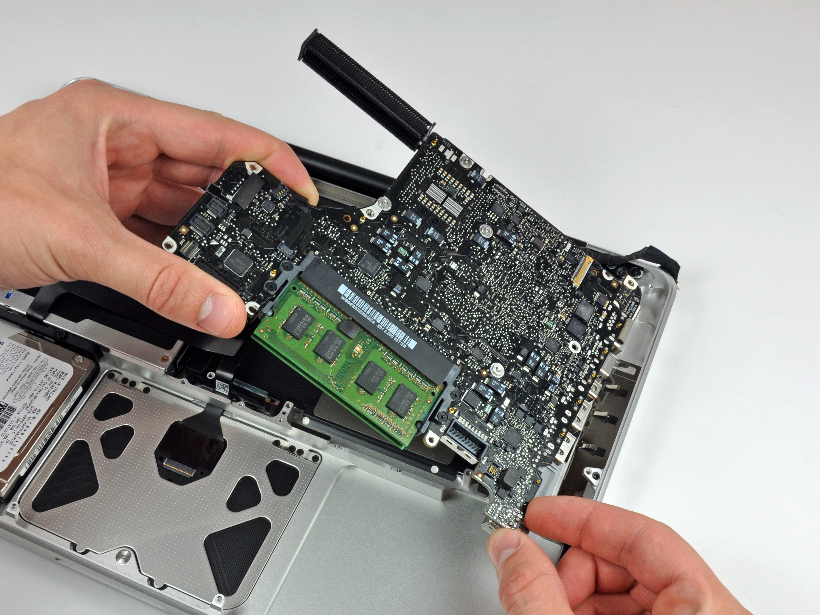

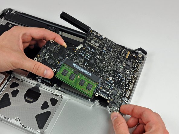

1 Edit Step 19  ¶
Image 1/2: Pull the logic board away from the side of the upper case and remove it, minding the DC-In board that may get caught.
1 Edit Step 19  ¶
  • Lift the logic board from its left edge and raise it until the ports clear the side of the upper case.
  • Pull the logic board away from the side of the upper case and remove it, minding the DC-In board that may get caught.

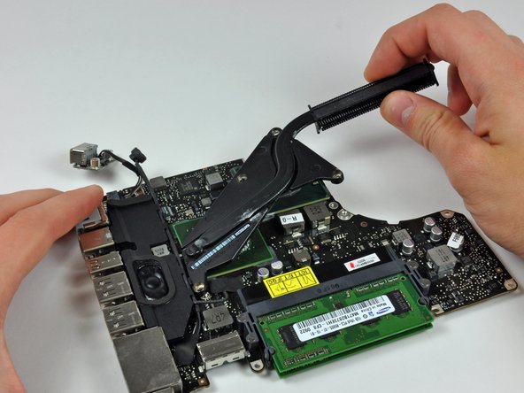

Edit Step 20 Heat Sink  ¶
Image 1/1: A spring is held under each of these screws.
  • Remove the four 8.5 mm Phillips screws securing the heat sink to the logic board.
  • A spring is held under each of these screws.
Edit Step 21  ¶
Image 1/1: When you mount the heat sink back onto the logic board, be sure to apply a new layer of thermal paste. We have a [guide|744|guide] that makes replacing the thermal paste easy.
Edit Step 21  ¶
  • Gently lift the heat sink off the logic board.
  • When you mount the heat sink back onto the logic board, be sure to apply a new layer of thermal paste. We have a guide that makes replacing the thermal paste easy.

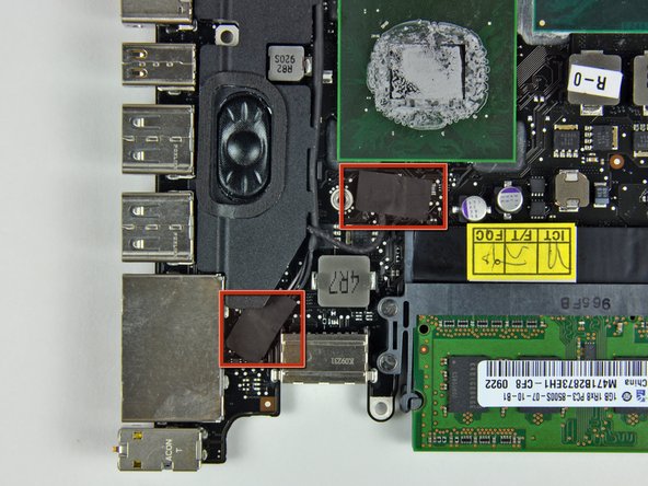

Edit Step 22 Logic Board  ¶
Image 1/1:
  • Peel off the tape covering the microphone cable connector and left speaker cable connector.

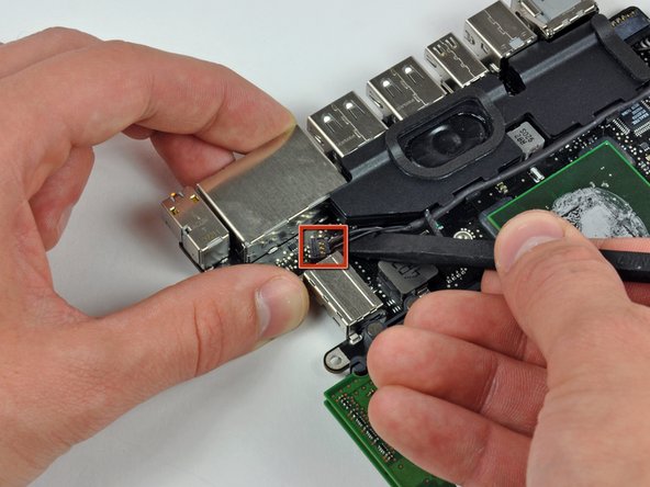

Edit Step 24  ¶
Image 1/1:
Edit Step 24  ¶
  • Use the flat end of a spudger to pry the microphone cable connector up off the logic board.

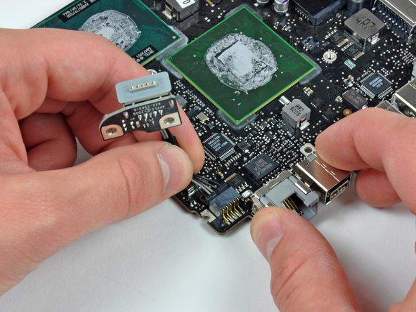

Image 1/1:
Edit Step 26  ¶
  • Disconnect the DC-In board by pulling its connector away from the socket on the logic board.

$@$@. Don't use an non-isolated screwdriver for this. I just shorted-out my battery :(
Lukas Besch - Reply
You are absolutely right, never use a screwdriver on the logic board or any connector! Delicate use of fingernails or a credit card will get you through most situations if you lack a spudger.
Logan Bean -
How do you get that battery connector back on? Do you just press it in back in place after you're done?
Horace Chung - Reply
yes. I usually plug it in before I screw it down so I can lift the battery a bit and have enough slack to be able to go straight down on the connector, otherwise it comes in on a bit of an angle, which can't be good (though not necessarily bad).
maccentric -

Bummer, I broke the connector at the solder points. Be careful!
Hector - Reply
Any tips on how to solder it back on? I made the same mistake.
Juan Sebastian -
Hi Hector, how did you put it back?
I broke mine too and carefully glued it back in but now the fan isn't working... But I don't know if it's because of this or because it does not need to switch on as I also changed my hard drive from HD to SSHD Hybrid.
Thanks
Antoine B -
I did a terrible mistake when I try to remove the fan connector socket form the logic board I accidentally pop out the connector from the board.. I am not expert in soldering so big problem for me. What should I do?
Nielven Araullo - Reply
Bring it to someone who know to solde...
Chel - Reply
On my system the pad on top of the connector was shifted making the bracket difficult to rotate into the up position. The bracket looks like a handle so my first instinct was to pull it straight up. Big mistake. I ended up popping the brass guard off the connector on the logic board. The instructions could benefit from an arrow indicating the direction to pull and rotation of the bracket.
highnoontoday - Reply
The same thing happened to me. What did you do when you reassembled? thx Alan
Alan Schwartz -
The 8.6mm screw is stripped, what to do now?
mwmouawad - Reply
Same problem here but with the 5.6 mm one. In fact, that screw was slightly different from a phillips, it seems a tiny torq-set screw. Is that possible? Anyone else had a similar problem? I stripped it out using a phillips 00 that worked perfectly removing all the other phillips screws...
Blackwood - Reply
As mentioned, the socket can be easily damaged when re-inserting it. I didn't care enough and one pin was damaged. Wifi was not detected.
Hopefully the pin was not broken (only bent). Putting it back in its correct position, the wifi re-appeared.
Arnaud ROSAY - Reply
Sometimes spulger is not the best tool to slide the cable out. If it is difficult to slide, try two toothpicks to pull the cable from two sides simultaneosly.
Leo Nikitin - Reply
the zif cable is especially difficult to get back in fully. Seems I might need to make my own tool with fine tweezers that are rubber dipped (or something similar). Have had no luck otherwise and worry I am doing damage.
Mateo - Reply
Be very careful while taking this black tape off. I accidentally broke the chip off the motherboard and so my keyboard is not backlit any more.
Asim Akath - Reply
Easy to take out Zif cable but can't seem to get it back in again.
linuxuser101 - Reply
Be especially careful as my hole socket detached from the board. It would have helped to vertically press the socket to the board with the tip of a spudger. Thus partially blocking the strap, you can first peel the free end, then change position and peel the rest. Slide the ribbon cable perfectly horizontally.
Rainer - Reply
I had the same issue of trying to get the ZIF cable back in but found that if I used a piece of scotch tape, it worked. I followed this guide. MacBook unibody keyboard ribbon cable won't go in
spearson - Reply
A reassembly trick that works for me is to use some 3/4" blue painters tape to stick to the very back (lower end) of the ribbon cable so I can pull it up and back before locking the cam. Trying to get a good grip without cutting, or crimping the ribbon means no tweezers or pliers can be used.
originalmachead - Reply

Be careful while taking the board out, as the heatsink usually is caught by the optic drive.
Leo Nikitin - Reply
What it's the order of the three cables on the microphone connector, thick black-grey-thin black???? Step 25
Miguel Acosta - Reply

Do I need to remove the Arctic Silver and replace it?
rob - Reply
