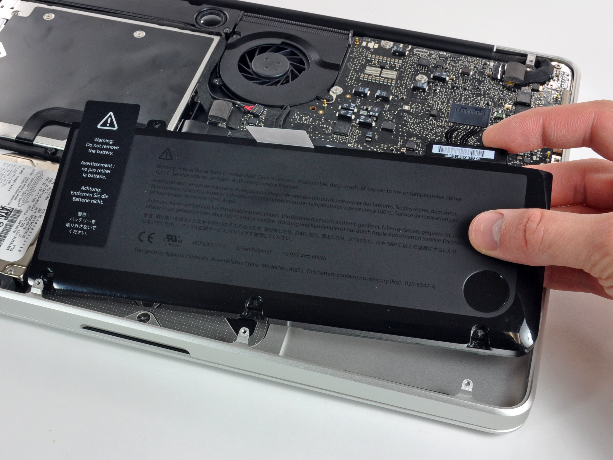

11 Edit Step 3 Battery  ¶
Image 1/1: One 5.5 mm tri-wing screw.
  • Remove the following tri-wing screws securing the battery to the upper case:
    • One 5.5 mm tri-wing screw.
    • One 13.5 mm tri-wing screw.

  • Use the flat end of a spudger to lift the battery connector up out of its socket on the logic board.
6 Edit Step 5  ¶
Image 1/1:
6 Edit Step 5  ¶
  • Lift the battery out of the upper case.

If you are running OS X 10.11.2 or newer, battery provided by iFixIt will not work. I've already tried 2 batteries from iFixIt and neither worked. iFixIt needs to come clean on this unfortunate situation. I've already put 8 hours into this futile effort when it should have taken me 45 minutes.
gkofga - Reply

Did everything correctly, but now the battery doesn't charge. Do I have to do something in particular to make it work now that's installed? Thanks
Olivier - Reply
Everything was so easy but that is not the highlight of it all; the replacement parts are cheaper than buying it from a local store here in Taiwan or in The Philippines.
mdtorresjr - Reply
Olivier, to answer your question, please read the 1st comment in the Guide section at the top. :)
aspeegle - Reply
I have the same problem as Oliver. Replaced the battery, it Works, but don't charge. I don't see any comment on this page that answer his question.
torbernhardsen -
I too encountered the same problem. After resetting the SMC (http://support.apple.com/en-us/HT201295), it resolved the problem.
2CentsNoneTheRicher - Reply
