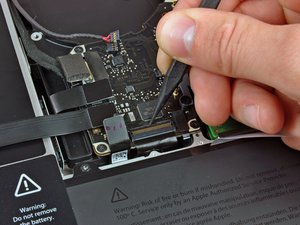

  • Slightly lift the lower case and push it toward the rear of the computer to free the mounting tabs.

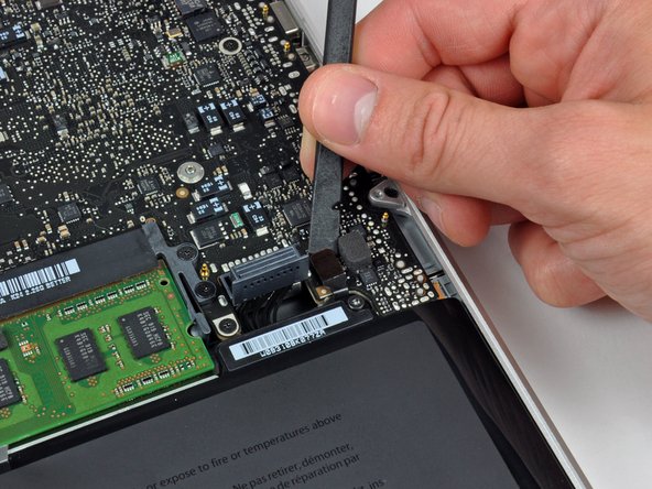

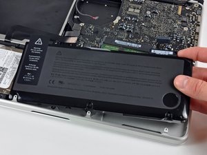

Image 1/1: Use the flat end of a spudger to lift the battery connector up out of its socket on the logic board.
  • For precautionary purposes, we advise that you disconnect the battery connector from the logic board to avoid any electrical discharge.
  • Use the flat end of a spudger to lift the battery connector up out of its socket on the logic board.
why is step 3 necessary?
gansodesoya - Reply
Quote from gansodesoya:
Just to disconnect any power source to avoid damages by short-circuits.
MrKane - Reply
Removes the possibility of any current flow. This is especially important if you are trying to mitigate the damage to the circuitry due to a spill on a keyboard.
amiller770 - Reply
I'm thinking of ordering the spudger. I was thinking of order the heavy duty spudger... or should I just order the normal. Will either of the spudgers work for this DIY?
shockaaa - Reply
Once you have a set of spudgers, you will wonder how you ever went without them. :-)
Brian -
$@$@. Don't use an non-isolated screwdriver for this. I just shorted-out my battery :(
Lukas Besch - Reply
You are absolutely right, never use a screwdriver on the logic board or any connector! Delicate use of fingernails or a credit card will get you through most situations if you lack a spudger.
Logan Bean -
How do you get that battery connector back on? Do you just press it in back in place after you're done?
Horace Chung - Reply
yes. I usually plug it in before I screw it down so I can lift the battery a bit and have enough slack to be able to go straight down on the connector, otherwise it comes in on a bit of an angle, which can't be good (though not necessarily bad).
maccentric -
Would it not be advisable to drain the battery completely before attempting to repair, if you want to be sure you don't get a spark when removing the battery connector?
Berlugana
bduault - Reply
Disconnecting the battery connector is not that different from simply unplugging a battery from an older model MacBook with a removable battery. You're not trying to protect yourself from a "spark", but the internal circuitry when taking the MacBook apart.
amiller770 -
I neglected step 3 and now my computer won't turn on. Could I have shorted out my logic board?
Plamen - Reply
I had the same problem , my macbook doesn't switch on working
marioluiggi -

Removing the battery is not required, but in some instances can make installing ram much easier. If you plan on upgrading from 4GB (2X 2GB) to 8GB (2X 4GB) Removing the battery would be better. There are two levels of ram. If you are replacing both levels, then remove the battery. If you are just replacing the top, dont bother. Removing the battery for very long or even at all (depending on the CMOS battery age and health) could possibly reset settings, the clock, saved wifi passwords, and more.
Everett Whiteman - Reply

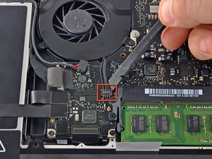

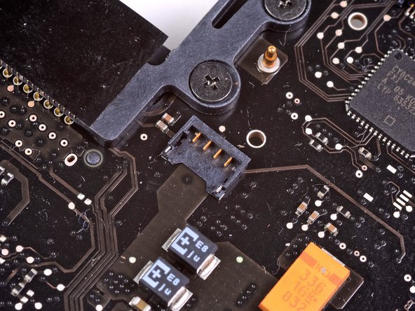

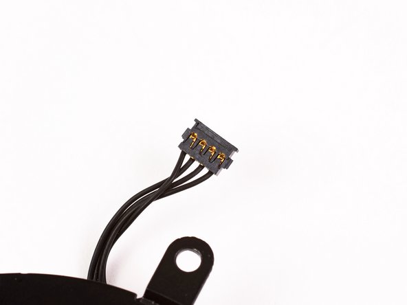

Image 1/3: It is useful to twist the spudger axially from beneath the fan cable wires to release the connector. Image 2/3: The fan socket and the fan connector can be seen in the second and third pictures. Be careful not to break the plastic fan socket off the logic board as you use your spudger to lift the fan connector straight up and out of its socket. The layout of the logic board shown in the second picture may look slightly different than your machine but the fan socket is the same. Image 3/3: The fan socket and the fan connector can be seen in the second and third pictures. Be careful not to break the plastic fan socket off the logic board as you use your spudger to lift the fan connector straight up and out of its socket. The layout of the logic board shown in the second picture may look slightly different than your machine but the fan socket is the same.
  • Use a spudger to pry the fan connector out of its seat, and straight up off the logic board.
  • It is useful to twist the spudger axially from beneath the fan cable wires to release the connector.
  • The fan socket and the fan connector can be seen in the second and third pictures. Be careful not to break the plastic fan socket off the logic board as you use your spudger to lift the fan connector straight up and out of its socket. The layout of the logic board shown in the second picture may look slightly different than your machine but the fan socket is the same.
The fan plug snapped off right away without applying much pressure so the best angle of attack isn't exactly where the diagram shows. Anyone know how to reattach this piece?
Also worth noting I have the right screwdrivers and the screws inside this thing are really soft.
Rpo - Reply
I broke the socket too.. Any one know how to fix this??
laika117 -
Mine broke off too :(
john - Reply
I broke mine off too. No one knows if it can be reattached? Glue? Tape? Anything?
philip shiang ho - Reply
Mine broke, too. None of the repair shops in my area do soldering, so I may be SOL. I spilled water on my laptop and a bunch of keys shorted out. I read online from numerous sources that replacing the keyboard yourself isn't hard, so I figured i'd try it. I am majorly disappointed. Suggestion for iFixit: upload a video of someone disconnecting the fan cable connector. Clearly Apple didn't design it to be easy to remove, and your description is inadequate, given how many people have broken theirs.
emmaxfeldman - Reply
I just soldered it back on. . . I tried to clean the pads with braid first, but it didn't do much so I don't think that's necessary. I first supper-glued it in place with the pins on the pads and then I put a tiny dab of solder on each pin/pad. Plugged in the fan and i works!
Ron Hudson - Reply
Just the answer I was looking for Ron! Awesome work buddy!
lucasjmenzie -

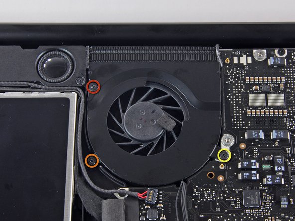

Image 1/1: One 6.5 mm Phillips.
  • Remove the following three screws securing the fan to the upper case:
    • One 6.5 mm Phillips.
    • One 5.5 mm Phillips.
    • One 4.5 mm Phillips.
I found it mostly unnecessary to remove the fan and therefore all of the fan screws in this step. Only the two on the left hand side of the fan actually need to be removed. I also found it extremely helpful, after pulling logic boards several times, to remove the speaker screws at this time. The heat sink and the speaker interfere with each other when you are later trying to remove and then install the logic board. The longer screw goes on end of the speaker assembly that is closest to the fan, and the shorter one goes on the end closest to the dvd slot.
stevesontheroad - Reply
This article is about replacing the fan. Therefore you have to unplug and remove the old one.
John Morley -
If you are removing the logic board for any other reason than replacing it, or if your replacement logic board came with a fan installed, DO NOT REMOVE THE FAN. It is not necessary for the removal of the logic board. For removal with the fan attached, only remove the two screws on the left hand side of the fan, and leave the cable attached. I see here that too many people have broken the fan cable, and it is too easy to do.

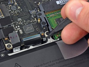

Image 1/1:
  • Lift the fan out of the upper case.

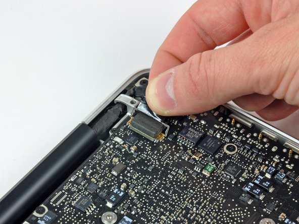

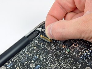

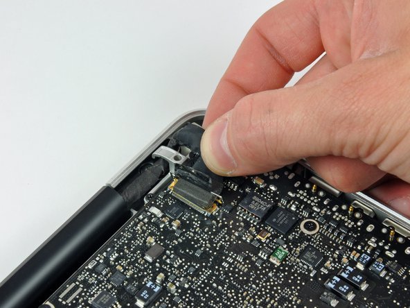

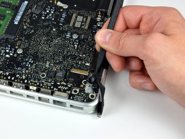

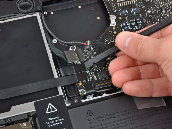

Image 1/3: Pull the display data cable connector straight away from its socket, towards the DC-in side of the computer. Image 2/3: Pull the display data cable connector straight away from its socket, towards the DC-in side of the computer. Image 3/3: Pull the display data cable connector straight away from its socket, towards the DC-in side of the computer.
  • Grab the plastic pull tab secured to the display data cable lock, and rotate it toward the DC-in side of the computer.
  • Pull the display data cable connector straight away from its socket, towards the DC-in side of the computer.
I pulled out the cable and it kind of broke off, now the screen is black when i turn it on but it still makes the chime. How do i fix this?
robertjriordan1 - Reply
If the cable broke, you can replace it for around $50ish. If the terminal broke off, I am afraid your logic board needs to be fixed(unlikely) or replaced.
Jurgen - Reply

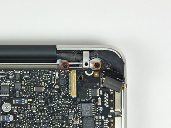

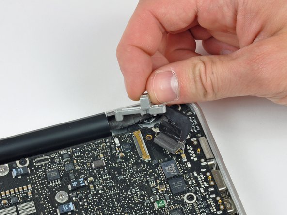

Image 1/2: One 7 mm Phillips. Image 2/2: One 5 mm Phillips.
  • Remove the following two screws securing the display data cable bracket to the upper case:
    • One 7 mm Phillips.
    • One 5 mm Phillips.
  • Lift the display data cable bracket out of the upper case.
Mine are Torx and got an extra clamp for the cable, just above the left screw
Martin - Reply
For some reason I stripped BOTH these screws! All the other screws came out without a problem!
Johnson Sathaseevan - Reply

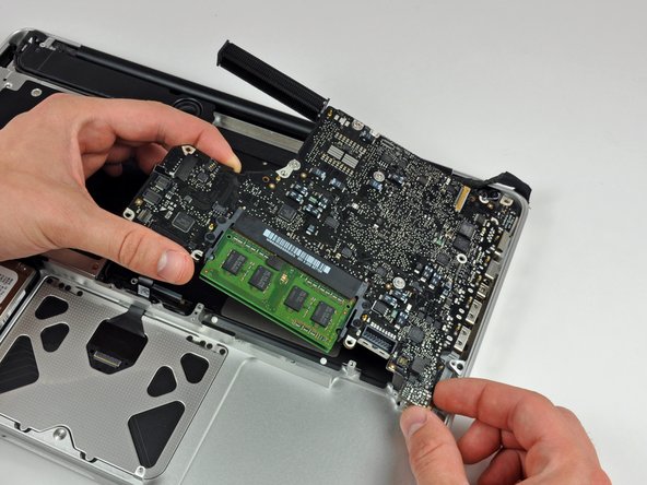

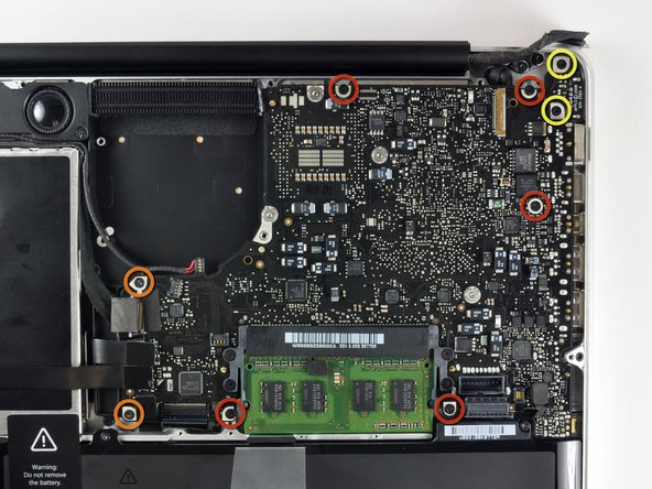

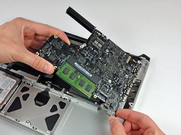

If you only want to replace the DC-in board, stop here and GOTO 17 (and DO NOT 4 and 6).
When the Logic board is loose, lift it up on the Harddrive end and shift slightly towards the HD, so that the USB connectors at the outside come free from under the case rim and the board can be lifted up a bit. Then there´s enough room to move the DC in board, pull the cable out with a pair of tweezers, wriggle it out from under the microphone cable and wriggle the new connector in. It can be pushed into the socket with tweezers or a small screwdriver. This worked perfect for me.
Be careful not to bend the logic board, but otherwise I think there´s much less risk of messing anything up with all the connectors and bits and pieces that need to be loosened and fastened.
Mike - Reply

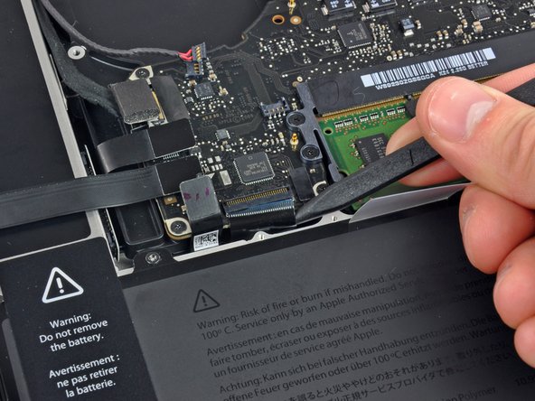

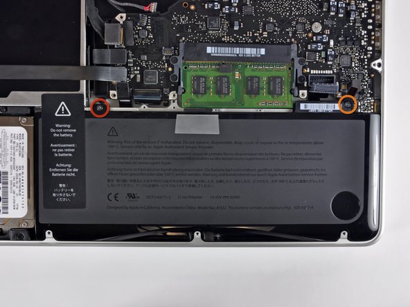

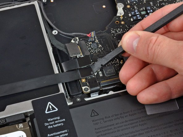

Image 1/1:

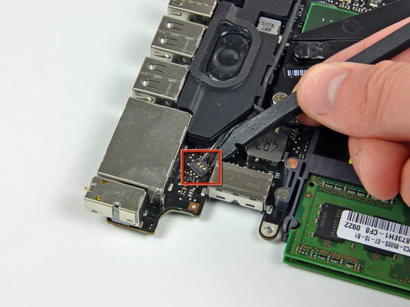

  • Use the flat end of a spudger to pry the subwoofer and right speaker connector up off the logic board.
Ouch - broke off the connectors by pulling upwards. As it looks, i should have pulled to the optical drive instead :(
Thorsten Iversen - Reply
I accidentally dislodged the right speaker / subwoofer cable connector as well as the fan cable connector. I know for the fan cable connector there is a warning about how easy it is to dislodge, but there should be more pictures to describe exactly how to avoid doing so. I can live without the right speaker / subwoofer, but my logic board cannot survive long without a fan. I'm trying to see if I can find someone who will try to solder the cable connector back on, but no one in my area will, so I may need to send it out (a local repair shop owner recommended a guy he's used to fix iPad backlights.) I am probably SOL, though. A new logic board is quite pricey... Had I known that it was so difficult to replace the keyboard on your own, I would have paid the $200 for a local repair shop to fix it. I found iFixit helpful but ultimately misleading. I may end up having to get a new laptop altogether. How upsetting.

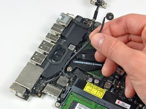

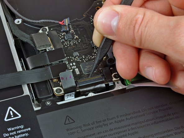

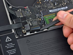

Image 1/1: Pull the camera cable connector toward the optical drive to disconnect it from the logic board.
  • In this step you will disconnect the camera cable. Most machines will have a small self adhesive plastic retainer stuck to the logic board to keep the connector in place. Before disconnecting the cable, be sure this retainer is moved out of the way.
  • Pull the camera cable connector toward the optical drive to disconnect it from the logic board.
  • This socket is metal and easily bent. Be sure to align the connector with its socket on the logic board before mating the two pieces.
There is a small piece just below this connector which is just an adhesive block to keep the connector from coming out. It is easiest to peel it up first with a fingernail or spudger then remove the cable. Likewise reinsert the cable before reapplying the adhesive safety stop.
Justin Jett - Reply
I couldn't reconnect this cable correctly, so my camera is not working anymore.
It doesn't matter to me, I didn't used the camera that often...
But the Ambient Light Sensor uses the camera to control keyboard lighting, so I wasn't able to see my keyboard in the dark anymore... :(
If you have the same problem, after a couple of google hits I've found this app: https://www.macupdate.com/app/mac/22151/...
Problem solved! YAY!
PS: be careful because WIFI passes through this cable as well!!!!
simbass - Reply

Image 1/3: Use your spudger to slide the keyboard ribbon cable out of its socket. Image 2/3: Use your spudger to slide the keyboard ribbon cable out of its socket. Image 3/3: Use your spudger to slide the keyboard ribbon cable out of its socket.
  • Use your fingernail or the tip of a spudger to flip up the cable retaining flap on the ZIF socket for the keyboard ribbon cable.
  • Use your spudger to slide the keyboard ribbon cable out of its socket.
Flat cable ZIF socket manufacturers do not recommend using any tools to open or close the retaining flap due to its fragile nature. They recommend using only you fingers! It's in most socket datasheet instructions section.
Leo Bodnar - Reply
When reinserting the keyboard ribbon cable, make sure you push it in all the way (two plastic tools are helpful - one to push it down flat, the other to coax it all the way in). For 3 days after replacing a top case, my MacBook Pro 13" wouldn't start up. I thought the main logic board was fried too. However, reinserting the keyboard ribbon cable again, this time perhaps 1mm farther in, and it started up again! I did the same for the "keyboard backlight ribbon cable" (i.e. reinserted it just to make sure). Really not sure which completed the circuit so is would start, but I suspect the keyboard ribbon cable.
amiller770 - Reply
Quote from amiller770:
I usually use a piece of sticky transparent office tape and stick it over the flat cable a bit further away from the mating part then pull on it. There is no better way to force the flat cable into a stiff connector without damaging the fragile cable.
Leo Bodnar - Reply
My MBP was dead after replacing DC board too. I reseated the keyboard ribbon several times and it's finally working!!!!
John Weeks - Reply
As others have stated, if the keyboard ribbon cable isn't fully inserted the MBP will not power on. Leo Bodnar's recommendation to use a piece of transparent office tape did the trick for me. Many thanks Leo!
Matthew Rankin - Reply
Image 1/1:

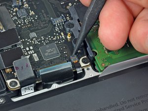

  • Peel the small strip of black tape off the keyboard backlight ribbon cable socket.
Image 1/3: Use your spudger to slide the keyboard backlight ribbon cable out of its socket. Image 2/3: Use your spudger to slide the keyboard backlight ribbon cable out of its socket. Image 3/3: Use your spudger to slide the keyboard backlight ribbon cable out of its socket.
  • Use the tip of a spudger to flip up the cable retaining flap on the ZIF socket for the keyboard backlight ribbon cable.
  • Use your spudger to slide the keyboard backlight ribbon cable out of its socket.
Image 1/1:
  • Use the flat end of a spudger to pry the battery indicator cable connector up off the logic board.
Image 1/1:
  • Use the tip of a spudger to pry the microphone off the adhesive attaching it to the upper case.
1. You have to unscrew one metal detail to get hold of microphone. That is missing.
2. This step coulf also be extended with larger image where it's clear how to grab microphone.
denyspopov - Reply
Image 1/1: Five 3.1 mm Phillips.
  • Remove the following screws:
    • Five 3.1 mm Phillips.
    • Two 3.9 mm Phillips.
    • Two 7 mm Phillips from the DC-in board.
Image 1/2: One 5.5 mm tri-wing screw. Image 2/2: One 13.5 mm tri-wing screw.

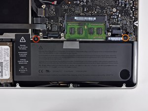

  • Remove the following tri-wing screws securing the battery to the upper case:
    • One 5.5 mm tri-wing screw.
    • One 13.5 mm tri-wing screw.
  • Lift the battery out of the upper case.
I managed to get the logicboard free without removing the battery. Carefully lift the left side of the board and wriggle it away from the ports. Only try this when you have no tri-slotted screwdriver like myself.
Kater - Reply
Image 1/2: Pull the logic board away from the side of the upper case and remove it, minding the DC-in board that may get caught. Image 2/2: Be careful not to rip out the fragile connector plug of the microphone assembly.
  • Lift the logic board from its left edge and raise it until the ports clear the side of the upper case.
  • Pull the logic board away from the side of the upper case and remove it, minding the DC-in board that may get caught.
  • Be careful not to rip out the fragile connector plug of the microphone assembly.
When putting the logic board back in place, it's easier to angle the mic down in it's place as you are placing the board in, rather than after the board is seated.
amiller770 - Reply

Image 1/1:
  • Peel the tape off covering the microphone cable connector.
Is there a way to replace the microphone cable connector on the logic board without replacing the whole logic board. Mine suddenly broke so I have no where to insert the microphone cable.
christine - Reply
Image 1/2: Deroute the microphone cable from the channel in the left speaker. Image 2/2: Deroute the microphone cable from the channel in the left speaker.
  • Use the flat end of a spudger to pry the microphone cable connector up off the logic board.
  • Deroute the microphone cable from the channel in the left speaker.
