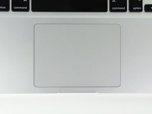

Introduction
Use this guide to replace a broken trackpad.

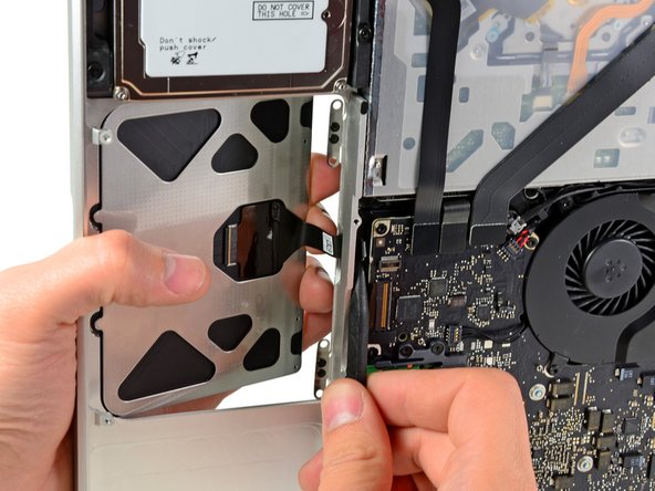

  • Use the flat end of a spudger to carefully pry the trackpad connector up from its socket on the logic board.
Image 1/1:

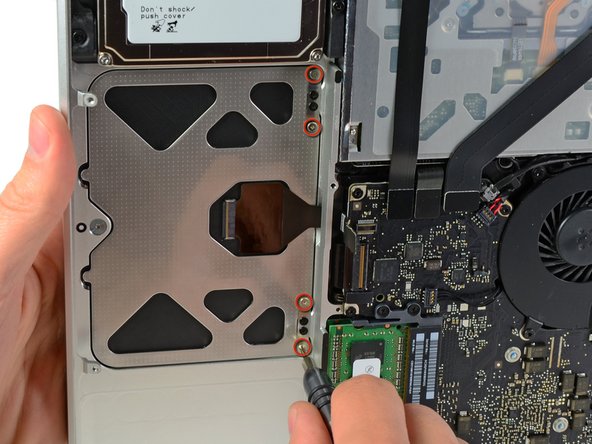

  • While holding the edge of the trackpad closest to the logic board with one hand, remove the four 1.2 mm Phillips screws highlighted in red.
I ordered some tools from iFixit for replacement of the trackpad but the Phillips #00 Screwdriver named above is still too big for the (tiny) screws of the trackpad. Shouldn't that be a Philips #000?
sleutelman - Reply
I have a macbook pro 15 inch unibody from 2010-2011, do you think it would work to use that trackpad as an replacement for my 13 inch 2012-2013
Filip - Reply
A word of caution if you are replacing your trackpad due to a bulging battery. This guide assumes that the original mounting tabs are not damaged and it does not look like the iFixit trackpad replacement kit comes with new tabs. My MBP had a bulging battery, which pushed up on the bottom of my trackpad, deforming one of these tabs. Now that I have removed the battery, the trackpad still works, but it is not flush with the case and the physical clicks are not as responsive as I would like. Does iFixit sell just the replacement tabs?
Matt Marchese - Reply
Same here luckily the trackpad still works but the taps have deformed. Anyone find a place to pick up just those tabs? Edit: found them MacBook Pro Unibody (Mid 2009 through Mid 2012) Trackpad Mounting Screws
iAndrewC -
Be careful with this step. The very tiny screws are very hard to remove with a #00 screwdriver. I tried with mine and I mashed the srews heads, it was then very very hard to remove it. Better to use a #000 screwdriver. If the heads are mashed like me, I suggest you use a 0.1 flat screwdriver, it worked well in my case.
Jonathan - Reply

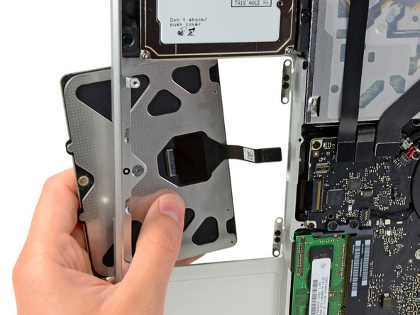

Image 1/3: Carefully push the trackpad connector and cable down through the slot cut into the upper case.
  • If necessary, carefully dislodge the edge of the trackpad closest to the keyboard from its recess in the upper case by pushing it away from the brackets attached to the upper case.
  • Carefully push the trackpad connector and cable down through the slot cut into the upper case.
  • It may be necessary to use a spudger to help get the trackpad connector past the edge of the logic board.
  • Once the cable has been completely pulled through its slot in the upper case, pull the trackpad away from the outer edge of the upper case and remove it from the machine.
Image 1/1:
  • When installing your new trackpad, routing the cable through the upper case and past the logic board may be difficult. It is helpful to use the tip of a spudger to guide the connector past the logic board while pushing the cable through its slot in the upper case with your other hand.
Image 1/2: Tighten the screws all the way, then back them out about 1/4 turn.
  • Next, reinstall the four 1.2 mm Phillips screws along the inner edge of the trackpad.
  • Tighten the screws all the way, then back them out about 1/4 turn.
  • Check the alignment of the trackpad on the keyboard side of the upper case. Once you have centered the trackpad in the upper case, tighten the four Phillips screws all the way.
trackpad still doesn't click. I've tried two separate parts.. but what makes it pop back up after depressing the pad? It just lays there. I've taken it apart four times to adjust the tork screw... nothing. HELP!
Gail - Reply
My trackpad was driving me up the wall, bouncing all over the place. Ifixit Trackpad comes with extra screws, hinge and adjuster. You won't believe how tiny these screws are! If one falls in the carpet-it's GONE! Bless you Ifixit! To center when re-installing adjust by sliding a thin piece of paper (scotch tape?), under bottom of trackpad, let Trackpad rest on it's own weight and then tighten one top and bottom screw a little bit, and eyeball it, just the tiniest crack of daylight on each side. I strongly suggest the highest quality magnetic screwdriver you can find. The little torx screw disc is an adjuster. If too tight, trackpad won't 'click.' On a Mac, click is not really essential as long as tap and slide are working right. Needs a small amount of clearance. When properly installed you can 'feel' the click if it's right. Probably won't need to mess with it at all. Now my trackpad works like it should, I am a happy camper!
ovenwally - Reply
I replaced the trackpad with a new one: the arrow moves but was not possible to click. I putted back the old trackpad and it works with. The solution: the eleventh picture shown a gray Torx type screw to the left of the connector where there is the recess in the back of the mouse. This screw is used to increase or decrease the depth of clicks. in my case it was too screwed and it was as if I held continually pressed the truckpad: therefore, it was enough to loosen it. At this point I ask myself since in the old truckpad I had problems with the physical click, I probably would have been enough to adjust the screw.
caronte88 - Reply
ifitit is once again amazing. My trackpad just stopped working on my four year old machine. Bought a new trackpad from iFitit, followed the guide and now I have a functional laptop again. One thing to note. 1.2mm is small very, very small. The screws for the trackpad *will* get lost if they fall of the table. Make sure that doesn't happen.
Jerry - Reply
