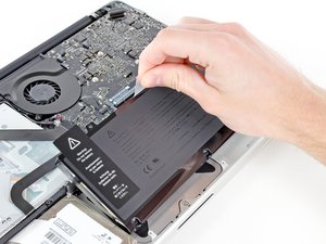

Remove the following ten screws:
Three 14.4 mm Phillips #00 screws
Three 3.5 mm Phillips #00 screws
Four 3.5 mm shouldered Phillips #00 screws
Use your fingers to pry the lower case away from the body of the MacBook near the vent.
Remove the lower case.
Use the edge of a spudger to pry the battery connector upwards from its socket on the logic board.
Bend the battery cable slightly away from its socket on the logic board so it does not accidentally connect itself while you work.
Remove the following two screws:
One 5.6 mm Tri-wing screw
One 13 mm Tri-wing screw
Carefully peel the battery warning label off the upper case between the battery and the optical drive.

Step 3
Is this step of removing the battery connector required?
manodh - Reply
yes - as with disassembly of any electronic component you have to remove any power source. You don't want to accidentally turn the Mac on
khull -
This step is not really required. Apple does not recommend it.
Steven Layton - Reply
My Battery does not get recognized after i disconnected it, screw this site!
Diego Hernandes -
Rather than be careful of the corners of the connector i would say don't use the spudger anywhere near the corners. While the corner looks like the obvious place to begin to pry it up from, it will break. Levering from the sides as the instructions suggest works well.
ausmkv - Reply
wonder why apple does not recommend it?!
Peter - Reply
I would recommend it, one careless short and the whole board is dead......
John - Reply
simply remove the battery rather than disconnecting the cable
toiu - Reply
Don't know what the deal is with the battery, but this IS a necessary step to keep from frying the logic Board if you accidentally touch something and short it out. I did this step every time during my troubleshooting and The battery was ALWAYS recognized by the system the next time I turned the MBP on. So be safe and don't fry your logic board in the process...
fasthans - Reply
Prying the battery connector off does not take much force. I did exactly what the guide suggested (walked it off back and forth) with the spudger without any problems. Just be very gentle, much like with anything inside laptops, they are very fragile and need to be worked with carefully. A+ instructions, battery replacement was a success.
aekinaka - Reply
Installed/upgraded 4gb RAM to the system maximum 16gb and installed a 500 gb SSD today....DID NOT disconnect the battery cable....no issues at all when I powered back up. Then did a clean install of OSX Yosemite....next I used a time machine backup to put all my stuff back on the new HD. From start to finish it took about 4 hours. Macbook boots up right at 16 seconds now.
MacProUser - Reply
Easiest to use two spudgers, one on each short end, I found.
Simon Mundy - Reply
I took off th Airport /Bluetooth connectors but the number J3 connector is broken and so where can i buy J3 connecter for the Airport/bluetooth board
Zeerachen - Reply
Its a lot easier and safer (corner wise) to pry it using the flat side of the black spudger directly in front of the connector (don't go/use the corners) very easily you will be able to pry it further by inserting the spudger into a better and thicker plastic section of the connector
Ed Oliver - Reply
DON'T remove the Battery Cable, you risk the battery NOT being recognised when you start the Mac up again, or breaking it!! More to the point, APPLE DOES NOT RECOMMEND THIS, so don't do it! I Installed 2x 8GB ( 16Gb total) of Crucial Mac RAM at 1333Mhz for my Late 2011 MacBook Pro, and it works beautifully, fully recognised and working well. I followed these instructions, but as Apple didnt recommend disconnecting the battery, I skipped this step, and as well as taking less time, nothing was damaged or broken, and everything works perfectly!!! Just make sure that you DISCHARGE ALL STATIC ELECTRICITY FROM YOUR HANDS, by touching a metal surface in the Mac. Apple recommends the edge of the Optical Disk Drive ( Big silver thing ) before touching any parts. Also, Take care removing the RAM out of its packet, DO NOT touch the Gold connectors, and hold the RAM by the edges. Finally, be PATIENT, GENTLE and it should all go perfectly. I managed it first time, with no technical ability, so follow my advice. Good luck!
Bradley Marks - Reply
Followed the tuto Step by step. Disconnected the battery (quite easily).
No problem when I lit the Mac on again. Battery's here, date's right.
nichoferr - Reply
