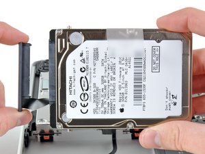

Image 1/1: Don't try to completely remove the hard drive just yet. It is still attached to the hard drive cable.
  • Use the attached pull tab to lift the hard drive out of the upper case.
  • Don't try to completely remove the hard drive just yet. It is still attached to the hard drive cable.
Image 1/2: Remove the hard drive. Image 2/2: Remove the hard drive.
  • Pull the hard drive cable away from the body of the hard drive.
  • Remove the hard drive.

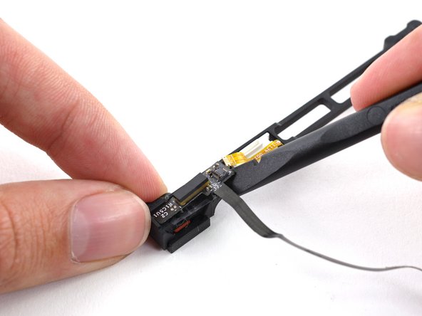

Image 1/3: Use the tip of a spudger to flip the ZIF connector on the hard drive cable. Image 2/3: Gently pull the sensor bracket cable out of the ZIF connector. Image 3/3: Use the flat end of a spudger to pry the hard drive cable up off the sensor bracket.
  • Your replacement part may or may not come with the front (sensor) bracket. If it does not, you'll need to transfer it to your new cable.
  • Use the tip of a spudger to flip the ZIF connector on the hard drive cable.
  • Gently pull the sensor bracket cable out of the ZIF connector.
  • Use the flat end of a spudger to pry the hard drive cable up off the sensor bracket.
  • Remove the adhesive backing from your new hard drive cable, stick it onto the sensor bracket, and connect the sensor bracket cable.
This section is backwards, do not try to remove the IR sensor ZIF connector until you have removed the hard drive cable gently from the bracket as @Skyynet says above, by using a "fingernail (or the spudger) and lift the side of the socket opposite to the cable" gently, it's glued on. Then you can wiggle the ZIF connector off of the hard drive cable with your fingers.
bwanamarko - Reply
My apologies, I was incorrect in my previous comment. The ZIF connector is a little flap on the hard drive cable that can be opened by flipping it up. This makes extracting the IR sensor easier. Removing the hard drive cable from the bracket may also make removing the IR sensor from the ZIF connector, but only if you've opened the flap. The new cable should already have the flap of the ZIF connector open, so make sure to close it. But does anyone know how you can tell if the IR sensor is connected? It's so small it's hard to tell if it can slide in further.
bwanamarko - Reply
Also note there are 3 photos in this step, you can view them by hovering over each one. Click to enlarge.
bwanamarko - Reply
Very nice set of close up photos of the hard drive cable IR sensor ZIF connectory are here: https://discussions.apple.com/thread/708...
bwanamarko - Reply
I would recommend using tweezers that come with the ifixit tool kit to properly insert the sensor bracket cable back into the sensor bracket. I had trouble with my computer in which the solution was that this step was not executed properly in my repair of the hard drive cable installation. I encourage everyone to make sure the bracket is fully and properly put back in the bracket otherwise the hard drive will appear to malfunction.

Step 14: Note how far in the yellow tab of the sensor bracket cable goes into the ZIF connector before pulling it out. Reinserting was a little difficult, but looking at the photo at full size helped. When all the way in, there will be a line of gold running just in front of the connector. Overall, great instructions and photos. Thank you so much.
Sue Livingston - Reply
