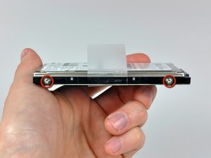

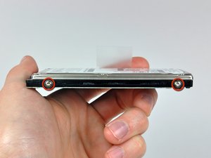

Image 1/2: You'll need to transfer these screws to your new hard drive if you're changing drives.
  • Remove the two T6 Torx screws from each side of the hard drive (four screws total).
  • You'll need to transfer these screws to your new hard drive if you're changing drives.
  • If you are installing a new hard drive, we have an OS X install guide to get you up and running.
Does anyone know how I can get another set of the T6 screws I took out of my old HD? I forgot to save them and now my new SSD rattles around in the laptop!
help
TimAndSusanna Decker - Reply
Have you tried calling your local Apple store? The screws Apple uses throughout their devices are usually machined in large quantities of "odd" lengths that are not easily (if at all) found anywhere but from them. Good luck!
Andy -
Hi there. We sell the Screw Set for the MBP 13" Mid 09 which includes the hard drive T6 screws you require. Hope this helps.
Walter Galan -
Are the screws for the hard drive available along? The problem is that the only answer I'm seeing (from Walter above) is a $59 for the 4 screws needed, there has to be a more economical choice.
Any assistance would be appreciated.
alfredperlstein - Reply
