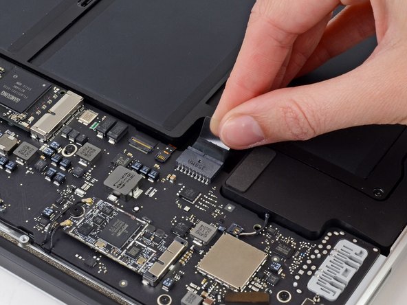

Image 1/2: Do not lift upward on the connector as you disconnect it.
Edit Step 3 Battery  ¶
  • Grab the clear plastic pull tab attached to the battery connector and pull it toward the front edge of the Air to disconnect the battery from the logic board.
  • Do not lift upward on the connector as you disconnect it.

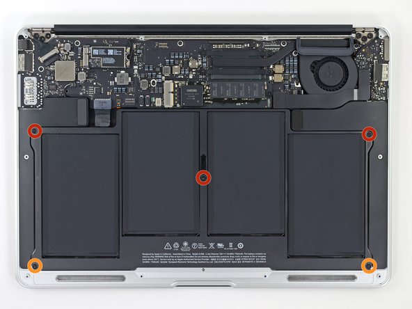

Image 1/1: Three 6.3 mm T5 Torx screws
Edit Step 4  ¶
  • Remove the following five screws securing the battery to the upper case:
    • Three 6.3 mm T5 Torx screws
    • Two 2.4 mm T5 Torx screws

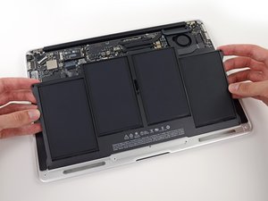

Image 1/1: Lift the battery from its edge nearest the logic board and remove it from the upper case.
Edit Step 5  ¶
  • When handling the battery, avoid squeezing or touching the four exposed lithium polymer cells.
  • Lift the battery from its edge nearest the logic board and remove it from the upper case.

These pentalobe screw sizes can't possibly be right - not even close. Should they perhaps be 0,8 mm and 1,2 mm?
Rulle Boer - Reply
The screw sizes refer to the length of the shaft, not the diameter of the head or socket. P5 is the standard pentalobe size for all these screws, regardless of length.
I agree that the notation is a little confusing. I think it's because, with standard sized hardware like for your house, you have shaft diameter (say 1/8" or 3mm) and shaft length (say 3" or 7.5cm). So we're programmed to think of small numbers like that as diameter. But in this case, they're length.
budpegasus - Reply
