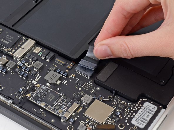

Edit Step 3 Battery Connector  ¶
Image 1/2: Grab the clear plastic pull tab attached to the battery connector and pull it toward the front edge of the Air to disconnect the battery from the logic board.
  • To ensure that everything is de-energized and won't turn on while you're working, it is recommended that you disconnect the battery.
  • Grab the clear plastic pull tab attached to the battery connector and pull it toward the front edge of the Air to disconnect the battery from the logic board.
  • Do not lift upward on the connector as you disconnect it.

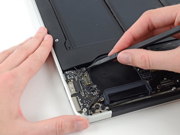

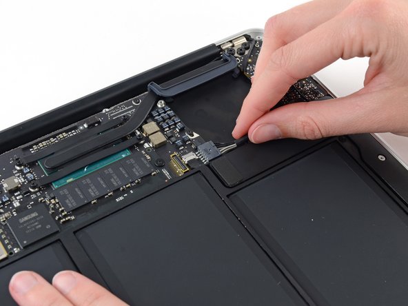

Edit Step 4 I/O Board Cable  ¶
Image 1/1:
  • Use the flat end of a spudger to pry the I/O board cable connector up out of its socket on the I/O board.

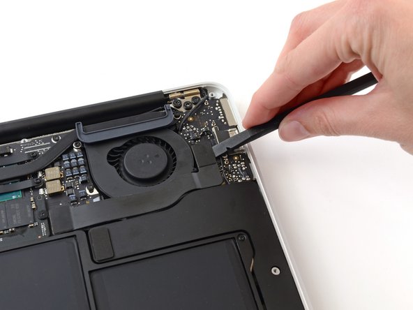

Edit Step 5  ¶
Image 1/1:
Edit Step 5  ¶

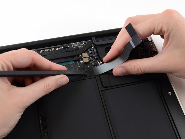

  • Carefully peel the I/O board cable from the adhesive securing it to the top of the fan.

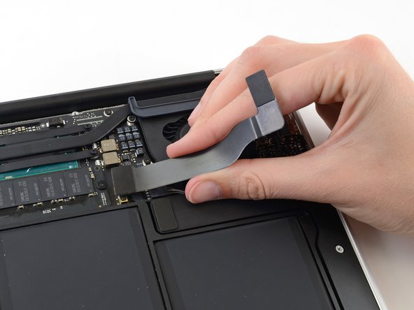

Edit Step 6  ¶
Image 1/2: While gently pulling the I/O board cable upward near its connection to the logic board, use the flat end of a spudger to pry up on alternating sides of the connector to help "walk" it out of its socket.
Edit Step 6  ¶
  • The following connector has an especially deep socket. Use care when disconnecting it.
  • While gently pulling the I/O board cable upward near its connection to the logic board, use the flat end of a spudger to pry up on alternating sides of the connector to help "walk" it out of its socket.
  • Remove the I/O board cable.

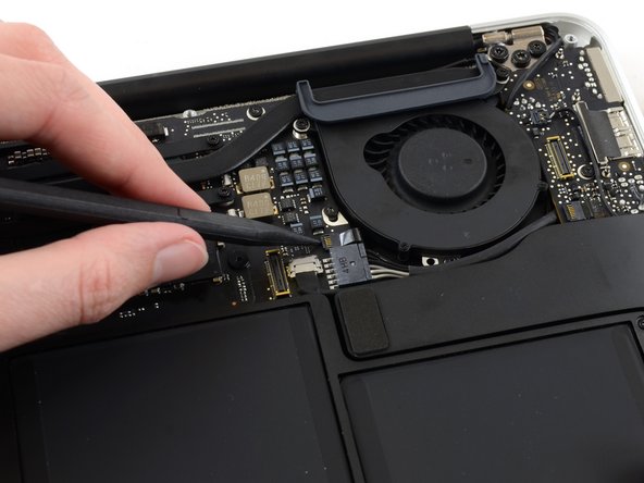

  • Use the tip of a spudger to carefully flip up the retaining flap on the fan cable ZIF socket.

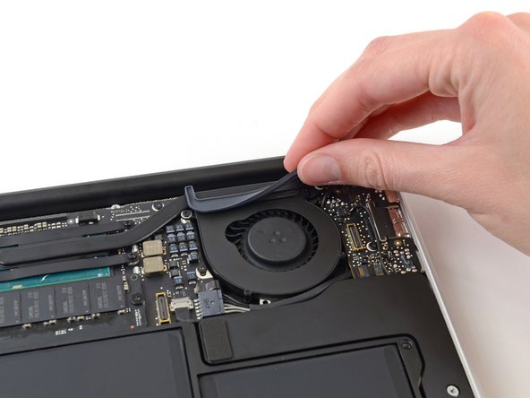

  • Peel the rubber gasket off the adhesive on the top of the fan.

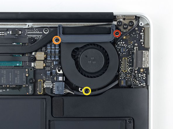

Edit Step 9  ¶
Image 1/1: One 3.6 mm T5 Torx screw
Edit Step 9  ¶
  • Remove the following three screws securing the fan to the upper case:
    • One 3.6 mm T5 Torx screw
    • One 2.7 mm T5 Torx screw
    • One 3.6 mm T5 Torx screw with a short head

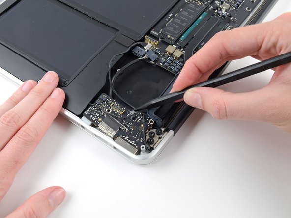

Edit Step 11 I/O Board  ¶
Image 1/1: Pull the cable parallel to the face of the logic board toward the right edge of the Air.

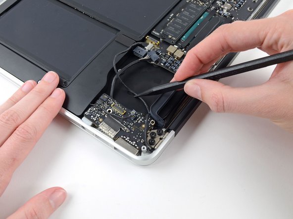

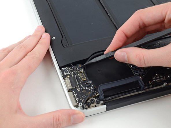

  • Disconnect the I/O board by pulling its power cable away from its socket on the logic board.
  • Pull the cable parallel to the face of the logic board toward the right edge of the Air.

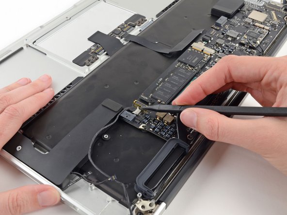

Edit Step 12  ¶
Image 1/2: Pry up from beneath the wires.
Edit Step 12  ¶
  • Use the flat end of a spudger to pry the left speaker cable connector up and out of its socket on the I/O board.
  • Pry up from beneath the wires.

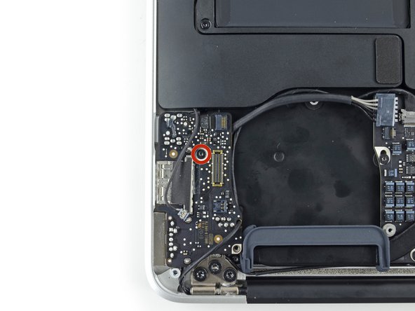

Image 1/1:
1 Edit Step 14  ¶
  • Remove the single 3.6 mm T5 Torx screw securing the I/O board to the upper case.

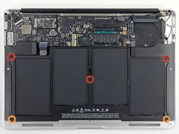

Edit Step 17 Battery  ¶
Image 1/1: Three 6.3 mm T5 Torx screws
  • Remove the following five screws securing the battery to the upper case:
    • Three 6.3 mm T5 Torx screws
    • Two 2.4 mm T5 Torx screws

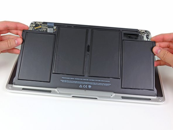

Edit Step 18  ¶
Image 1/1: Lift the battery from its edge nearest the logic board and remove it from the upper case.
Edit Step 18  ¶
  • When handling the battery, avoid squeezing or touching the four exposed lithium polymer cells.
  • Lift the battery from its edge nearest the logic board and remove it from the upper case.

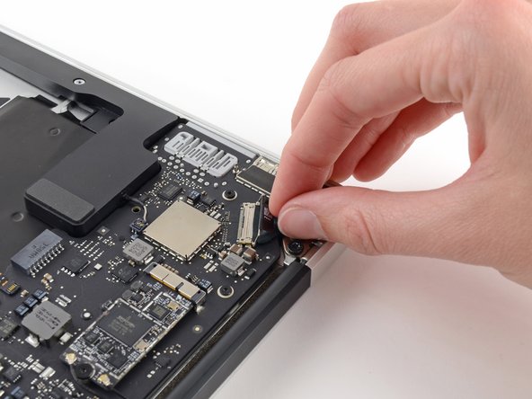

Edit Step 21  ¶
Image 1/2:
Edit Step 21  ¶
  • Use the flat end of a spudger to pry both antenna cable connectors up and off their sockets on the AirPort/Bluetooth card.

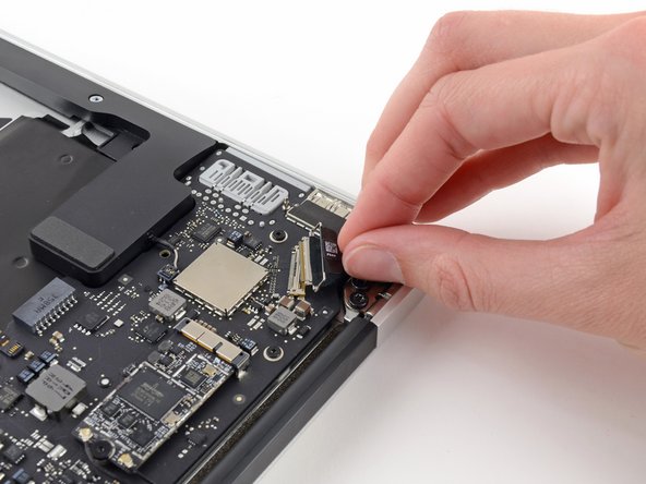

Edit Step 22  ¶

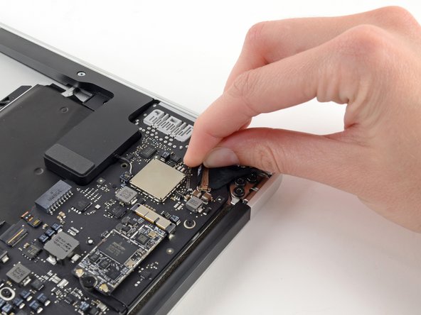

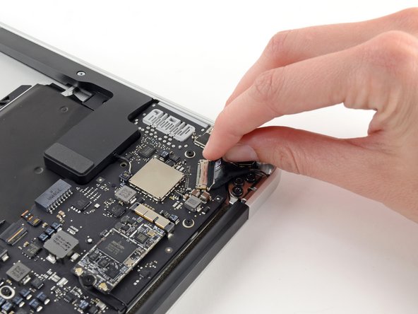

Image 1/2: Push first on one side of the connector, then on the other side to carefully "walk" it out of its socket.
Edit Step 22  ¶
  • Disconnect the camera cable connector with the tip of a spudger.
  • Push first on one side of the connector, then on the other side to carefully "walk" it out of its socket.
  • Pull the camera cable parallel to the face of the I/O board toward the front edge of the Air to disconnect it from its socket.
  • Do not lift upward on this cable as you disconnect it, as its socket may break off the logic board.

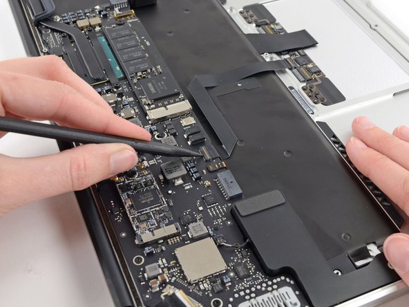

Edit Step 23  ¶
Image 1/2: Be sure you are prying up on the hinged retaining flap, '''not''' the socket itself.
Edit Step 23  ¶
  • Use the tip of a spudger or your fingernail to flip up the retaining flap on the trackpad ribbon cable ZIF socket.
  • Pull the trackpad ribbon cable straight out of its socket toward the front edge of the Air.

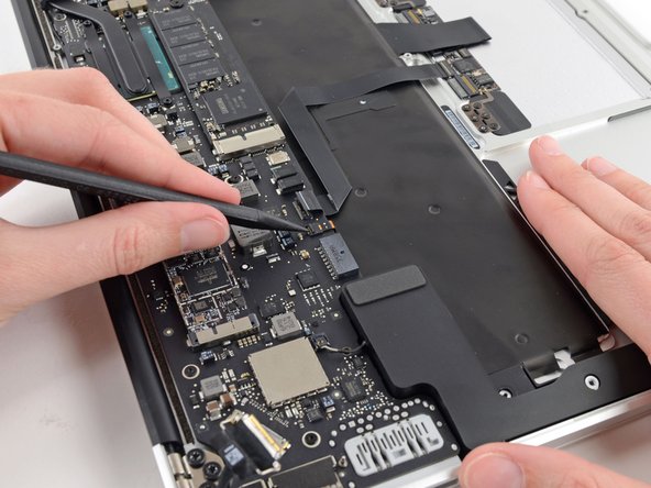

Image 1/3: Be sure you are prying up on the hinged retaining flap, '''not''' the socket itself.
Edit Step 24  ¶
  • Use the tip of a spudger to flip up the retaining flap on the keyboard backlight ribbon cable ZIF socket.
  • Use your spudger to gently pull the keyboard backlight ribbon cable out of its socket.

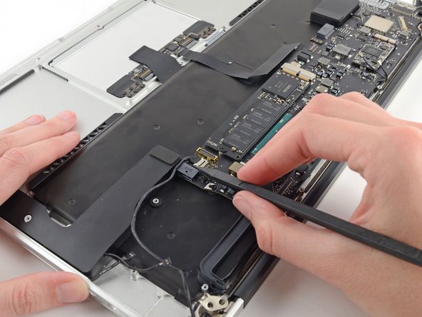

Edit Step 25  ¶

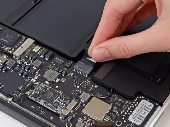

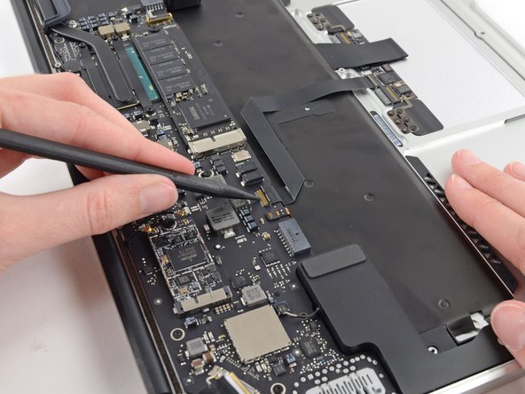

Image 1/1: It is recommended to pry up from beneath the cables.
Edit Step 25  ¶
  • Use the flat end of a spudger to pry the right speaker cable connector up and out of its socket on the logic board.
  • It is recommended to pry up from beneath the cables.

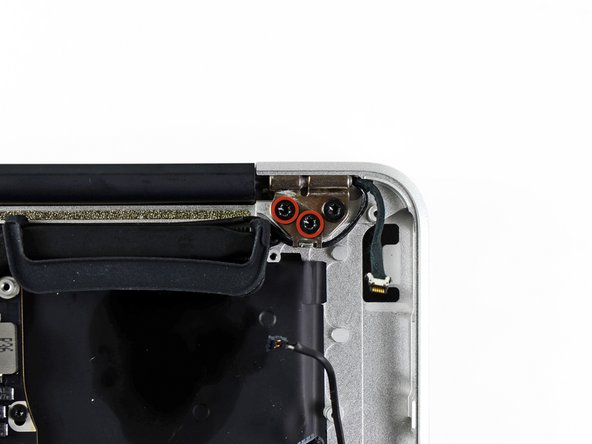

  • Remove the inner two 4.9 mm T8 Torx screws securing the antenna cable retainer and left clutch hinge to the upper case.
Edit Step 28  ¶

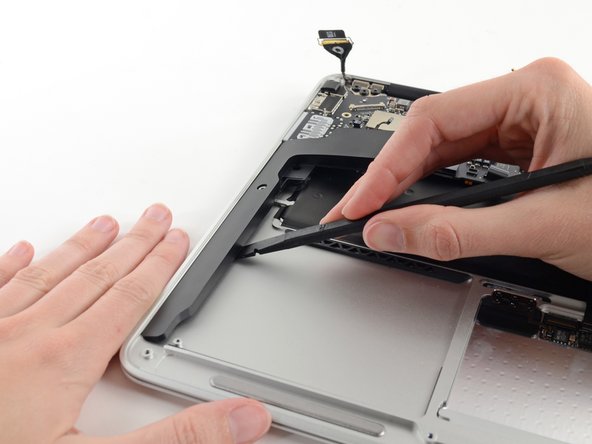

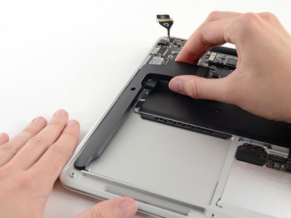

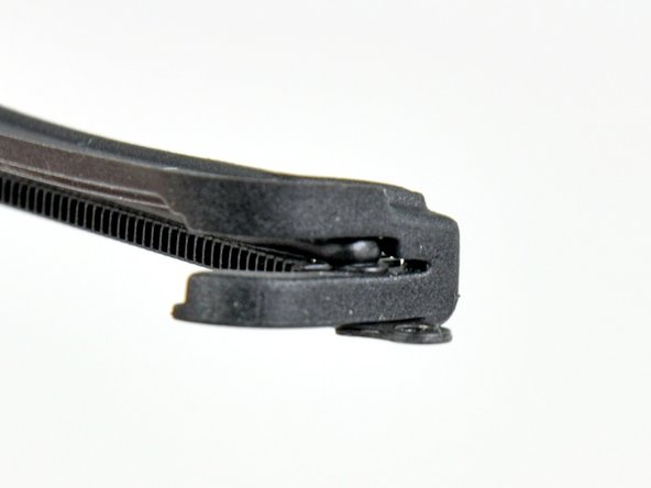

Image 1/3: Remove the right speaker from the upper case.
Edit Step 29  ¶

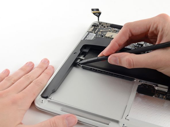

  • Slide the flat end of a spudger under the right speaker from the end nearest the hinge to the front edge of the Air to loosen the adhesive.
  • Remove the right speaker from the upper case.

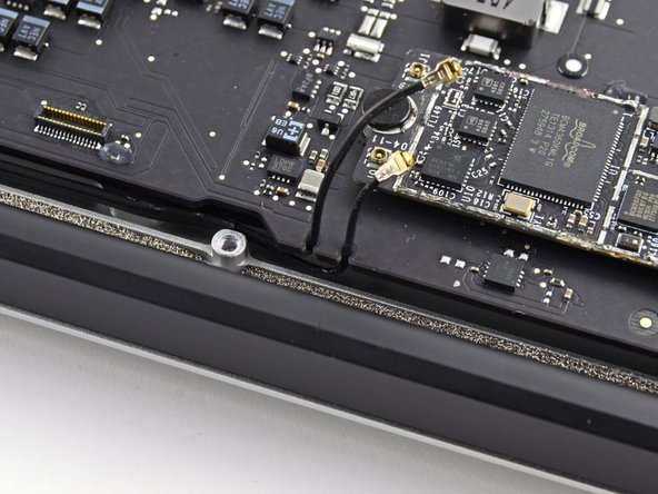

Image 1/2: During reassembly, make sure the antenna cables are inserted into their respective notches on the logic board, as highlighted in the second picture.
Edit Step 30  ¶

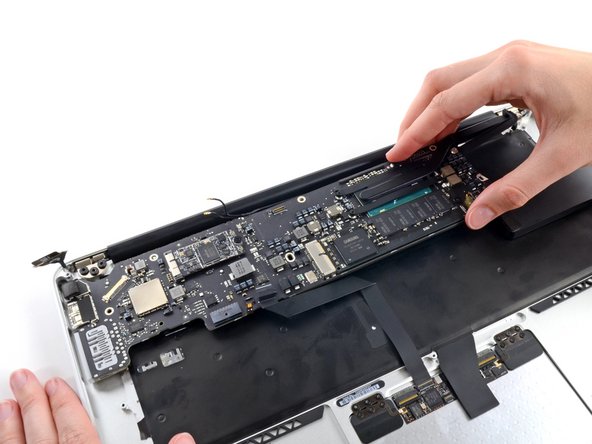

  • Carefully remove the logic board assembly from the upper case, minding any cables that may get caught.
  • During reassembly, make sure the antenna cables are inserted into their respective notches on the logic board, as highlighted in the second picture.

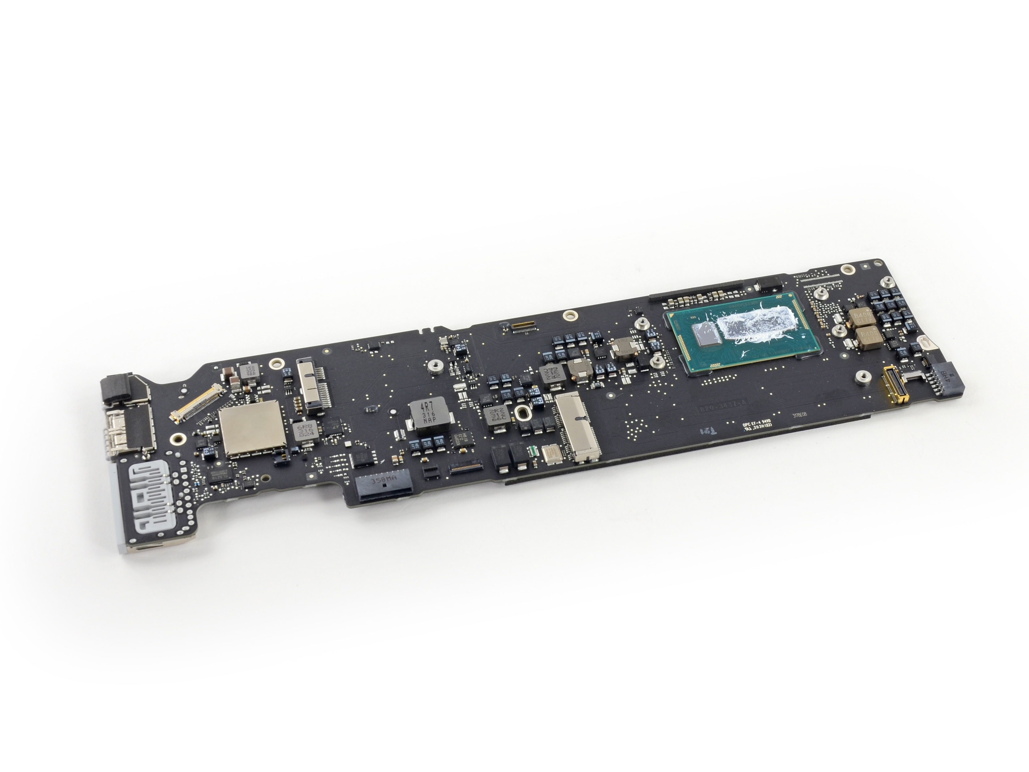

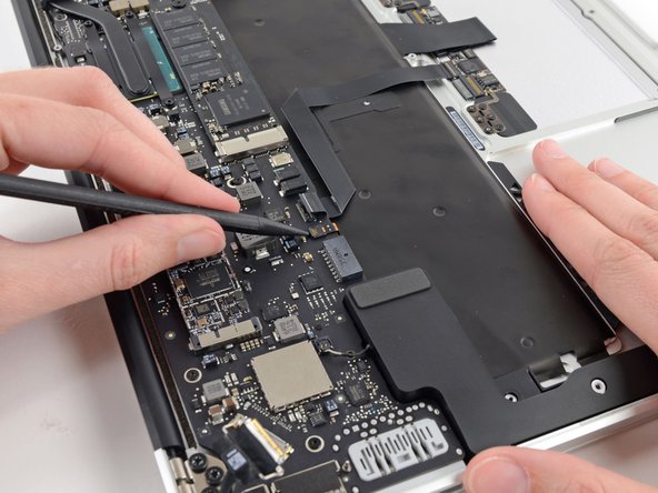

Edit Step 31 Logic Board  ¶
Image 1/1:

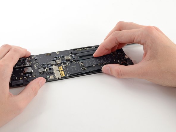

  • Remove the single 2.85 mm T5 Torx screw securing the SSD to the logic board.

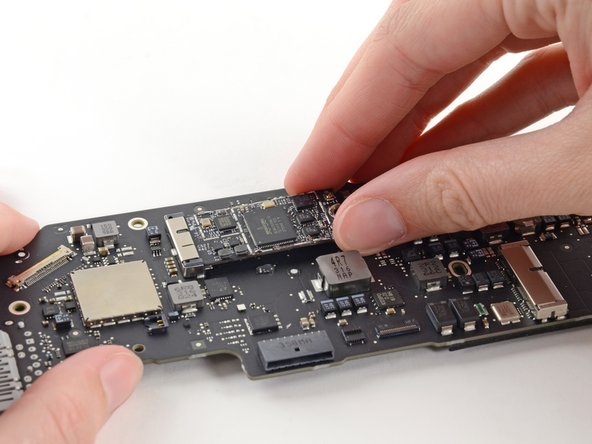

Edit Step 32  ¶
Image 1/2: Pull the drive straight out of its socket and remove it from the logic board.
Edit Step 32  ¶
  • To avoid damaging its socket, do not lift the end of the SSD excessively.
  • Pull the drive straight out of its socket and remove it from the logic board.
  • When reinstalling the SSD, be sure it is properly seated before reinstalling its retaining screw.

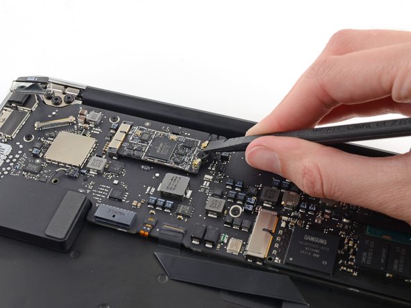

  • Remove the single 2.9 mm T5 Torx screw securing the AirPort/Bluetooth board to the logic board.
Edit Step 34  ¶

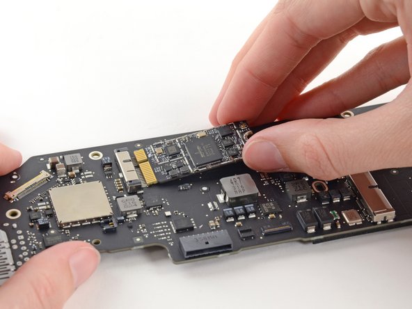

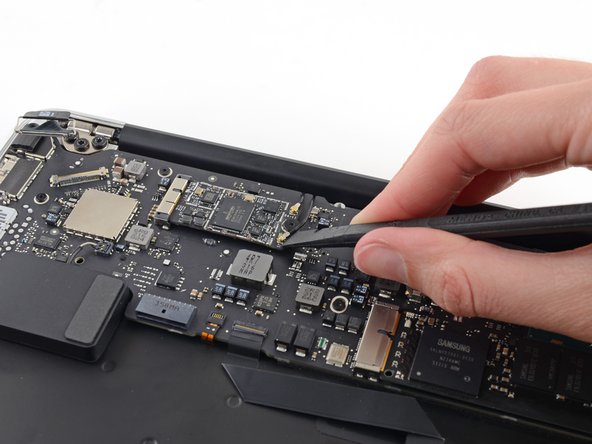

Image 1/2: Slightly lift the free end of the AirPort/Bluetooth board and pull it out of its socket on the logic board.
Edit Step 34  ¶
  • To avoid damaging its socket, do not lift the end of the AirPort/Bluetooth board excessively.
  • Slightly lift the free end of the AirPort/Bluetooth board and pull it out of its socket on the logic board.
  • Remove the AirPort/Bluetooth board from the logic board.

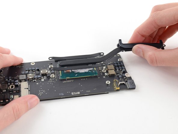

Edit Step 36  ¶

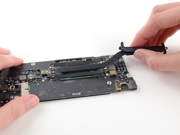

Image 1/2: Remove the heat sink from the logic board.
Edit Step 36  ¶
  • If the heat sink seems to be stuck to the logic board after removing all four screws, use a spudger to carefully separate the heat sink from the faces of the CPU and GPU.
  • Remove the heat sink from the logic board.

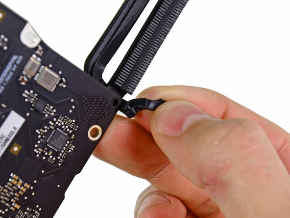

  • When reinstalling the heat sink, be sure to apply a new layer of thermal paste. If you have never applied thermal paste before, we have a guide that makes it easy.

Image 1/3: The tail of the gasket should fit into the notch in the heat sink, it should not end up underneath the heat sink tab that will rest on the logic board.
Edit Step 37  ¶
  • When reassembling your device, be sure the heat sink's rubber gasket is installed correctly. The nub on the gasket should mate with the hole cut into the logic board near the heat sink fins.
  • The tail of the gasket should fit into the notch in the heat sink, it should not end up underneath the heat sink tab that will rest on the logic board.

I did not find it necessary to loosed the retainer flap, unplug the ribbon cable from it's socket, or remove the fan. After removing the fan screws in Step 9, the fan was loose enough that it can be slightly moved to the side. I felt that loosening the retaining flap and removing the fan adds unnecessary potential to damage something. To the contrary, if you bump the fan while it's plugged in, you might damage the ribbon cable.
michaelkkruger - Reply
It is a lot easier to insert the flat ribbon in its socket before placing the fan back in place. BUT DO NOT YET FLIP BACK the retaining flap, until you have seated and screwed the fan. This way in case you pull on the fan by mistake, the flat ribbon is free to come out, otherwise you may tear it.
Rany - Reply
I did not find it necessary to remove the fan or unplug the ribbon cable from it's socket. After removing the fan screws, the fan was loose enough that it can be slightly moved to the side. I felt that loosening the retaining flap and removing the fan adds unnecessary potential to damage something. To the contrary, if you bump the fan while it's plugged in, you might damage the ribbon cable.
