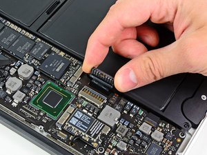

Image 1/2: Use the flat end of a spudger to pry both short sides of the battery connector upward to disconnect it from its socket on the logic board. Image 2/2: Bend the battery cable slightly away from the logic board so the connector will not accidentally contact its socket.
  • In this step you will disconnect the battery to help avoid shorting out any components during service.
  • Use the flat end of a spudger to pry both short sides of the battery connector upward to disconnect it from its socket on the logic board.
  • Bend the battery cable slightly away from the logic board so the connector will not accidentally contact its socket.

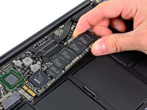

  • Remove the single 2.9 mm T5 Torx screw securing the SSD to the logic board.

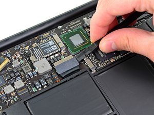

Image 1/2: Do not lift the end of the SSD excessively. Image 2/2: Pull the drive straight out of its socket and remove it from the logic board.
  • Use a spudger to help lift the free end of the SSD just enough to grab it with your other hand.
  • Do not lift the end of the SSD excessively.
  • Pull the drive straight out of its socket and remove it from the logic board.
  • When reinstalling the SSD, be sure it is properly seated before reinstalling its retaining screw.
