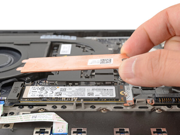

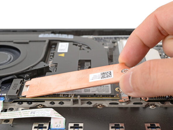

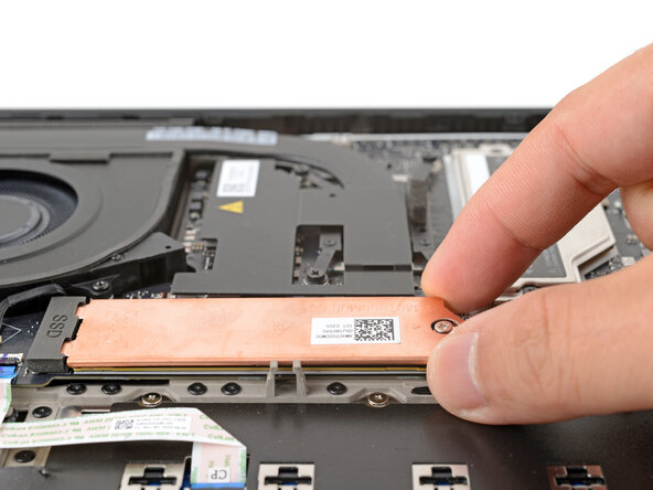

  7. Lenovo ThinkPad T14 Gen 7 SSD Replacement, Remove the SSD cover: step 7, image 1 of 1
    • Use a Phillips screwdriver to loosen the captive screw securing the SSD cover.
  8. Lenovo ThinkPad T14 Gen 7 SSD Replacement: step 8, image 1 of 3 Lenovo ThinkPad T14 Gen 7 SSD Replacement: step 8, image 2 of 3 Lenovo ThinkPad T14 Gen 7 SSD Replacement: step 8, image 3 of 3
    • Lift the right edge of the SSD cover slightly and slide the cover away from the socket to clear the tabs.
    • Remove the SSD cover.
  9. Lenovo ThinkPad T14 Gen 7 SSD Replacement: step 9, image 1 of 2 Lenovo ThinkPad T14 Gen 7 SSD Replacement: step 9, image 2 of 2
    • Lift the right edge of the SSD slightly and pull it out of its socket.
    • Remove the SSD.
