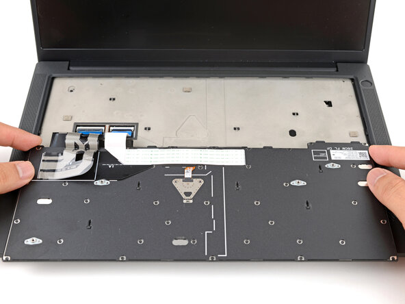

  6. Lenovo ThinkPad T14 Gen 7 Keyboard Replacement: step 6, image 1 of 3 Lenovo ThinkPad T14 Gen 7 Keyboard Replacement: step 6, image 2 of 3 Lenovo ThinkPad T14 Gen 7 Keyboard Replacement: step 6, image 3 of 3
    • Flip the keyboard over so the keys rest on the touchpad, being careful not to strain the two flex cables.

  8. Lenovo ThinkPad T14 Gen 7 Keyboard Replacement, Disconnect the keyboard cables: step 8, image 1 of 3 Lenovo ThinkPad T14 Gen 7 Keyboard Replacement, Disconnect the keyboard cables: step 8, image 2 of 3 Lenovo ThinkPad T14 Gen 7 Keyboard Replacement, Disconnect the keyboard cables: step 8, image 3 of 3
    • Use your fingernail or the flat end of a spudger to flip up the locking flaps on the two ZIF connectors.
  9. Lenovo ThinkPad T14 Gen 7 Keyboard Replacement: step 9, image 1 of 3 Lenovo ThinkPad T14 Gen 7 Keyboard Replacement: step 9, image 2 of 3 Lenovo ThinkPad T14 Gen 7 Keyboard Replacement: step 9, image 3 of 3
    • Slide the two cables out of their sockets to disconnect them.
    • During reassembly, slide each cable fully into its socket.
  10. Lenovo ThinkPad T14 Gen 7 Keyboard Replacement, Remove the keyboard: step 10, image 1 of 1
    • Remove the keyboard.
