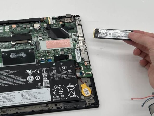

  3. Lenovo ThinkPad T14 Gen 1 SSD Replacement, SSD: step 3, image 1 of 3 Lenovo ThinkPad T14 Gen 1 SSD Replacement, SSD: step 3, image 2 of 3 Lenovo ThinkPad T14 Gen 1 SSD Replacement, SSD: step 3, image 3 of 3
    • Use a Phillips #1 screwdriver to remove the 3.3 mm screw securing the SSD.
  4. Lenovo ThinkPad T14 Gen 1 SSD Replacement: step 4, image 1 of 2 Lenovo ThinkPad T14 Gen 1 SSD Replacement: step 4, image 2 of 2
    • Gently slide the SSD from the slot.
    • Be sure not to scratch or bend the gold end of the SSD.
