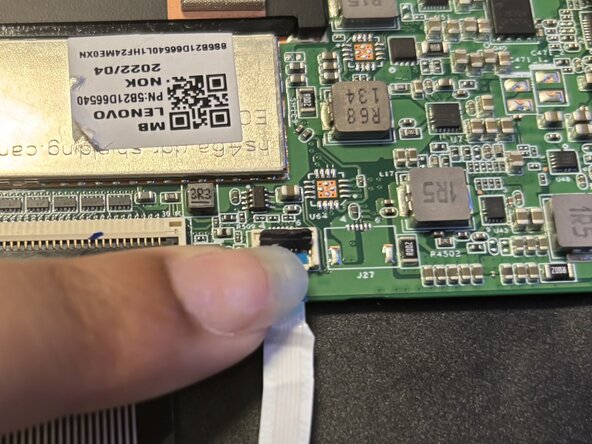

  10. Lenovo IdeaPad Flex 5 Chromebook Touchpad Replacement: step 10, image 1 of 2 Lenovo IdeaPad Flex 5 Chromebook Touchpad Replacement: step 10, image 2 of 2
    • Place your fingernail under the black tab and flick up the black tab that is holding the blue wire.
    • Lightly pull the blue ribbon cable out from the white connector.
    • The blue wire should slide out easily. Don't yank the wires, if it is not sliding out easily.

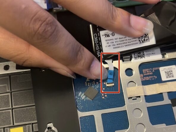

  11. Lenovo IdeaPad Flex 5 Chromebook Touchpad Replacement: step 11, image 1 of 3 Lenovo IdeaPad Flex 5 Chromebook Touchpad Replacement: step 11, image 2 of 3 Lenovo IdeaPad Flex 5 Chromebook Touchpad Replacement: step 11, image 3 of 3
    • Using a fingernail or a prying tool, flick the small black tab up.
    • Pull the blue plastic wire from the white small connector.
