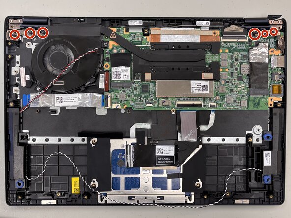

    • Use a Phillips #0 screwdriver to remove the six 7.7 mm-long screws securing the two display hinges.

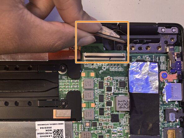

    • Lift up the locking flap on the cable connector with your fingers.
    • Disconnect the display cable from the connector.
