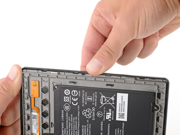

  8. Kobo Libra Colour (N428B) Front Cover Replacement, Disconnect the battery: step 8, image 1 of 2 Kobo Libra Colour (N428B) Front Cover Replacement, Disconnect the battery: step 8, image 2 of 2
    • Use a spudger to pry up and disconnect the battery press connector.
    • Don't pry against the motherboard, as you risk breaking small, surface-mounted components.
    • Your E-ink screen will continue to say Powered off even after disconnection—this is normal!
  9. Kobo Libra Colour (N428B) Front Cover Replacement, Remove the front cover screws: step 9, image 1 of 2 Kobo Libra Colour (N428B) Front Cover Replacement, Remove the front cover screws: step 9, image 2 of 2
    • Use a Phillips screwdriver to remove the two 3.9 mm‑long screws securing the front cover.
    • You don't need to remove the screw next to the charging port.
  10. Kobo Libra Colour (N428B) Front Cover Replacement, Heat the front cover: step 10, image 1 of 3 Kobo Libra Colour (N428B) Front Cover Replacement, Heat the front cover: step 10, image 2 of 3 Kobo Libra Colour (N428B) Front Cover Replacement, Heat the front cover: step 10, image 3 of 3
