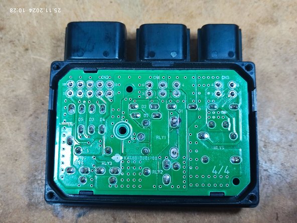

KAWASAKI RELAY ASSY, BOX 27002-0025
  1. KAWASAKI RELAY ASSY, BOX 27002-0025, Power relay: step 1, image 1 of 3 KAWASAKI RELAY ASSY, BOX 27002-0025, Power relay: step 1, image 2 of 3 KAWASAKI RELAY ASSY, BOX 27002-0025, Power relay: step 1, image 3 of 3
    • What is required: Phillips 02, soldering iron or station, and a desoldering tool;
    • Cleanly de-solder all 20 pins, otherwise the board cannot be removed.
  2. KAWASAKI RELAY ASSY, BOX 27002-0025: step 2, image 1 of 3 KAWASAKI RELAY ASSY, BOX 27002-0025: step 2, image 2 of 3 KAWASAKI RELAY ASSY, BOX 27002-0025: step 2, image 3 of 3
    • Replace defective relay (already de-soldered here) with replacement type: G5LE-1
    • Reinsert the circuit board, re-solder the 20 pins cleanly.
Work through the steps in reverse order to reassemble your device.
