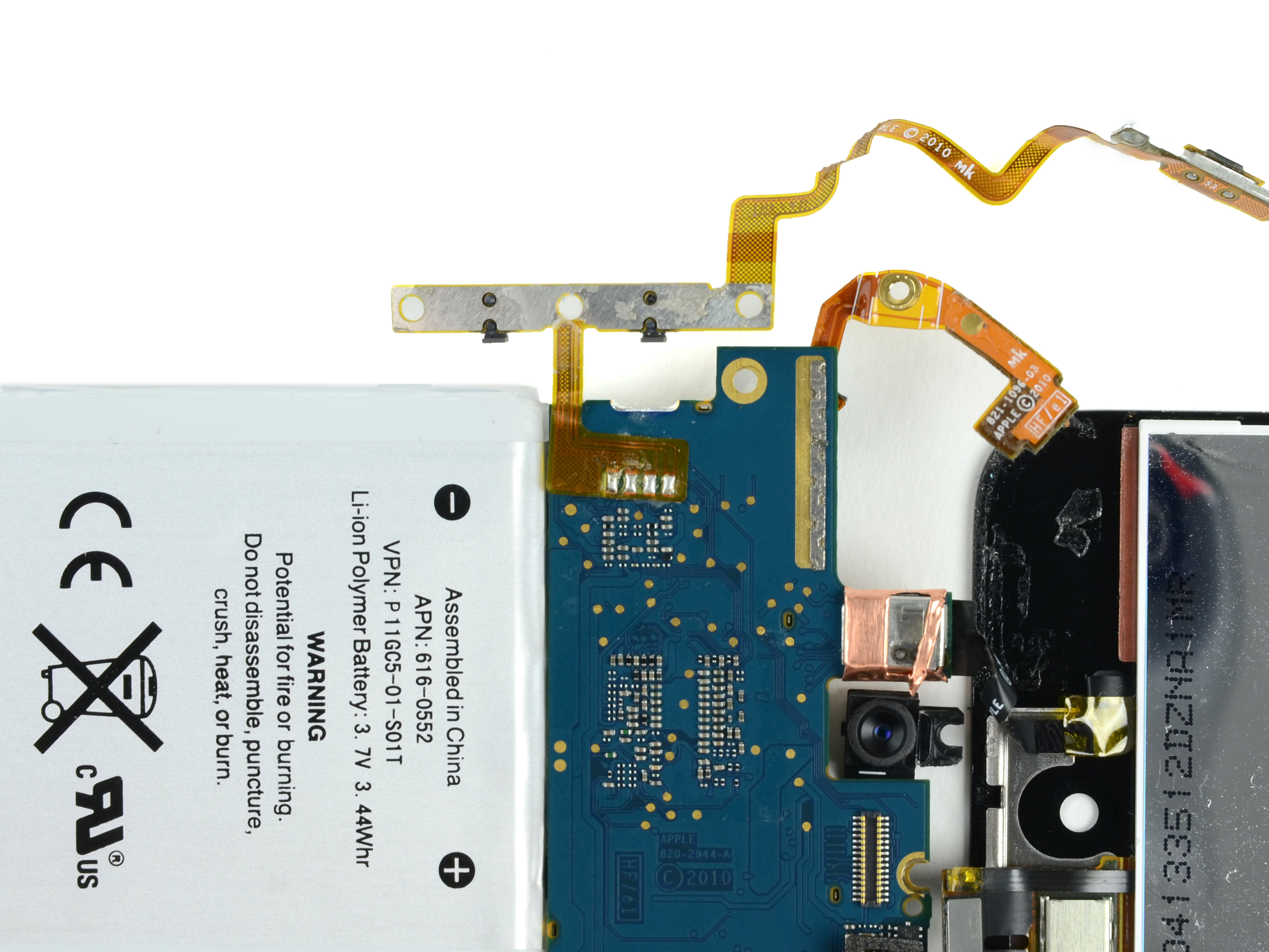

    • Flip the logic board/battery assembly over to access the ribbon cable solder joints.
    • In the next few steps, you will desolder the four volume/power button ribbon cable solder joints on the logic board.
  27. iPod Touch 4th Generation Volume/Power Button Cable Replacement: step 27, image 1 of 2 iPod Touch 4th Generation Volume/Power Button Cable Replacement: step 27, image 2 of 2
    • The volume/power button cable is attached via solder pads with small holes that go through the cable and attach to flat pads on the face of the logic board. In this step, you will heat each solder pad individually while using a metal spudger to pry it up from the logic board.
    • DO NOT bridge the connection between the solder pads both on the board and on the ribbon cable with your spudger. Shorts have the potential to ruin the logic board.
    • Beware of overheating the board and the cable. Only hold the tip of the iron against the pad long enough to let the solder melt. Excess heat buildup has the potential to ruin the logic board or melt the ribbon cable.
    • Start working from the outside of the ribbon cable. Heat the outermost solder pad while gently prying up from under the ribbon cable to free it from the board. Repeat this process for each of the three remaining pads, working from right to left.
  28. iPod Touch 4th Generation Volume/Power Button Cable Replacement: step 28, image 1 of 1
    • At this point, the cable should be free from the logic board.
    • Lift the old cable out of the Touch and set it aside.
  29. iPod Touch 4th Generation Volume/Power Button Cable Replacement: step 29, image 1 of 3 iPod Touch 4th Generation Volume/Power Button Cable Replacement: step 29, image 2 of 3 iPod Touch 4th Generation Volume/Power Button Cable Replacement: step 29, image 3 of 3
    • Place the replacement cable in place and align the far right contact with the far right solder point. Use two small strips of electrical tape to hold the cable against the solder pads.
    • Place two strips of tape over the end of the ribbon cable to both cover the two left-most solder pads and hold the contacts down against the logic board.
    • Heat the right-most contact until the solder below melts, then apply a small amount of solder to the contact, allowing it to flow through the two holes in the cable and down to the logic board.
    • Do not apply too much solder. The amount required for a proper bond is miniscule.
    • As soon as the solder has flowed into the joint, remove both the solder and the iron.
    • Repeat this process with the second solder pad.
  30. iPod Touch 4th Generation Volume/Power Button Cable Replacement: step 30, image 1 of 1
    • Remove the old tape, and place a new piece of tape to hold the cable in place, but uncover the remaining two pads. If you are satisfied with the position of the cable relative to the pads on the board, proceed. If not, de-solder the first connection and try again.
    • Solder the two remaining pads to the logic board, being mindful of overheating the cable or board.
