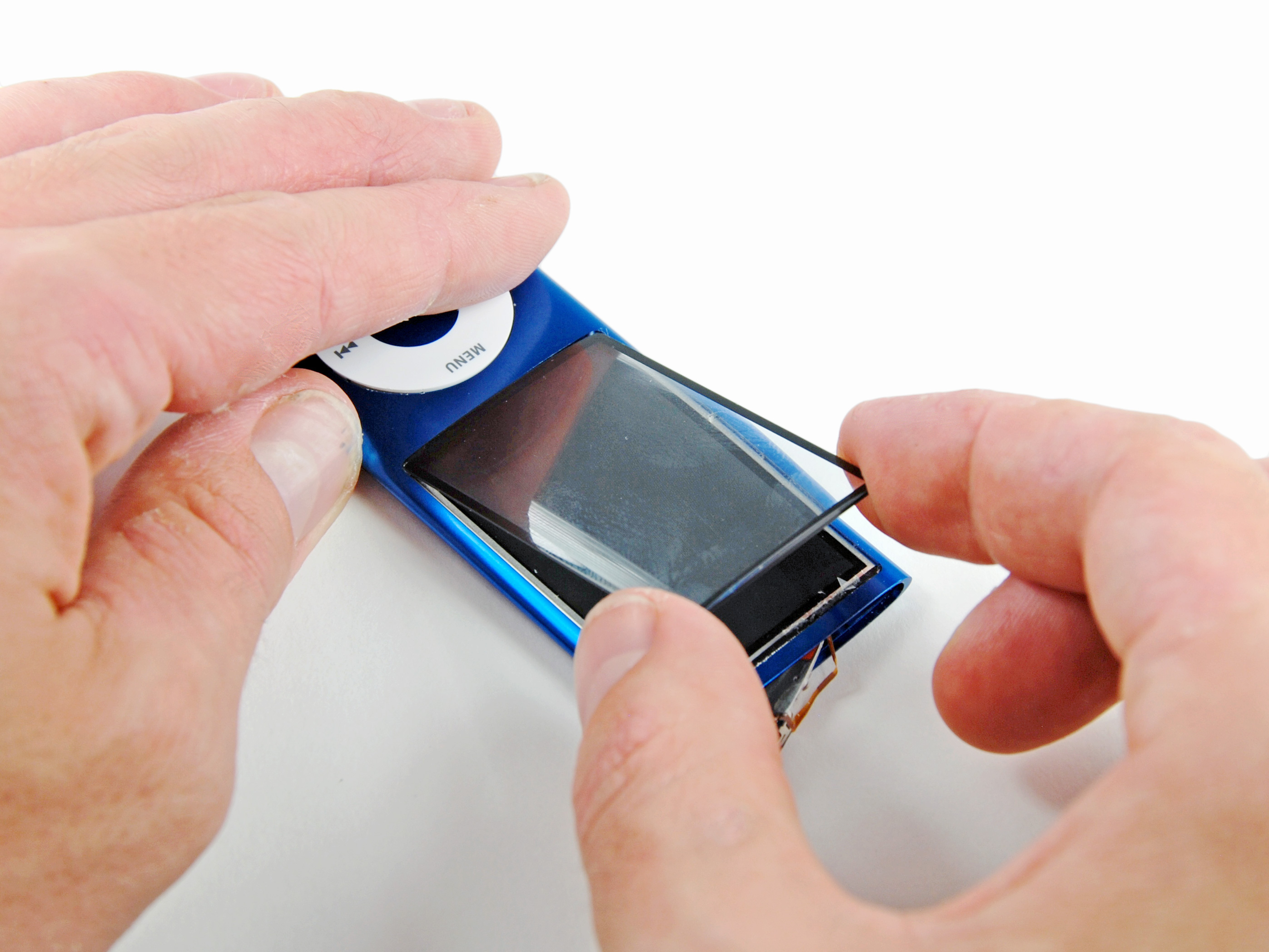

While lifting the screen up with one iPod opening tool, insert a second iPod opening tool in between the outer case and the top left edge of the glass panel.
Remove the first iPod opening tool from between the glass and LCD in the top of the device.
The iPod I repared had a cracked screen. Caution here because it doesn't pop out that easily. I had to apply some force on the plastic opening tool while using another tool to take out the shards (who are glued to the side).
Prying up slightly on the iPod opening tool, insert a second iPod opening tool in between the front glass and the outer case, on the right side of the screen.
Slide the second iPod opening tool along the right edge of the panel to remove the adhesive.
With one iPod opening tool still between the glass and outer case, insert a second iPod opening tool inbetween the front glass and outer case, on the right side.
Slide the second iPod opening tool toward the bottom of the device to remove the adhesive.
Lifting the glass from the side nearest the top of the iPod, remove the glass panel from the Nano.
