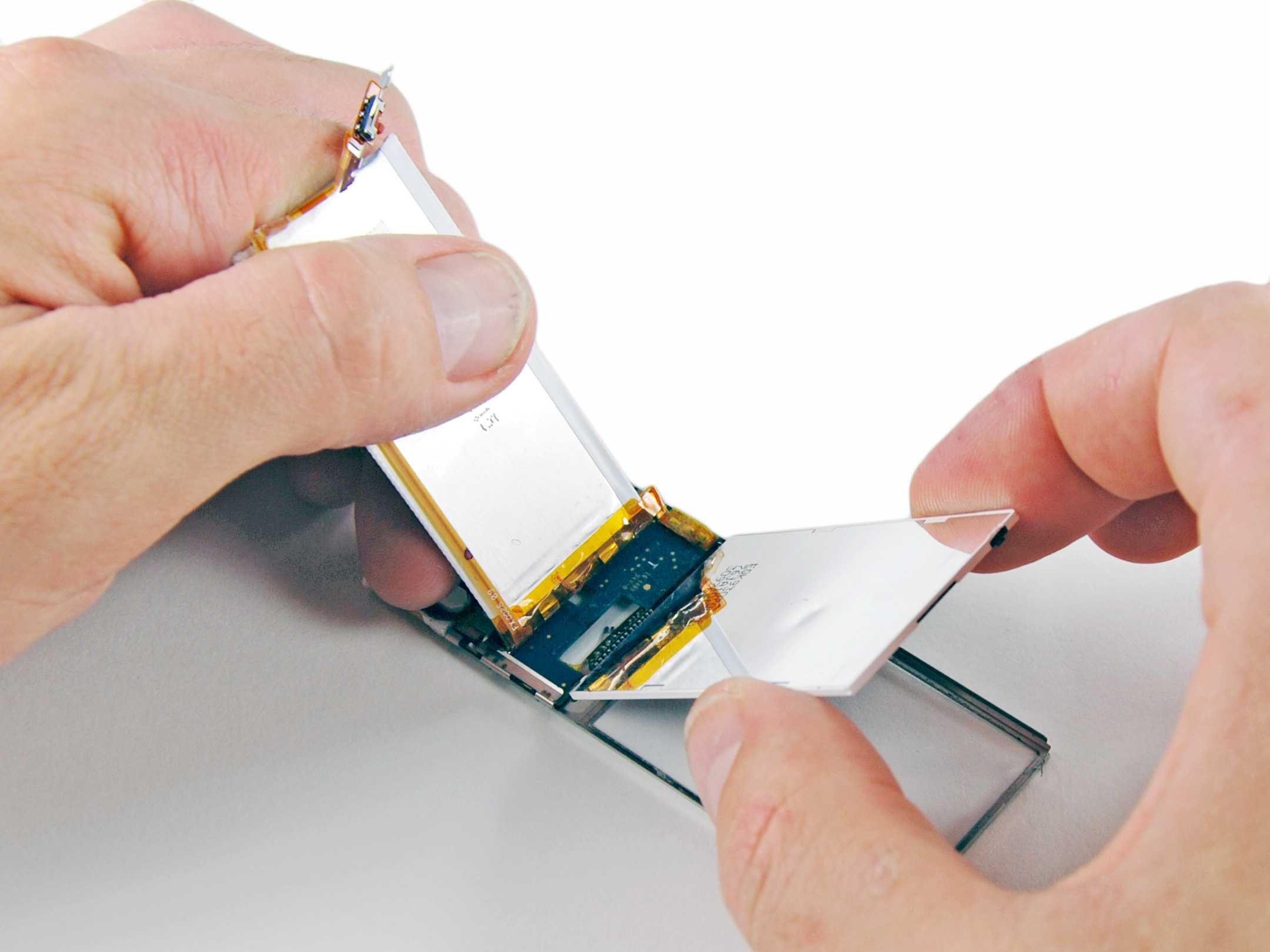

  26. iPod Nano 5th Generation Display Replacement: step 26, image 1 of 1
    • Turn the entire logic board assembly over so the display is face down.
    • Lift the battery off the back of the display.
  27. iPod Nano 5th Generation Display Replacement: step 27, image 1 of 3 iPod Nano 5th Generation Display Replacement: step 27, image 2 of 3 iPod Nano 5th Generation Display Replacement: step 27, image 3 of 3
    • Use your fingers to push the top of the display out of the metal frame.
    • Lift the top of the display out of the frame.
    • Remove the entire display.
