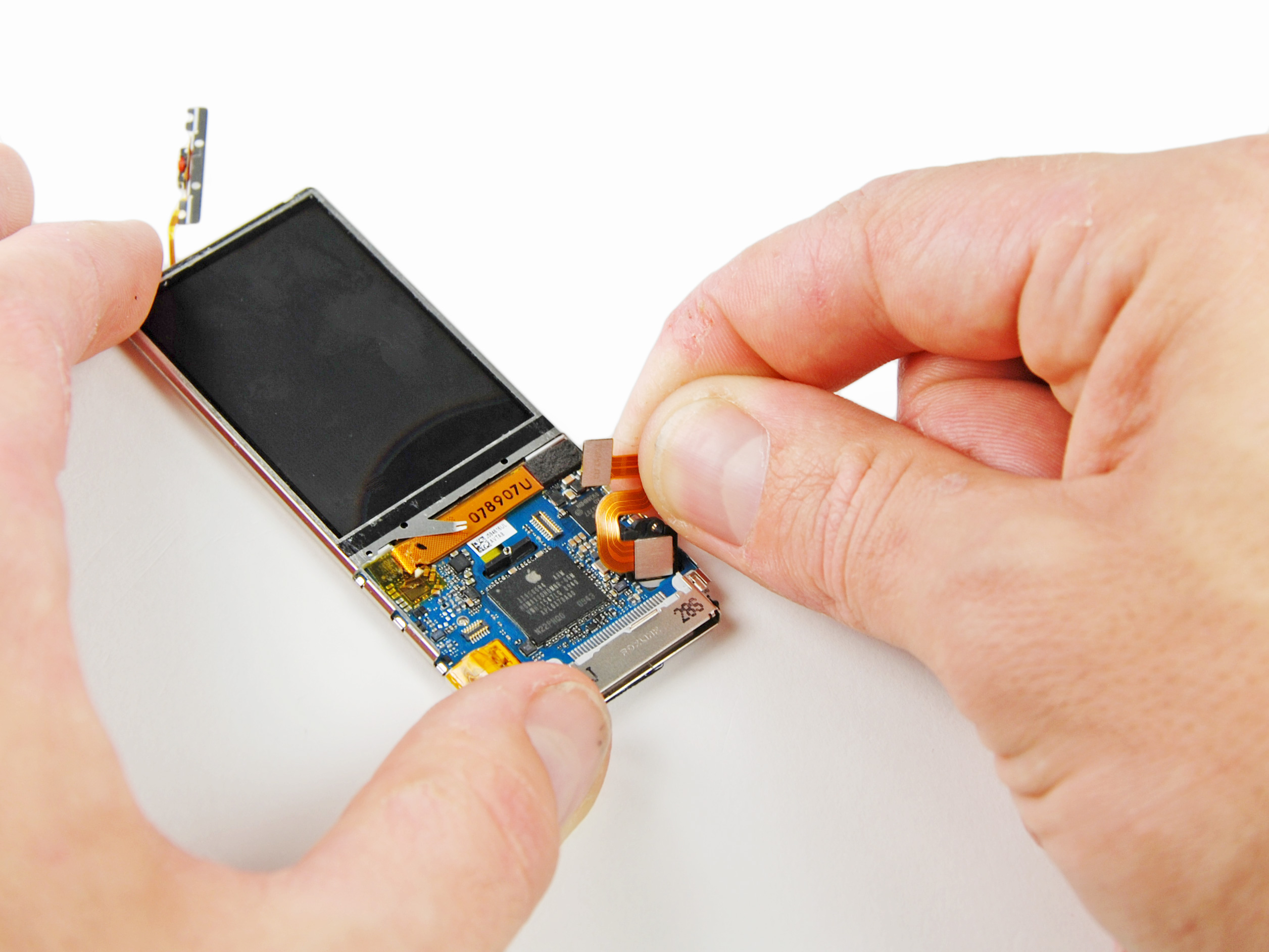

  21. iPod Nano 5th Generation Camera Replacement, Camera: step 21, image 1 of 1
    • Peel back the orange tape covering the camera ribbon cable up off the logic board.
  22. iPod Nano 5th Generation Camera Replacement: step 22, image 1 of 1
    • Use an iPod opening tool to pry the camera connector off its socket on the logic board.
  23. iPod Nano 5th Generation Camera Replacement: step 23, image 1 of 1
    • Lift and remove the camera from the logic board.
