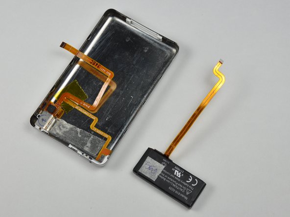

  11. iPod 5th Generation (Video) Rear Panel Replacement, Battery: step 11, image 1 of 3 iPod 5th Generation (Video) Rear Panel Replacement, Battery: step 11, image 2 of 3 iPod 5th Generation (Video) Rear Panel Replacement, Battery: step 11, image 3 of 3
    • Be careful not to damage any of the headphone or battery ribbon cables while performing this step.
    • Insert an iPod opening tool in between the metal case and battery at the location illustrated by the picture.
    • Gently wiggle the tool while pushing it further in between the battery and back case. The adhesive holding the battery should give, allowing the battery to be removed from the rear panel.

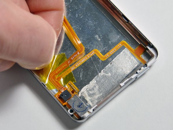

  12. iPod 5th Generation (Video) Rear Panel Replacement, Headphone Jack & Hold Switch: step 12, image 1 of 1
    • Be very careful when performing this step, since the orange ribbon cables can easily be broken.
    • Peel off the tape holding the ribbon cables in place.

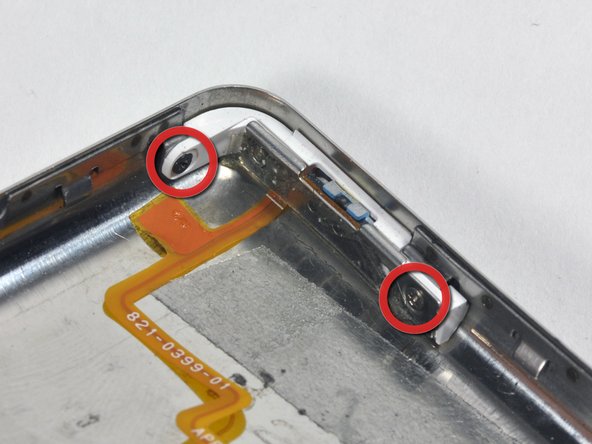

    • Remove the two black Phillips screws that are securing the headphone jack to the lower casing.

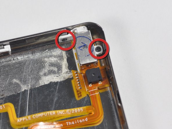

  14. iPod 5th Generation (Video) Rear Panel Replacement: step 14, image 1 of 1
    • Remove the following two screws:
    • One black Phillips screw securing the hold switch near the corner of the iPod.
    • One silver Phillips screw securing the other side of the hold switch.

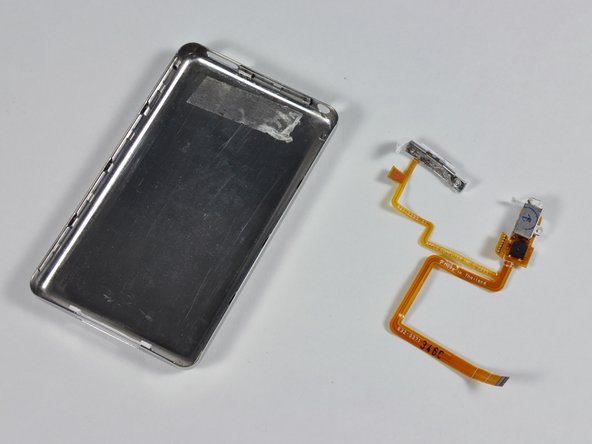

  15. iPod 5th Generation (Video) Rear Panel Replacement: step 15, image 1 of 1
    • Lift the Hold switch free of its housing on the rear panel.
    • Slide the headphone jack out of its housing on the rear panel.
    • Lift the headphone jack and hold switch assembly out of the iPod.
    • If you are removing the Hold switch and headphone jack to replace the back panel, you may stop here.

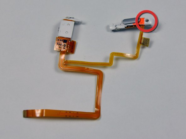

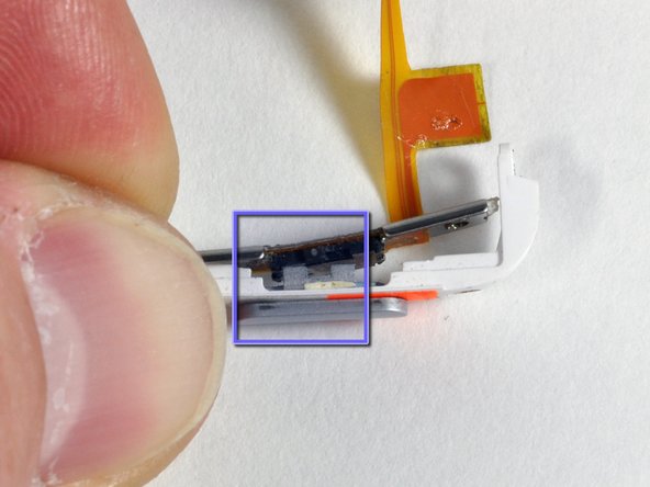

  16. iPod 5th Generation (Video) Rear Panel Replacement: step 16, image 1 of 2 iPod 5th Generation (Video) Rear Panel Replacement: step 16, image 2 of 2
    • If your replacement headphone jack includes the white plastic hold switch, simply reinstall the headphone jack. If your replacement part does not include the plastic hold switch, follow the next steps to transfer the plastic hold switch to your new headphone jack.
    • If you're just trying to remove the rear panel, you can skip Steps 15 and 16.
    • Remove the single Phillips screw nearest to the hold switch. Note: You may find adhesive holding the back of the screw in place.
    • Lift the plastic portion of the Hold switch away from the orange ribbon cable.
    • Ensure that the black notch lines up with the gray slider during reassembly of the switch (see picture 2).
  17. iPod 5th Generation (Video) Rear Panel Replacement: step 17, image 1 of 1
    • Use the small iPod opening tool to carefully peel the orange ribbon cable and attached black Hold switch up from the metal backing.
    • When re-attaching the replacement Hold switch, make sure the two small posts on the back of the switch are aligned with the two holes in the metal backing.
