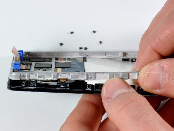

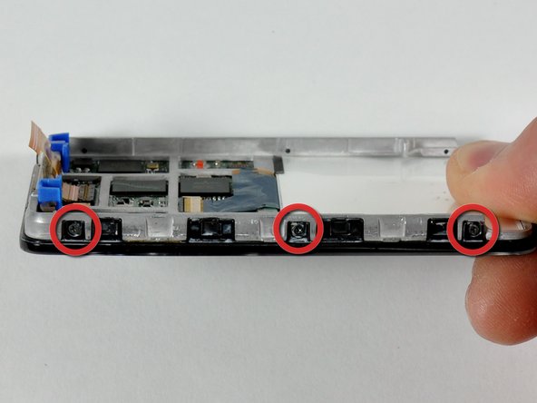

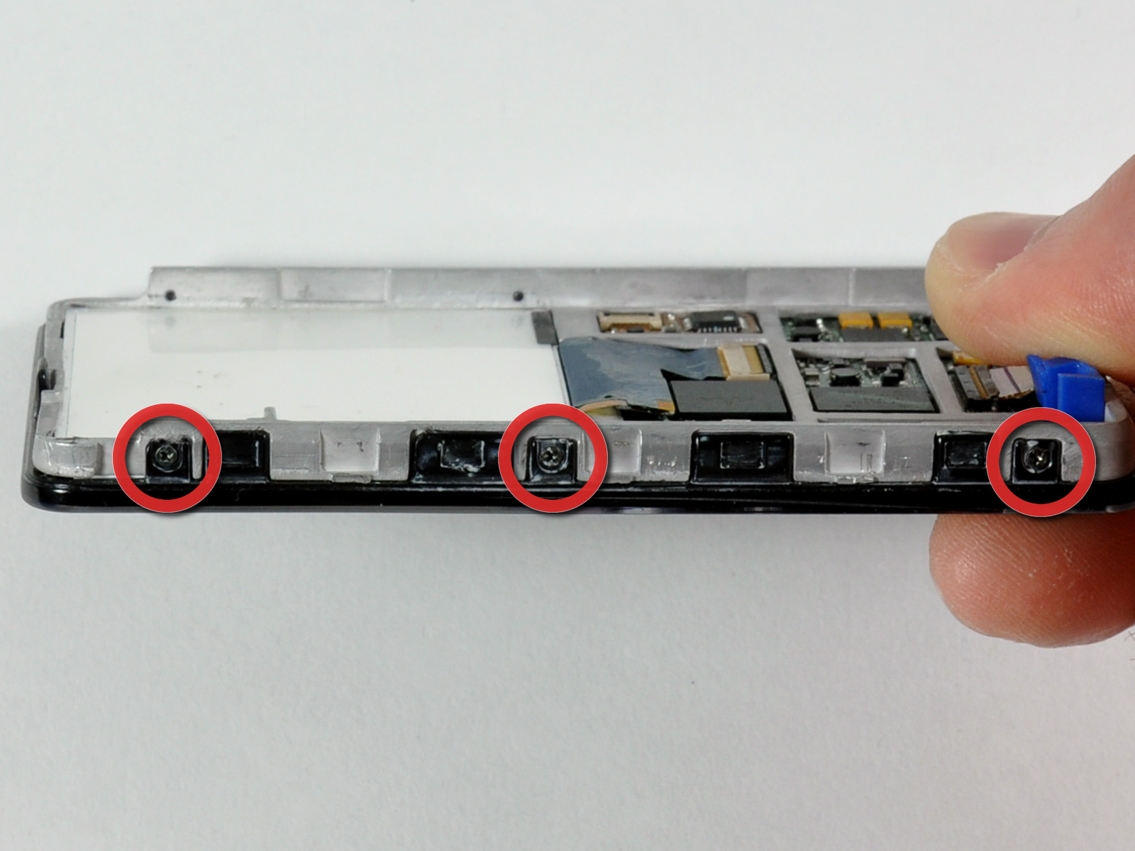

  12. iPod 5th Generation (Video) Front Panel Replacement, Front Panel: step 12, image 1 of 2 iPod 5th Generation (Video) Front Panel Replacement, Front Panel: step 12, image 2 of 2
    • Remove the three black Phillips screws securing the front panel to the metal framework.
    • Rotate the iPod laterally 180 degrees and remove the three black Phillips screws securing the front panel to the metal framework on the other side.

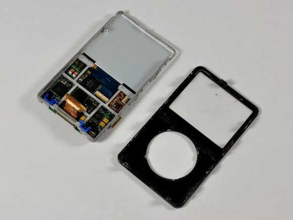

  13. iPod 5th Generation (Video) Front Panel Replacement: step 13, image 1 of 2 iPod 5th Generation (Video) Front Panel Replacement: step 13, image 2 of 2
    • You may meet some resistance near the center of the iPod as there is a mild adhesive used to help hold the two pieces together.
    • Carefully work around the edge of the iPod to separate the front panel from the metal framework.
    • Lift the framework (including the attached display, logic board, and click wheel) away from the front panel.
    • Make sure that the click wheel button is in place before reinstalling the framework in the front panel.
  14. iPod 5th Generation (Video) Front Panel Replacement: step 14, image 1 of 1
    • The front panel should now be free from the rest of the iPod.
