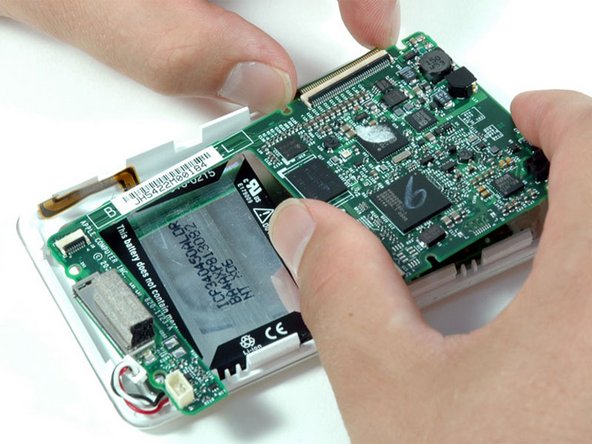

Slide the orange click wheel ribbon cable out of its connector.  You must unlock this connector before sliding the ribbon cable out. The locking mechanism is on the opposite side of where the cable is inserted - it swivels upwards 90 degrees. Use a plastic spudger to lift the locking mechanism.
  • Slide the orange click wheel ribbon cable out of its connector. You must unlock this connector before sliding the ribbon cable out. The locking mechanism is on the opposite side of where the cable is inserted - it swivels upwards 90 degrees. Use a plastic spudger to lift the locking mechanism.
Carefully lift up the large end of the logic board and disconnect the display connector.
  • Carefully lift up the large end of the logic board and disconnect the display connector.
  • Lift the logic board out of the iPod.
Lift the display panel out of the iPod. There may be some mild adhesive connecting the display to the front panel.
  • Lift the display panel out of the iPod. There may be some mild adhesive connecting the display to the front panel.
