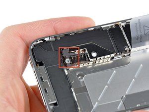

Remove the single 2.5 mm Phillips screw securing the battery connector to the logic board- for me this Phillips screw won't budge from its place have tried all the phillips combinations 000, 00, 0, 1 and the straight /slotted 1.5 mm but nothing. can some help me please purchased a replacement battery for my iPhone 4 but not able to do it just because of this screw.
Naved Zaidi - Reply
If the screw head is not buggered, press the tip of a hot soldering iron to the screw for a second or two. Don't get it too hot, or you'll damage something.
splaye -
Image 1/1: Some devices may have two screws, one of which holds down the contact pad which is located above the screw indicated in red in the photo.
  • Remove the single 2.5 mm Phillips screw securing the battery connector to the logic board.
    • Some devices may have two screws, one of which holds down the contact pad which is located above the screw indicated in red in the photo.

There is a metal bracket that secures the connector, that will be removed before the conector is unfasten
poseido - Reply
When I used a plastic opening tool to gently disconnect the battery connector from its socket, I accidently remove the socket too.. Now what? :( ......
odisseas - Reply

Image 1/1: Pry from the top and bottom of the connector bracket—there isn't as much of an overhang on the sides, and you may damage the connector.
  • Use a plastic opening tool to gently pry the battery connector up from its socket on the logic board.
    • Pry from the top and bottom of the connector bracket—there isn't as much of an overhang on the sides, and you may damage the connector.
  • Be very careful to only pry up on the battery connector and not the socket on the logic board. If you pry up on the logic board socket, you may break it entirely.
  • Remove the metal clip covering the antenna connector.
There is a small black L-shaped bracket of some sort that tits between the battery connector and the motherboard socket, with a loop on one corner that sits betwen the riserand the battery connector. Remove this now, and do not forget to re install it on assembly.
stevesontheroad - Reply
When reattaching this bracket make sure your Battery ribbon is already tucked underneath the battery with only the minimum clearance required. Then make sure the brackets overhang is over the battery ribbon. Dont try to slide it under the Ribbon.
crimney - Reply
In Step 5 be EXTRA careful with the battery connector as the socket can come off extremely easy. This can mess up the replacement a little bit and cost you extra. Otherwise, this guide is excellent.

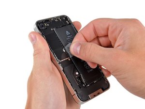

Image 1/3: You may need to use a plastic opening tool to loosen the adhesive under the battery. Image 2/3: Before reconnecting the battery connector, be sure the contact clip (shown in red) is properly positioned next to the battery connector. Image 3/3: Before reassembly, clean metal-to-metal contact points with a de-greaser such as windex. The oils from your fingers have the potential to cause wireless interference issues.
  • Use the clear plastic pull tab to gently lift the battery out of the iPhone.
  • You may need to use a plastic opening tool to loosen the adhesive under the battery.
  • Before reconnecting the battery connector, be sure the contact clip (shown in red) is properly positioned next to the battery connector.
  • Before reassembly, clean metal-to-metal contact points with a de-greaser such as windex. The oils from your fingers have the potential to cause wireless interference issues.
  • Perform a hard reset after reassembly. This can prevent several issues and simplify troubleshooting.
Just be careful when removing the battery with the plastic pull tab. On some units, they use so much glue that it's virtually impossible to take the battery.
In such an instance, you could use the iPod opening tool to assist (just be careful where you stick it!)
klubn - Reply
use the iPod opening tool to pry gently under the battery from the outer edge of the phone and work towards the plastic tab. the tab is not actually attached to the battery itself, but a plastic sheet between the battery and inner frame. the adhesive on the battery tends to be under the edge of the battery nearest the center of the phone.
David Iwanicki - Reply
Understand that the plastic pull tab is part of the phone. It sits under the battery like a tray and is not connected to the battery so it needs to stay in tact.
mattcfi - Reply

My battery was so firmly glued in, it took a long time to slowly pry it loose. Patience is the key to this process. I could see easily damaging the circuit board by using too much force. The plastic tab did not help at all.
The ribbon cable attaching the new battery to the battery connector clip is longer than the original. I clicked the clip into the socket first and then was very careful to fold the excess while putting the battery back in so the ribbon cable didn't kink. One kink in this could sever the battery leads.
drathbun - Reply
My ribbon cable was also longer than the original. How did you get it to not kink while placing the batter back into the phone? That seems to be my only hang up at the moment
cvbaseballsean22 -
Piece of cake! The hardest part was being sure the outer pentalobe screws were actually turning and I wasn't stripping them. Battery was glued firmly in, so I loosened it from the outside instead of using the plastic pull-tab. I pre-bent the battery connector neck before putting it back in and had no problems with it fitting in. Getting the battery connector aligned with the antenna piece underneath was a bit fiddly. Got the case back on, put in the new screws, and powered the phone on without problem. Had 40% charge, all seems well. Yippee!
chezbuttons - Reply
Do NOT use a spudger or similar type of prising tool to try lift up the battery. Instead, just warm up the whole area with a hot air gun or hair drier to soften the glue.
The reason why I say don't use an implement to try lift the battery is because far too many times I've seen punctured & bent batteries come in to this workshop that have to be thrown out for safety reasons. It only takes a grain of sand, or a burr on the spudger and you're risking a potential cell rupture and potential fire.
Just use a bit of heat ( not a lot! ) to soften up the glue and it'll come away with the plastic pull tab.

yep me too... removing the battery isnt nessecary.
thx for this helpfull guide!! was a peace of cake
Frank -
I agree with marclaudi. you can go from page 1 to page 3 since the battery can stay in the phone and still be able to remove the motor
Andreas Nicolaou - Reply
Easy breezy!! Don't need to remove battery! Just turn the phone off first. Took about 5 mins.
Jason White - Reply
Very helpful! Replaced mine in under 5 min without removing the battery. Thanks!
aka - Reply
