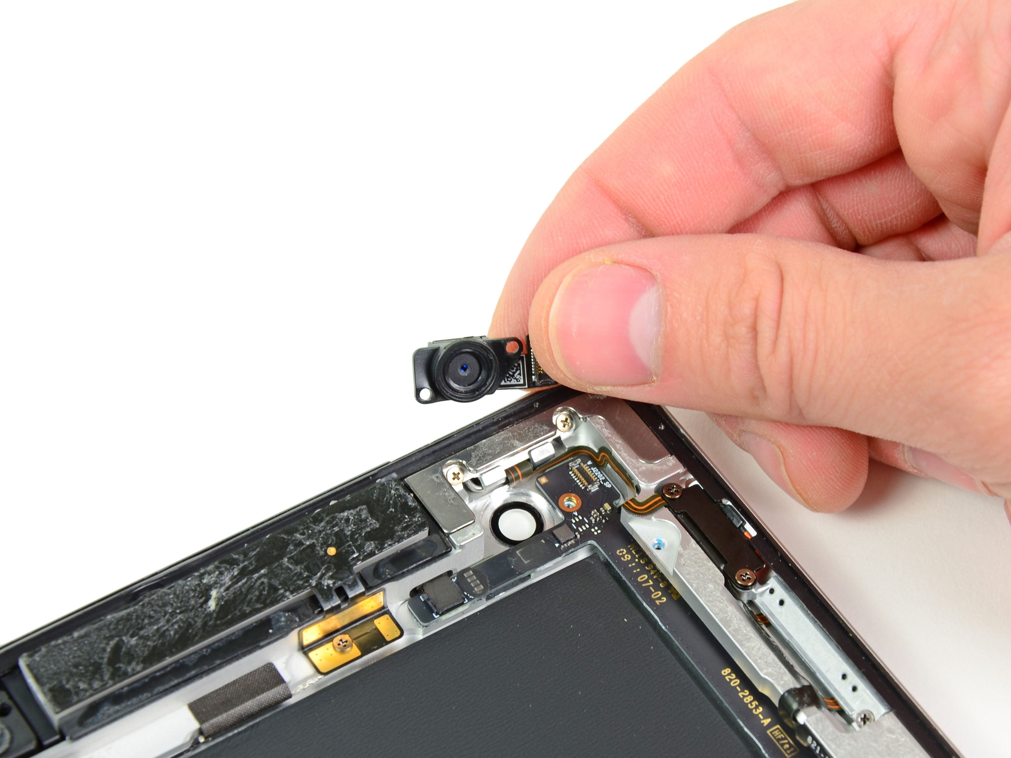

  30. iPad 2 CDMA Rear Facing Camera Replacement, Rear Camera: step 30, image 1 of 1
    • Carefully peel the rubber cover off the metal camera retainer and remove it from the iPad 2.
  31. iPad 2 CDMA Rear Facing Camera Replacement: step 31, image 1 of 3 iPad 2 CDMA Rear Facing Camera Replacement: step 31, image 2 of 3 iPad 2 CDMA Rear Facing Camera Replacement: step 31, image 3 of 3
    • Remove the following two screws:
    • One 3.3 mm Phillips screw
    • One 2.1 mm Phillips screw
    • Lift the metal retainer clip straight up from its recess in the rear panel.
    • If the camera comes up with the retaining clip, don't worry. Just separate the camera from the clip before reinstalling, so you can be sure to get the connector in the right place.
    • Be sure the small thermal pad is attached to the metal retaining clip as seen in the third picture when replacing the rear camera.
  32. iPad 2 CDMA Rear Facing Camera Replacement: step 32, image 1 of 2 iPad 2 CDMA Rear Facing Camera Replacement: step 32, image 2 of 2
    • Use a plastic opening tool to pry the rear camera connector up from its socket on the upper component board.
    • Remove the rear camera.
To reassemble your device, follow these directions in reverse and use our iPad 2 CDMA Front Panel Adhesive strip guide to reattach the front panel.
